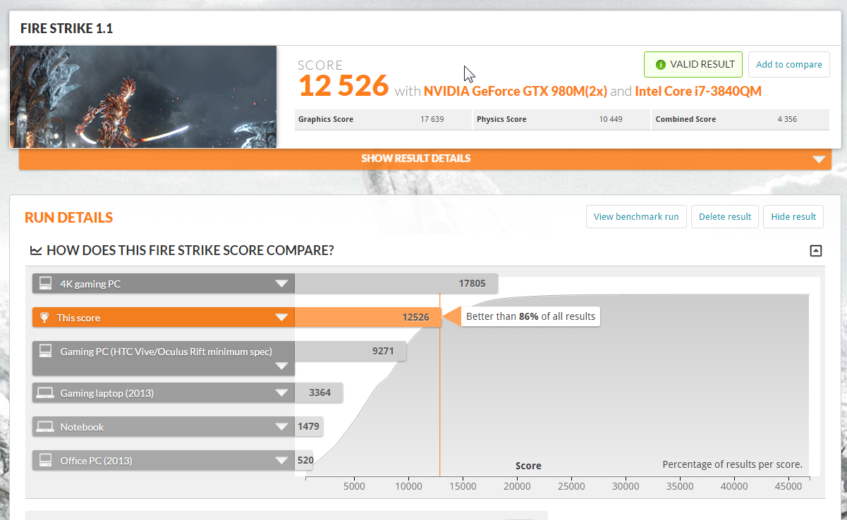

kkthebeast Posted July 25, 2016 Share Posted July 25, 2016 (edited) Firestrike on 980m SLI with Prema vBios v2 Throttling on stock clocks http://www.3dmark.com/3dm/13608329? Edited July 25, 2016 by kkthebeast Update Image Quote Link to comment Share on other sites More sharing options...
