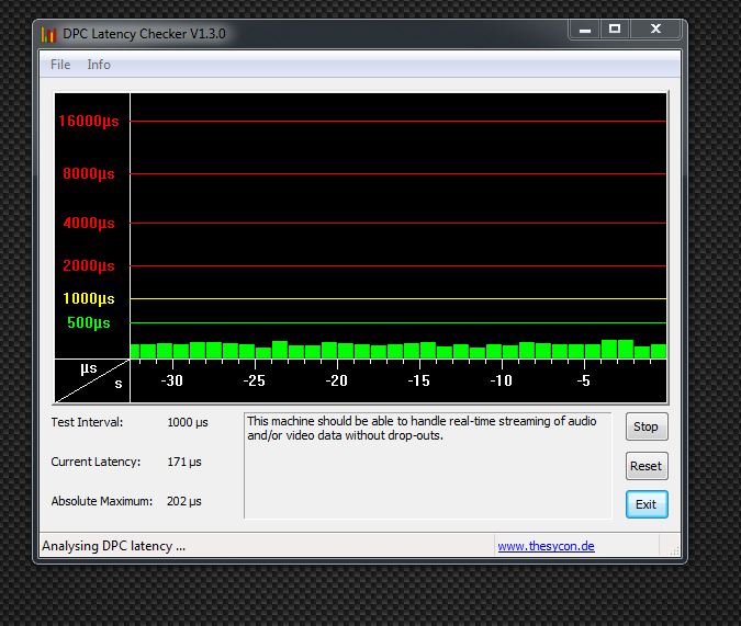

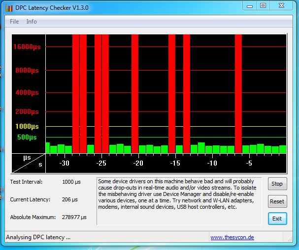

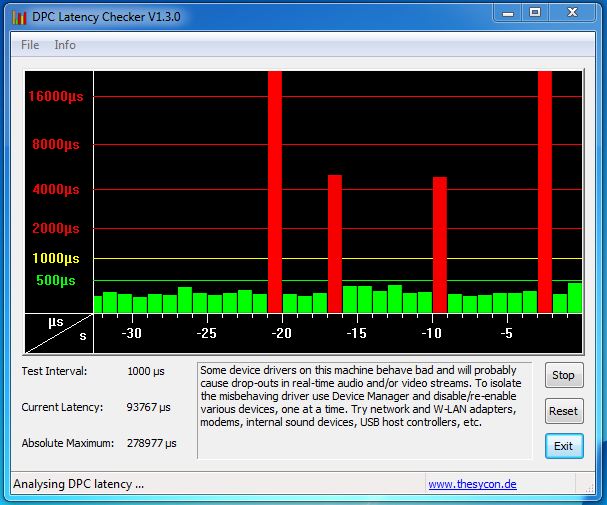

iloveb00bs Posted August 27, 2011 Share Posted August 27, 2011 hey guys, i need people with killer wifi card to check their latency. you can download the tool here:DPC Latency Checker here is a few examples of my latency with the Dell Killer Wifi Driver: Link to comment Share on other sites More sharing options...

iloveb00bs Posted August 28, 2011 Author Share Posted August 28, 2011 yeah thats with the clean install, install the killer driver and bam!!! crazy spikes!!! uninstall and back to normal. so i downloaded the latest driver directly from bigfoot and its much better now only spiking to 2k every now and then. so stay away from the official dell version. 1 Link to comment Share on other sites More sharing options...

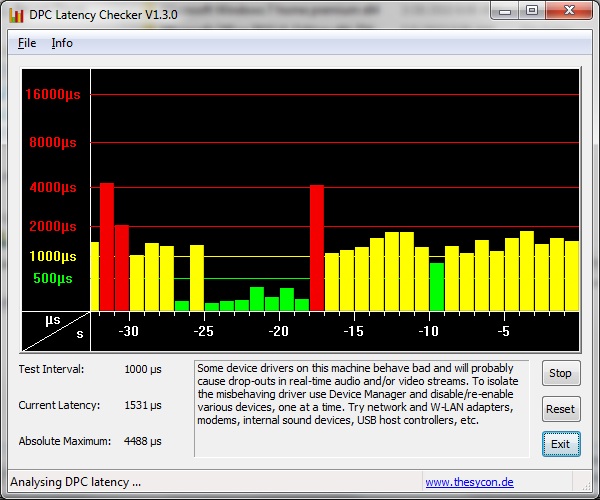

Founder Michael Posted August 30, 2011 Founder Share Posted August 30, 2011 Ok, installed the Killer Wireless-N 1103 and i am seeing the same behavior - DPC latency spikes up to 4000 micro seconds with a driver from bigfootnetworks site, haven't even bothered trying the one from Dell. Here's a screenshot: No one reviewed the card yet as far as i know. I think we should do it. boobs, which router have you got ? 1 Link to comment Share on other sites More sharing options...
Founder Michael Posted August 30, 2011 Founder Share Posted August 30, 2011 Seems like BigFoot is aware of this issue for more than a year and still it wasn't fixed.I'>DPC Latency think we should do some more testing and start reporting it to their forums as well, hopefully it'll get the needed attention and a fix will be released. Link to comment Share on other sites More sharing options...

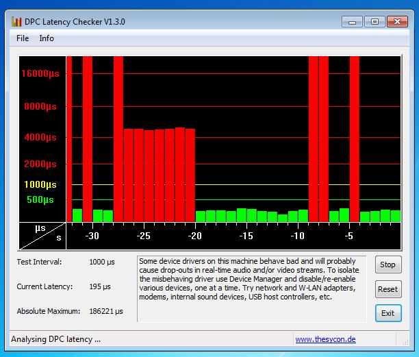

debaucher Posted September 3, 2011 Share Posted September 3, 2011 (edited) OK, I just checked my latency using the dell 1103 drivers.I ran it while having both ethernet and wireless going as well as just wireless.Everything is green across the board (all around ~100 microseconds) unless I right-click on my wireless/network icon in the task bar to bring up available networks in my area.If I do that, I get a large spike around 5000-7500 microseconds.This happens with ethernet and wireless going, just wireless going but not when wireless is off (so the latency happens when the wireless card is searching for local access points).This is really the only time I get any red spikes.For example, if I turn off wireless.. I get a spike just above 1000 microseconds, but when I turn it back on (and it connects/looks at access points) it hits over 5000 microseconds (red).So, at this point there is really no reason for me to worry about changing drivers as I will only notice a latency spike when it tries to connect to a wireless network (or scan them) but does not happen while it is actually connected (unless it scans available access points when I right click the network icon to make it do so).This could be a problem if I had a poor wireless connection (at home or travel) but since I have a good signal at home and keep in wired most of the time.. this is fine for me.So, my question would be.... what is your 1103 doing when you get the spikes?Is it trying to locate/connect to an access point, is it sending out pings, etc.....D. Edited September 3, 2011 by debaucher Link to comment Share on other sites More sharing options...
iloveb00bs Posted September 3, 2011 Author Share Posted September 3, 2011 thanks for the info debaucher. for me the second i install the driver, i would get lag spike right away, even before right clicking anything. maybe i have something else that conflicting with the dell driver, maybe the wireless hd? i have to do farther testing then, since my lag spikes were into 200-300k range. holy hell!!!kinda hesitant to do more trouble shooting since i got it fixed atm. Link to comment Share on other sites More sharing options...
