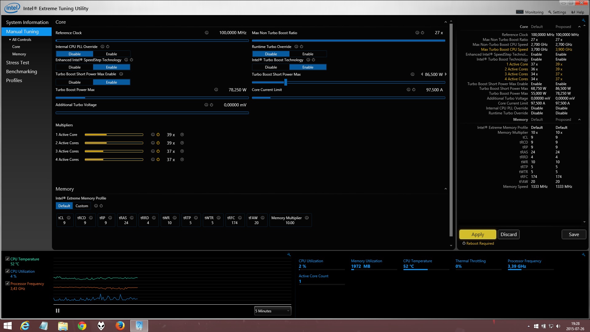

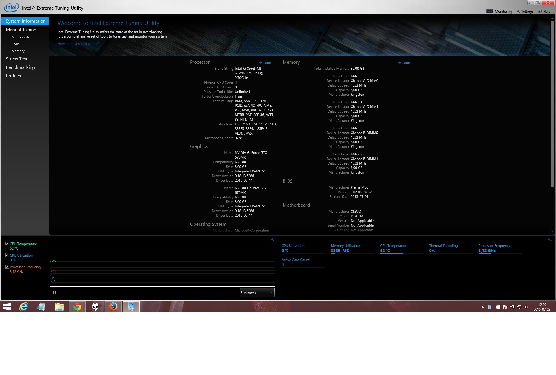

That's first XTU window with configuration:

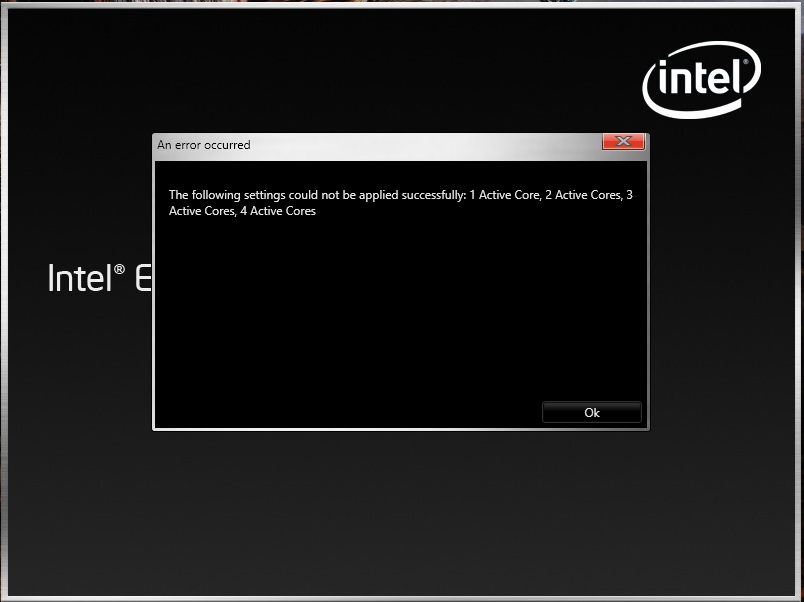

After I make some changes in multipliers and/or additional turbo voltage together with higher both Power Max is needed restart. When W8 loads again XTU shows error that multipliers and voltage could not be applied.
Tell me which option should I change exactly sow we can check if I was doing everything right.

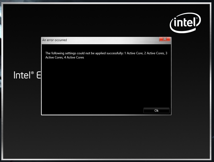

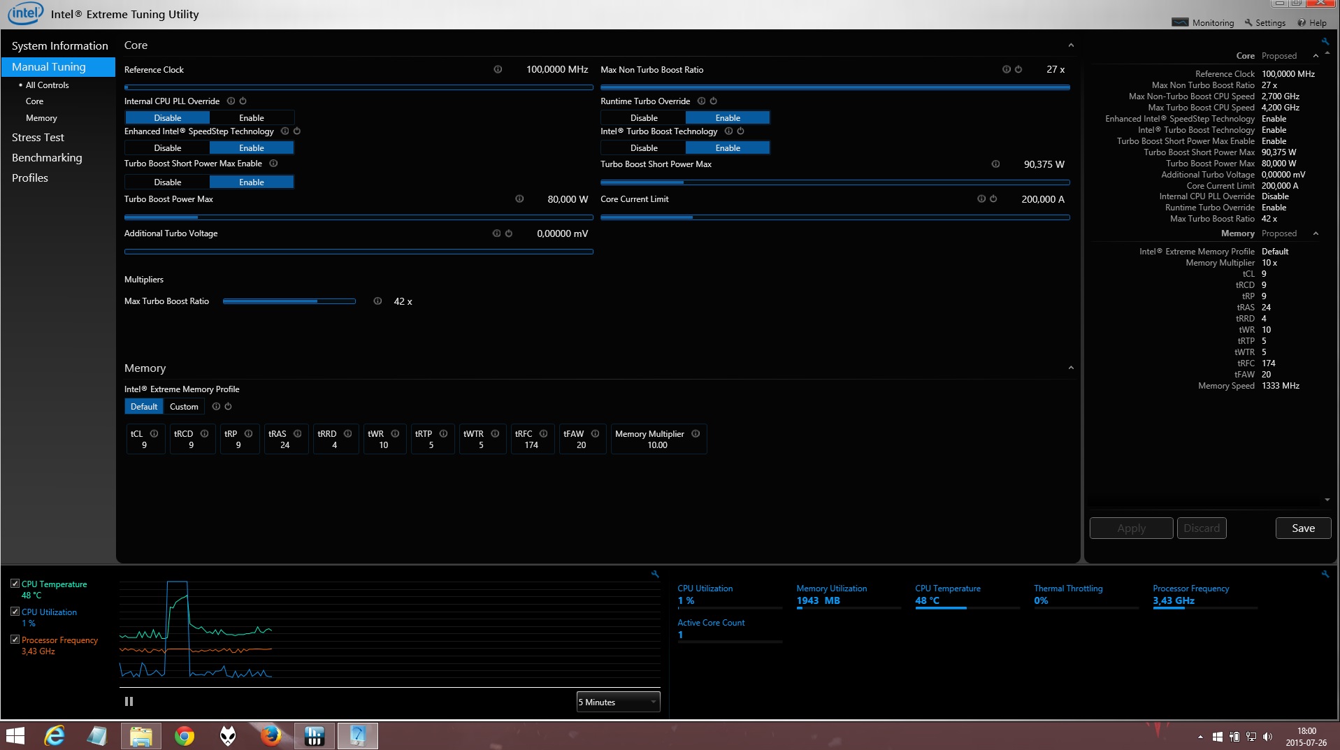

EDIT: This is ss of an error I get when I try to change multipliers just +1 (TDP raised in XTU):
Enable "Runtime Turbo Override" and hit "Apply". Only now set the Core Multi.
Nothing changed, still the same :(

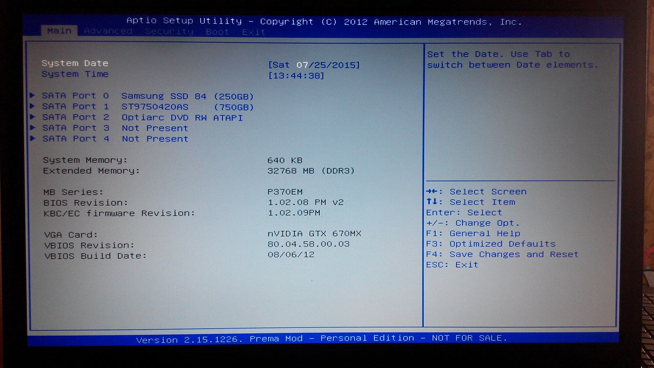

This is my BIOS. I think it is correct one but to be sure here it is:

what options are available in advanced in the bios? I have a clevo p570wm and is my first entry into the Clevo world, if I can help I would be glad to. XTU didn't like to work on my 4960x in my p570wm but the bios variables for the multiplier worked for me. The only thing that worked in XTU on my P570wm was XMP memory profiles. I later realized i could see what the xmp loaded by setting xmp then setting to manual timings would show me what my xmp loaded. So i never ended up needing use of XTU for anything beside the actual XTU benchmark once I got used to @Prema 's most amazing unlocked bios.
Bios for Clevo P370EM don't have many options. There is nothing about CPU etc. you have to do everything in XTU. @Prema send me special bios and I will try it later today - thank you for your great work @Prema!!

Sadly still nothing... Special @Prema bios flashed and XTU configurated like this:
Is this normal that after I enable some options in XTU when laptop restarts after the GPU posts and before @Prema logo computer shut downs? I had it from the beggining, It's like bios crashes?
Maybe I should do clean flash of bios with EC or something I do not know.... Some suggestions?

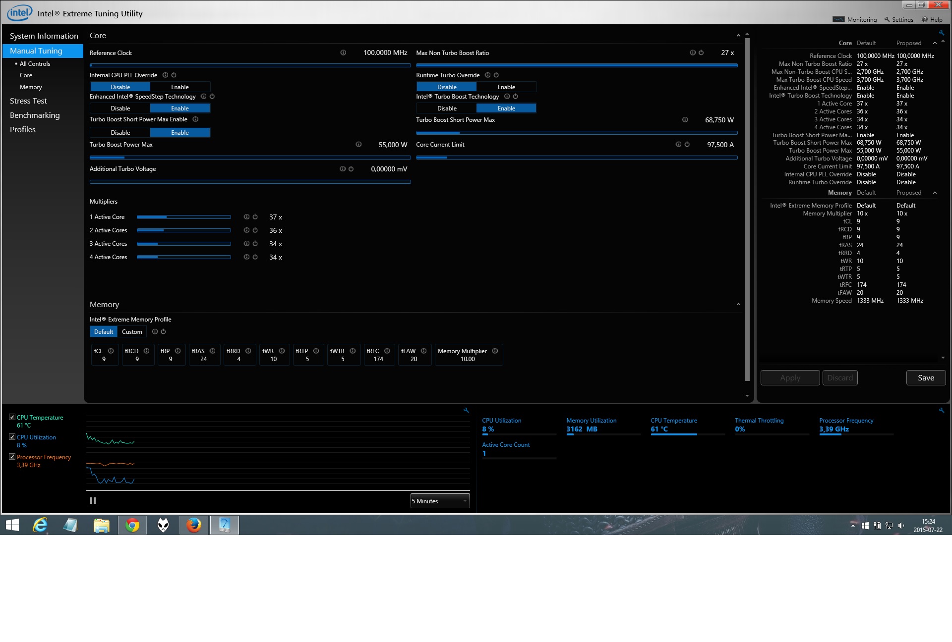

EDIT: Rising TDP works - "CPU Package Power" is around 85W when I run prime95 torture test. But speed is still limited so WTF?
If you get a full shutdown before the system finally boots then your XTU OC failed.
Leave runtime turbo disabled and set something like 39-39-37-37
XTU configured like this:
Full restart with no problems but when W8 turn on XTU shows error:

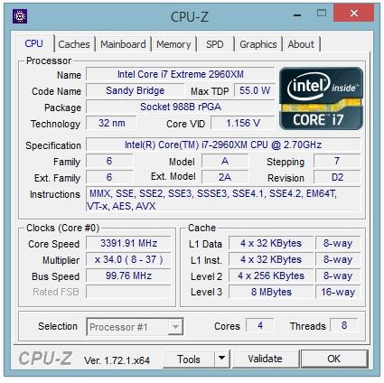

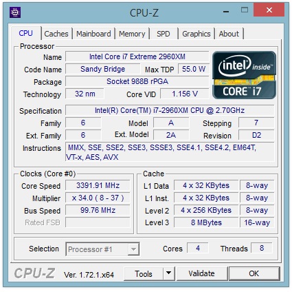

EDIT: And CPU-Z just to see what we dealing with:
