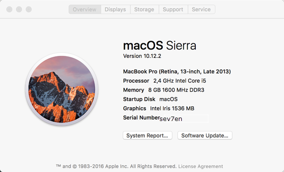

and my system:
post-2931-0-61282000-1483803683_thumb.pn

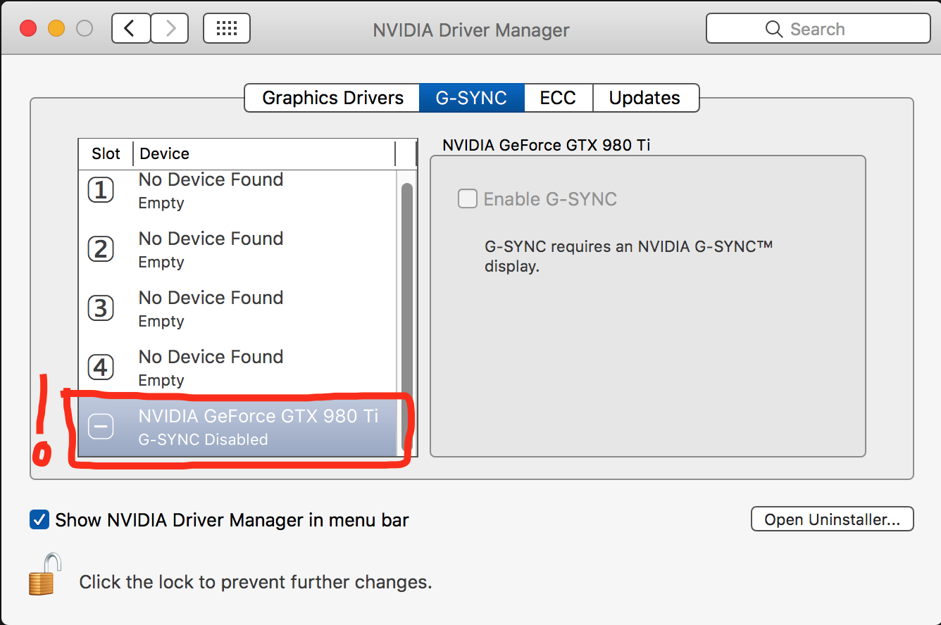

@shirazigs
I'm still on El Capitan myself but I believe that the "G-SYNC requires an NVidia G-SYNC(TM) display" explains it. Either you don't have a G-SYNC certified external monitor or the driver thinks you don't. I have a G-SYNC certified monitor myself so this is a very interesting topic for me too. However, macOS might first have to be updated to fully support G-SYNC (or free-sync, for that matter). Experimental support is also indicated by this thread on insanelymac.com. Sadly, it rather seems not to work for now :(.
I made my decision. I'm going to downgrade my Sierra to El Capitan. (I hate you, Sierra!) :pirate:

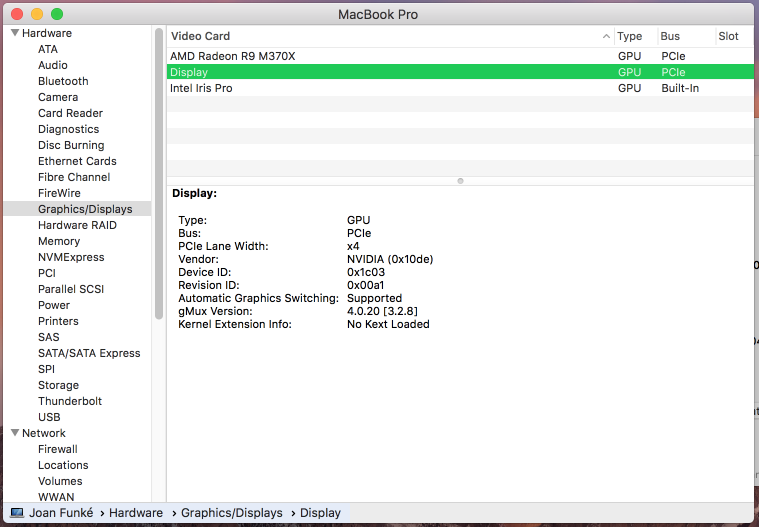

how did you get amd discrete graphics work with your egpu? (i saw your signature at the end with it XD)
Edited by pokerman837

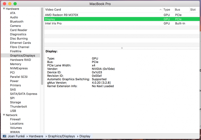

i'm trying to use a 1060 but it doesn't recognize the model, it just says display.
 does it have to do with the amd discrete graphics?
