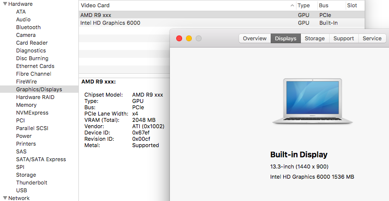

Either I've missed a step or Sierra has a strong preference for 4GB RX 460s over 2GB RX 460s.
MacOS recognizes that the card is present but so far refuses to actually use it.

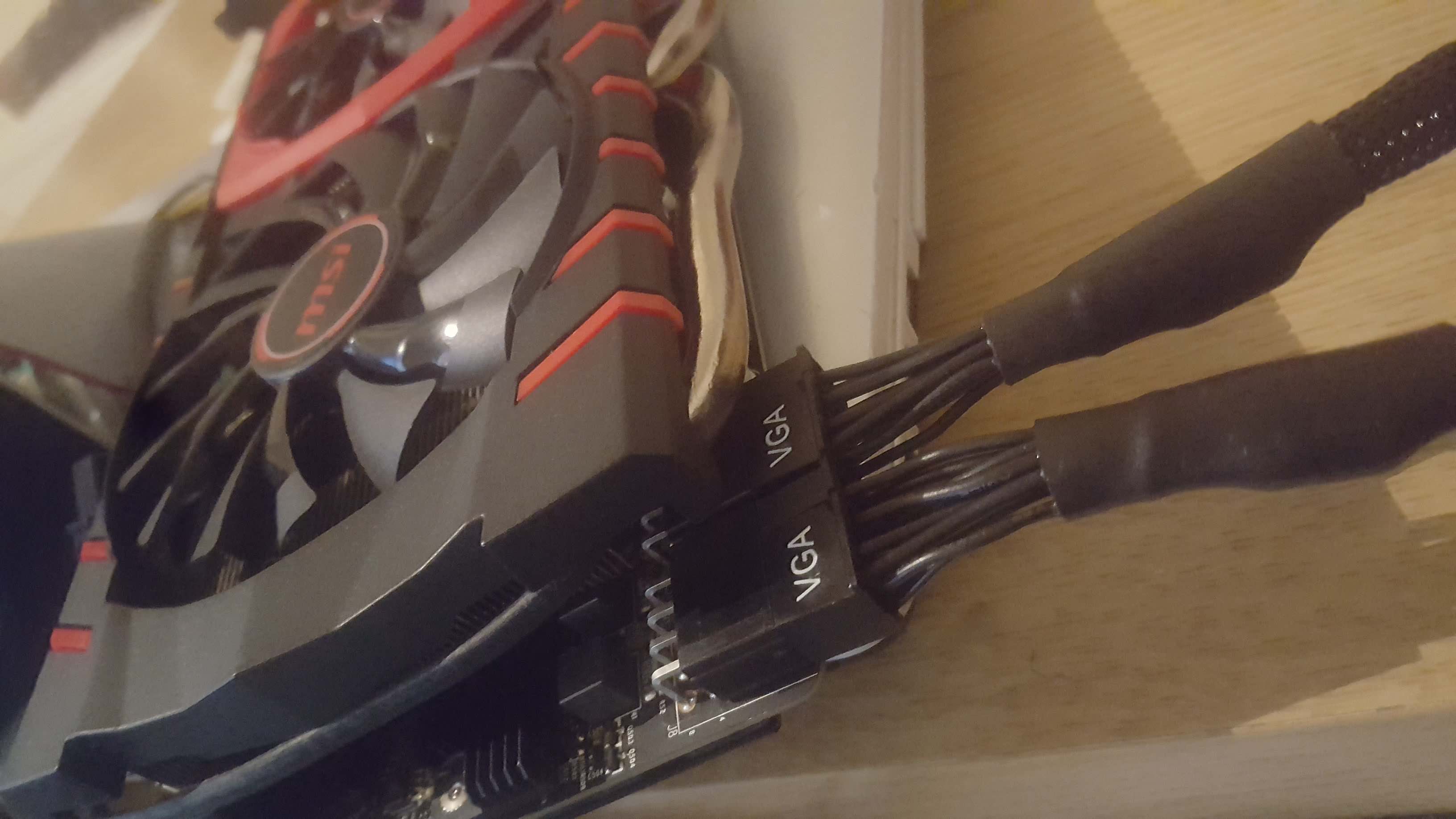

You have all 14 pins on the 980Ti connected to the PSU, yes?
There are two 8 pin connections on this model. I plug them both into the psu. See attached
I tried plugging the 980 ti directlyl into the Aikitio board (i took it out). I used a molex to barrel adapter. Again, everyting turns on with lights and fans but i still get the error.
