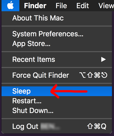

shirazigs Posted April 20, 2016 Share Posted April 20, 2016 Hello my friends! Just wanted to share my quick solution to adjust back the resolution of your first display. Simply just click on Sleep and then click on your mouse. Quote Link to comment Share on other sites More sharing options...

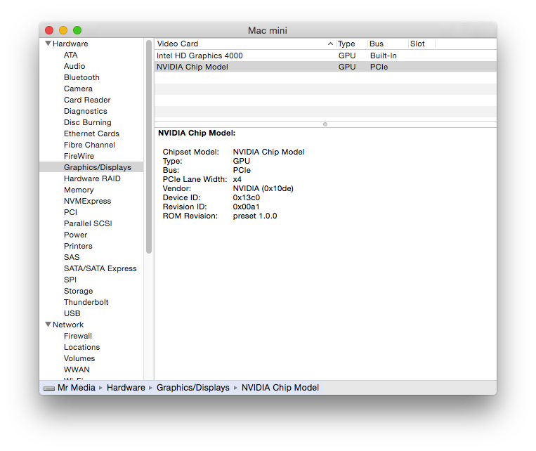

pixxelpusher Posted May 21, 2016 Share Posted May 21, 2016 (edited) Hi I still can't get this script to work. Can someone help me with it? I am now running the Akitio case using a Silverstone 450W psu, and have a EVGA GTX 980 SC video card in it. I have it plugged into my Mac Mini (OS X 10.10.3) and ran the script but when I restart my mini crashes and goes into an infinite loop of loading / crash. When I plug the eGPU in after the Mini has loaded I can go into the System Report / Display's and it show's the card is found, but just as a general card. For some reason I don't think the script is installing anything. I have attached the readout from Terminal when I installed: mrmedia:~ mrmedia$ curl -o ~/Desktop/automate-eGPU.sh https://raw.githubusercontent.com/goalque/automate-eGPU/master/automate-eGPU.sh % Total % Received % Xferd Average Speed Time Time Time Current Dload Upload Total Spent Left Speed 100 37925 100 37925 0 0 13262 0 0:00:02 0:00:02 --:--:-- 13260 mrmedia:~ mrmedia$ chmod +x ~/Desktop/automate-eGPU.sh mrmedia:~ mrmedia$ cd ~/Desktop mrmedia:Desktop mrmedia$ sudo ./automate-eGPU.sh Password: *** automate-eGPU.sh v0.9.8 - (c) 2015 by Goalque *** ------------------------------------------------------- Detected eGPU GM204 [GeForce GTX 980] Current OS X 10.10.3 14D136 Previous OS X [not found] Latest installed Nvidia web driver Version: 346.01.02f04 Source: 3rd Party Install Date: 3/18/16, 2:59 PM You are running official Nvidia driver. Checking IOPCITunnelCompatible keys... Missing IOPCITunnelCompatible keys. Mac board-id not found. Searching for matching driver... Driver [346.01.02f04] found from:http://us.download.nvidia.com/Mac/Quadro_Certified/346.01.02f04/WebDriver-346.01.02f04.pkg Do you want to download this driver (y/n)? y % Total % Received % Xferd Average Speed Time Time Time Current Dload Upload Total Spent Left Speed 100 48.0M 100 48.0M 0 0 1229k 0 0:00:40 0:00:40 --:--:-- 1253k Driver downloaded. Removing validation checks... Modified package ready. Do you want to install (y/n)? y installer: Package name is NVIDIA Web Driver 346.01.02f04 installer: Upgrading at base path / installer: The upgrade failed (The Installer encountered an error that caused the installation to fail. Contact the software manufacturer for assistance.) Checking IOPCITunnelCompatible keys... Missing IOPCITunnelCompatible keys. IOPCITunnelCompatible mods done. Board-id added. All ready. Please restart the Mac. mrmedia:Desktop mrmedia$ Edited May 21, 2016 by pixxelpusher Quote Link to comment Share on other sites More sharing options...
euqlaog Posted May 21, 2016 Author Share Posted May 21, 2016 @Rootes The script does not support HDMI audio. @pixxelpusher Better stick to latest OS X versions. Nvidia offers only beta drivers for Maxwell cards and infinite loops are not surprise. Apple’s security update 14F1021 is a good example of what you described. I don’t know about 10.10.3 14D136 but could be the the reason. Another common reason is manually edited kexts. By the way, GTX 780 still beats GTX 980 in OpenGL (Valley benchmark) due to Nvidia’s optimizations for Kepler architecture. If your purpose is gaming on OS X, Maxwell cards won’t give you any boost. Quote Link to comment Share on other sites More sharing options...
pixxelpusher Posted May 22, 2016 Share Posted May 22, 2016 (edited) @goalque Thanks for the reply. So what OS X should I be running with your script? No I have never manually edited any kexts, wouldn't know how. I just followed your steps on the first page. Can you look at the Terminal info I posted, is there anything there you can see causing the error? Any other code you can give me to get it working? Thanks. Edited May 22, 2016 by pixxelpusher Quote Link to comment Share on other sites More sharing options...
euqlaog Posted May 22, 2016 Author Share Posted May 22, 2016 (edited) 1 hour ago, pixxelpusher said: @goalque Thanks for the reply. So what OS X should I be running with your script? No I have never manually edited any kexts, wouldn't know how. I just followed your steps on the first page. Can you look at the Terminal info I posted, is there anything there you can see causing the error? Any other code you can give me to get it working? Thanks. Yes, there is an error message: installer: The upgrade failed (The Installer encountered an error that caused the installation to fail. Contact the software manufacturer for assistance.) I’ve never seen this. Nvidia web driver installer failed for some reason. Try sudo ./automate-eGPU.sh -uninstall, restart the Mac and run again sudo ./automate-eGPU.sh If still the same, update to the latest OS X Yosemite version which is 10.10.5 (14F1808). Edited May 22, 2016 by goalque Quote Link to comment Share on other sites More sharing options...
