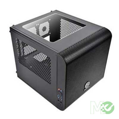

shirazigs Posted April 10, 2016 Share Posted April 10, 2016 (edited) 54 minutes ago, Dschijn said: Now you just need a good case Thanks Dschijn! I already bought one, a ThermalTake / Core V1 Mini ITX Case. I'll let you know if it works or not. Edited April 10, 2016 by shirazigs Quote Link to comment Share on other sites More sharing options...
shirazigs Posted April 10, 2016 Share Posted April 10, 2016 I just saw your awesome list of the cases you provided!!!! I love these; http://www.xigmatek.com/product.php?productid=237 http://www.inwin-style.com/en/gaming-chassis https://www.ncases.com/ http://www.coolermaster.com/case/mini-itx/elite130/ http://www.silverstonetek.com/product.php?area=de&pid=607 Quote Link to comment Share on other sites More sharing options...

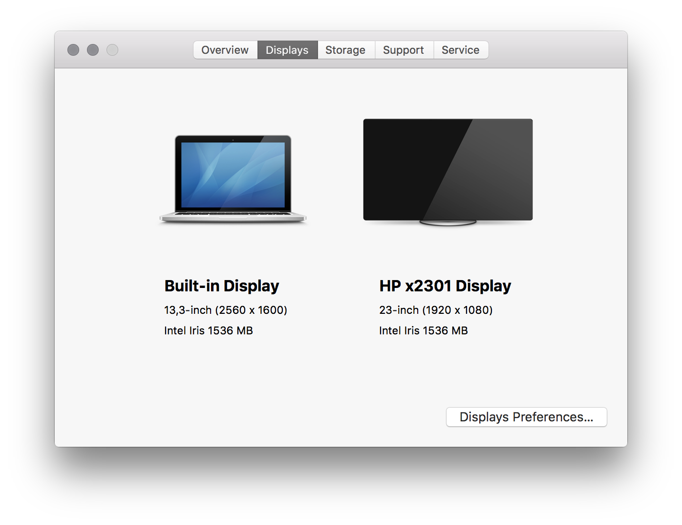

Alchemistake Posted April 12, 2016 Share Posted April 12, 2016 I've used your script, and read a lot of things. I have rMBP 2014 Late, GTX 750 and Akitio. The installation failed like 2-3 times (Web driver could not start and it raised an alert pop up), after I try older beta web driver it worked. Whilst the mac sees the card, the web driver shows the card on ECC tab; I was not able to see NVidia GTX 750 on the about the mac. Even I get a output through the card, but it said Intel Iris on the about the mac part and displays tab. How can I fix the problem? On some other forum (another site that shows your script) someone said after clean install it fixed everything. But I am middle of a season and trying to finish my jobs it is not the best option for now. I don't know is this place to ask but I am pretty sure it is something related to software side of the equation. Though I am %99 sure it is not your script. Quote Link to comment Share on other sites More sharing options...
euqlaog Posted April 13, 2016 Author Share Posted April 13, 2016 I assume you meant to say Late 2013 or Mid 2014 rMBP. Both have the same model identifier. The script requires untouched S/L/E folder and it’s automated to download only official drivers that match with the OS X build. If you have modified kexts manually, your only option is to reinstall OS X or restore from a Time Machine backup. Quote Link to comment Share on other sites More sharing options...

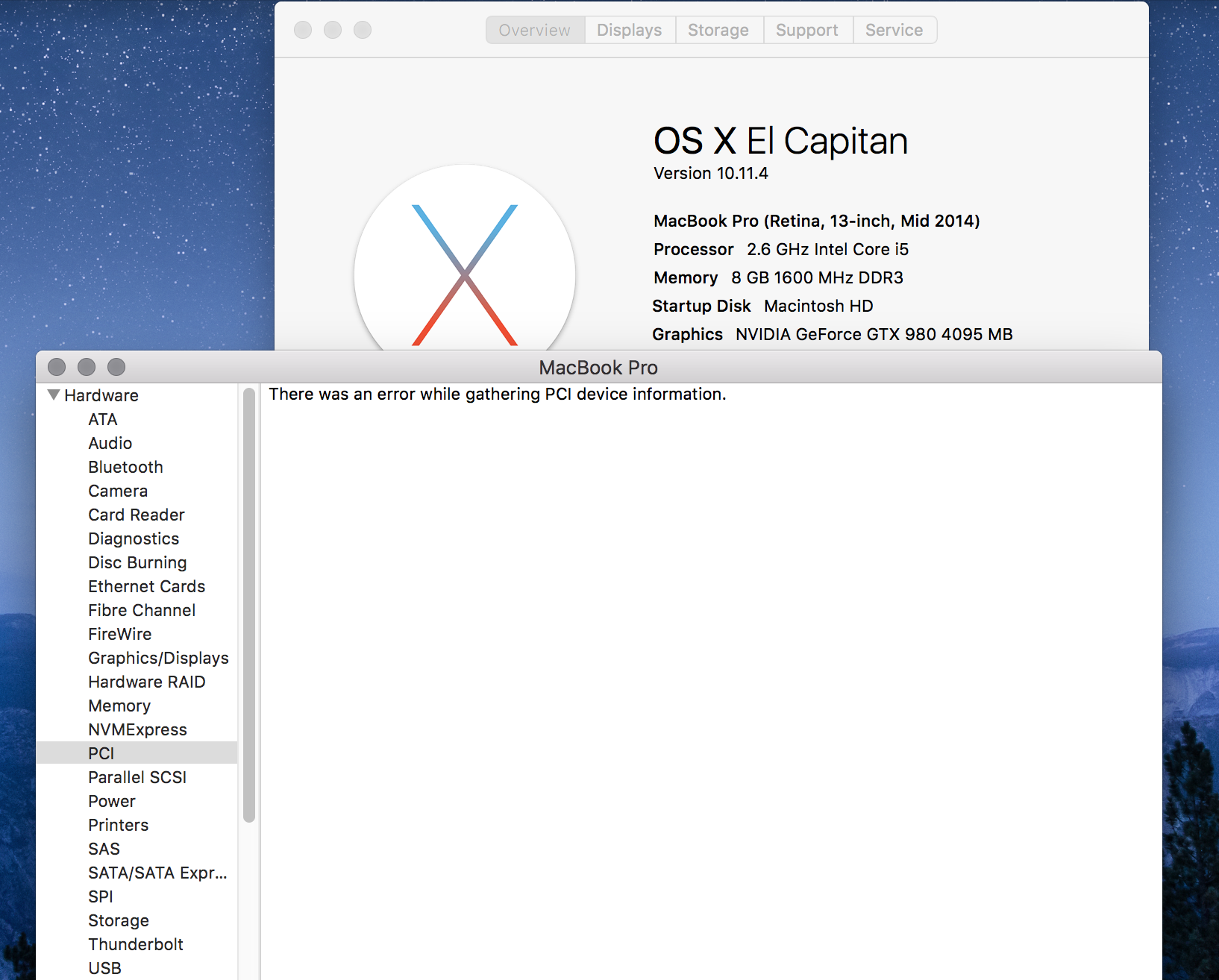

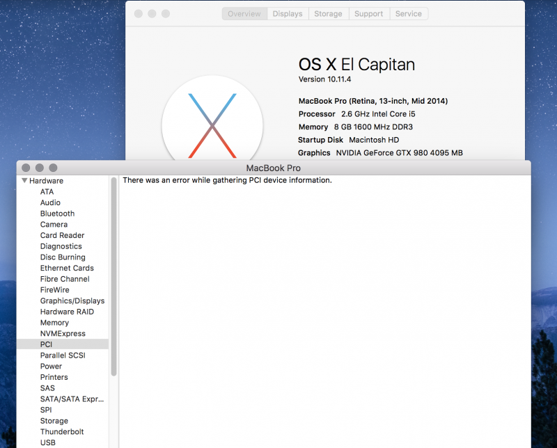

MacGTX Posted April 14, 2016 Share Posted April 14, 2016 (edited) Hi Goalque, I have the same problem as Proph when using 13'' MBP (mid 2012) or 13'' rMBP (mid 2014) with ASUS GTX980 and Akitio. Sometimes the setup actually worked with the external monitor. But when I restarted my rMBP afterwards, the progress bar would stuck at 50% with no exceptions. Also in the system report - PCI, it says "There was an error while gathering PCI device information" no matter the eGPU works or not. Am I the only one who has this problem? I completely reinstalled OS X but the startup problem wasn't solved. Before the release of El Capitan I used to manually edit the plist files but now it seems that method doesn't work anymore. Edited April 14, 2016 by MacGTX Quote Link to comment Share on other sites More sharing options...

Alchemistake Posted April 14, 2016 Share Posted April 14, 2016 21 hours ago, goalque said: I assume you meant to say Late 2013 or Mid 2014 rMBP. Both have the same model identifier. The script requires untouched S/L/E folder and it’s automated to download only official drivers that match with the OS X build. If you have modified kexts manually, your only option is to reinstall OS X or restore from a Time Machine backup. I did a clean install. And then it is same. I have output from external card but it says intel iris. What should I do? Quote Link to comment Share on other sites More sharing options...
euqlaog Posted April 14, 2016 Author Share Posted April 14, 2016 (edited) @MacGTX The error message under Hardware/PCI is normal. Did you try Erase & Reinstall OS X? What does “sometimes” mean? @Proph Ok. So the first restart works with eGPU [-a] mode and never with [-m] mode? What's the output of (4) after reboot (try first eGPU unplugged)? And do you have automate-eGPU-dameon.plist in /Library/LaunchDaemons/ ? Edited April 14, 2016 by goalque Quote Link to comment Share on other sites More sharing options...
euqlaog Posted April 14, 2016 Author Share Posted April 14, 2016 @Alchemistake Set the external monitor as the primary in System Preferences/Displays. Quote Link to comment Share on other sites More sharing options...
Dschijn Posted April 15, 2016 Share Posted April 15, 2016 13 hours ago, goalque said: @Alchemistake Set the external monitor as the primary in System Preferences/Displays. That should work! But even when the external is displayed to work on the Iris, it is connected and running by the eGPU. Setting the external monitor as the primary will make games start with eGPU performance! Quote Link to comment Share on other sites More sharing options...
