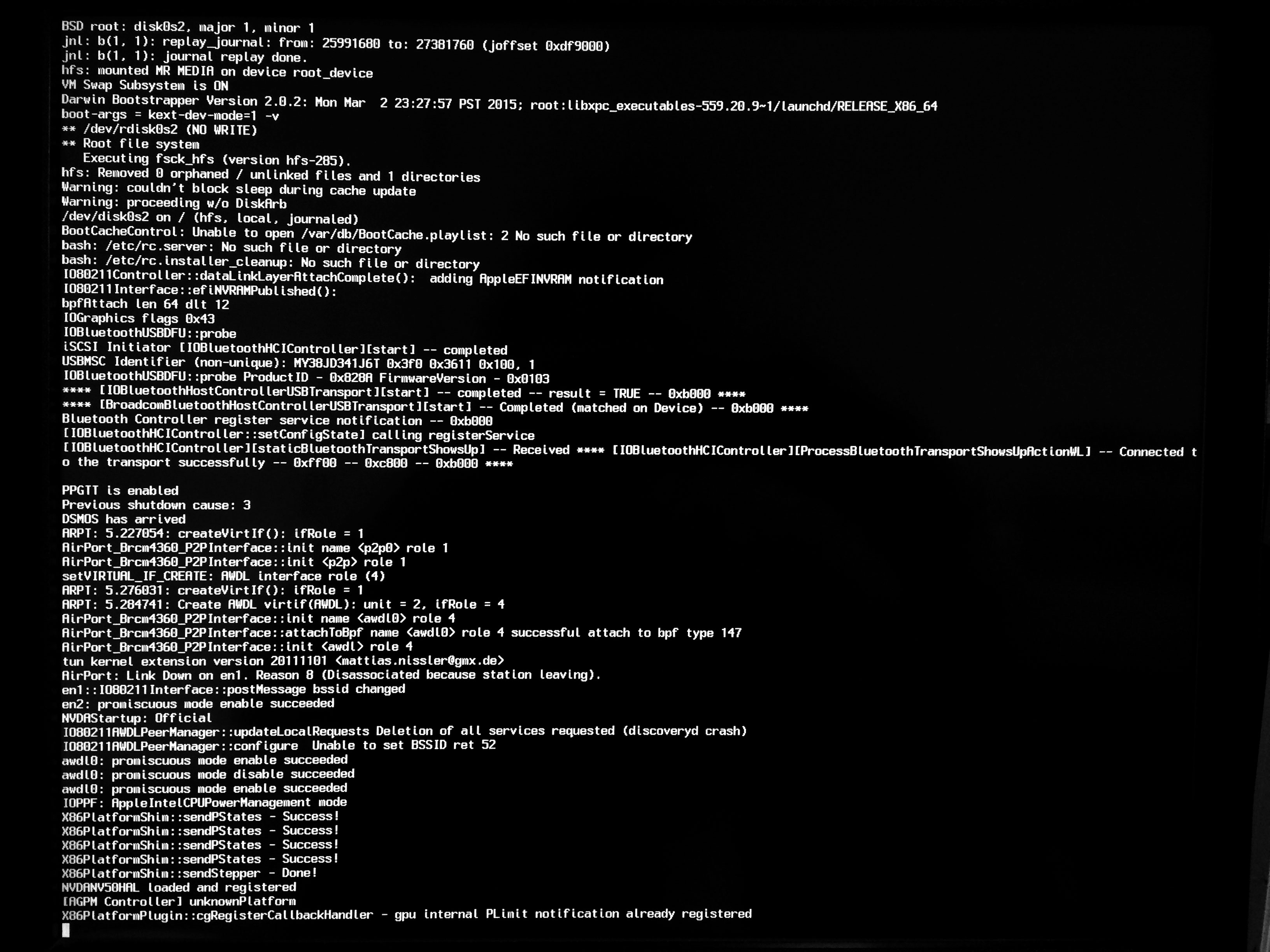

pixxelpusher Posted March 18, 2016 Share Posted March 18, 2016 (edited) Hi Thanks for the script! Made for an easy install, however I'm having problems getting the system to boot. So I've installed the script onto a 2012 Mac Mini (OS X 10.10.3). Which loaded the drivers, then I restarted (all on internal graphics). After restart the Nvidia logo in the top of the screen shows it's running the Nvidia Web Driver. Also now in System Information under Graphics/Displays it show's the video card as "NVIDIA Chip Model" - "GPU" - "PCIe", so it sees the card. So now I shutdown the computer. Unplug the LCD from the internal graphics and plug it into the video card's DVI port in the Akitio. I leave the Thunderbolt cable plugged into the Mac Mini going to the Akitio case. I turn on the computer and the LCD screen turns on and it goes white - it has picked up the video signal!!! Yay! - however that is all. It stays white for a while and then goes black again. The fan in the Akitio spins down and then up and the screen goes white again... in an endless loop. I have to remove the Thunderbolt cable going to the Akitio case, put the LCD DVI cable back to internal graphics and force the Mac Mini to restart to get it to boot again. Am I doing something wrong or missed a step? Edited March 18, 2016 by pixxelpusher Quote Link to comment Share on other sites More sharing options...
euqlaog Posted March 18, 2016 Author Share Posted March 18, 2016 (edited) @pixxelpusher You didn't say anything about your eGPU. Reinstall OS X and run the script again. 99% of the problems are caused by improperly installed hardware or manually messed up kexts. https://www.techinferno.com/index.php?/forums/topic/9534-2012-macmini-i7-26ghz-geforce-gtx970-10gbps-tb1-akitio-thunder2-os-x-10113-gosmond/&do=findComment&comment=139712 Edited March 18, 2016 by goalque Quote Link to comment Share on other sites More sharing options...
pixxelpusher Posted March 19, 2016 Share Posted March 19, 2016 (edited) 11 hours ago, goalque said: @pixxelpusher You didn't say anything about your eGPU. Reinstall OS X and run the script again. 99% of the problems are caused by improperly installed hardware or manually messed up kexts. https://www.techinferno.com/index.php?/forums/topic/9534-2012-macmini-i7-26ghz-geforce-gtx970-10gbps-tb1-akitio-thunder2-os-x-10113-gosmond/&do=findComment&comment=139712 Thanks for the reply. The GPU is a Mac Nvidia GT120 that I'm just using for testing purposes in the Akitio Thunder 2 while I organise a power supply for my 980. Everything else is unmodified. The system is clean apart from the script that I ran, that seemed to go through ok as it said successful at the end (I've never modified anything on it manually). The rest of the setup is how I explained it above. I could try and install a fresh OS X onto another drive and redo the script? Thanks for the link as well, I'll read through it next. Edited March 19, 2016 by pixxelpusher Quote Link to comment Share on other sites More sharing options...

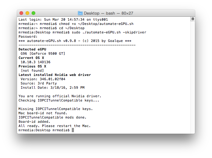

euqlaog Posted March 19, 2016 Author Share Posted March 19, 2016 The script is designed to support only Kepler and Maxwell architecture cards from Nvidia even if it’s able to detect almost any device id. You may have luck with -skipdriver option. 1) sudo ./automate-eGPU.sh -uninstall 2) restart 3) sudo ./automate-eGPU.sh -skipdriver 4) restart If it doesn’t work, your GPU is not supported natively either. Quote Link to comment Share on other sites More sharing options...
pixxelpusher Posted March 20, 2016 Share Posted March 20, 2016 17 hours ago, goalque said: The script is designed to support only Kepler and Maxwell architecture cards from Nvidia even if it’s able to detect almost any device id. You may have luck with -skipdriver option. 1) sudo ./automate-eGPU.sh -uninstall 2) restart 3) sudo ./automate-eGPU.sh -skipdriver 4) restart If it doesn’t work, your GPU is not supported natively either. Ah ok I didn't realise that. The GT120 still does work with Mac OS X as I still use it in my Mac Pro from time to time when I need a boot screen. I will run the commands you listed and see if that works and report back. Else, I'll just have to wait until I get my power supply and test with the GTX 980. Quote Link to comment Share on other sites More sharing options...
pixxelpusher Posted March 20, 2016 Share Posted March 20, 2016 I've tried to install again running the new commands but have the same boot hang / restart loop, so it must be the GT120 is not supported and causing problems. I've attached a screenshot of what Terminal said after running the script, and also took a photo of the screen when restarting in verbose mode (just before it dies). I think I'll just have to wait and try again soon with the GTX 980. Quote Link to comment Share on other sites More sharing options...
