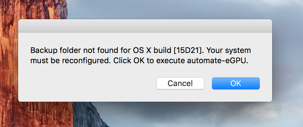

No need to reinstall the script. Whenever you decide to upgrade, you have two paths after the OS X upgrade:
1) If the -a mode is turned on, simply click OK:
15D21.thumb.png.6c64e1e95b61c16615974684

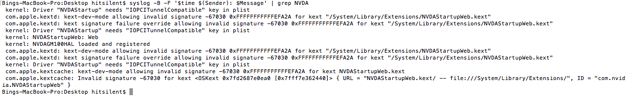

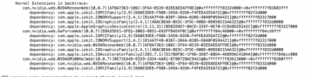

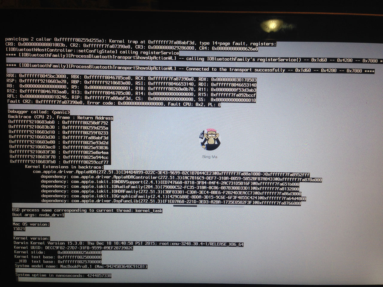

i tried my 3rd time today, still same issue. my MBP is Macbook pro early 2011 13"inch. Apple's Video issue just for 15"~17" model available to select . i was still not sure is that video issue problem or not.
i just toke a snap shot of that issue and the syslog after I run the script. can you please take a look ~ thanks~!!
syslog.thumb.png.cd0b772cd5bc61a2b95eab7
aaa.thumb.JPG.6d7108b9825167504447548bbb
The backtrace of the kernel panic indicates of AppleHDA.kext. The current script doesn't touch to this. But you did earlier, right? Even if you reinstalled the OS X, it may be possible that the faulty kext is loaded from the cache.
Can you boot into OS X after NVRAM reset, without eGPU?
If not, try in safe mode, uninstall the script and restart normally. Open console and search from the log what happened during that "kernel panic" startup.

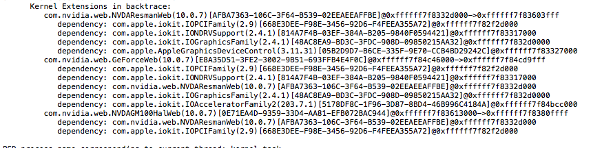

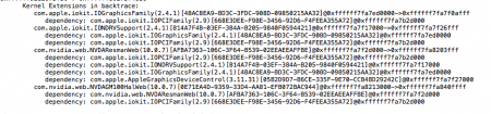

Now my problem is similar as toxec said, my Mac OS can detect the GTX 950 , but when i first boot on with EGPU+DELL DA-2 and TB cable, it cause issue then my MAC reboot again, and i screen cut the issue. it show few backtrace :
com.apple.iokit.IOGraphicsFamily, IONDRVSupport, com.nvidia.web.NVDAResumanWeb, etc..
after that issue, Graphic card fan doesn't run any more, the performance is nothing different than my Intel HD 3000, but it show GTX 950 in the Graphic Card system information.
picture as below:
