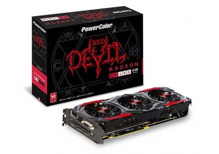

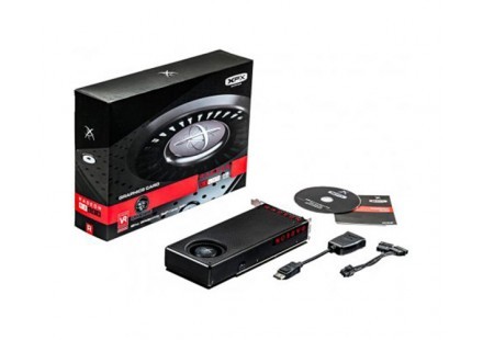

Hi, I have 2015 Macbook pro.
Intel Core i5, 8GB RAM, 128 ssd, macOS Sierra 10.12.1
Bootcamp Windows 10 on external USB hd with EFI boot
In January 2017 I intend to buy Akitio Thunder 2 for the assembly of my egpu ...
I think of using RX 480 8gb but I am in doubt on which brand to buy ...
What is the most compatible card with egpu?
POWER COLOR AMD RX 480 8GB RED DEVIL GDDR5, AXRX 480 8GBD5-3DH/OC:
GIGABYTE RADEON RX 480 G1 GAMING 8GB GDDR5, GV-RX480G1-GAMING-8GD:
XFX AMD RX480 BLACK EDITION OC 8GB GDDR5 PCI-EXPRESS, RX-480M8BBA6:
Which one should I buy?

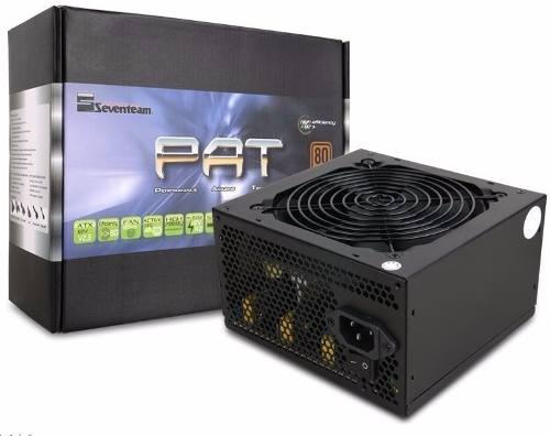

Is this source enough to power egpu and board?
Atx Seventeam St-500pat 500w Reais - 80plus Bronze
fonte-atx-seventeam-st-500pat-500w-reais
How do you power the thunder2 akitio and video card?
Just connect directly to the atx source?
