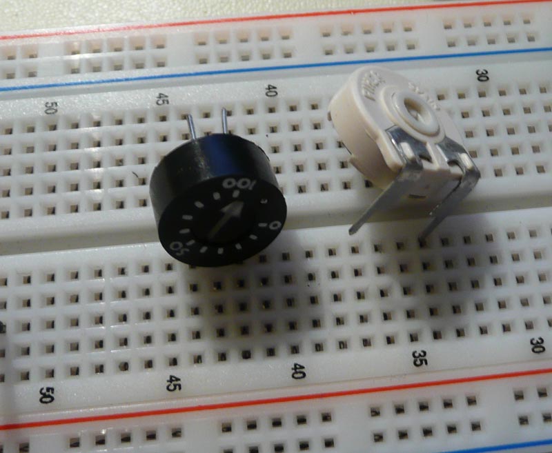

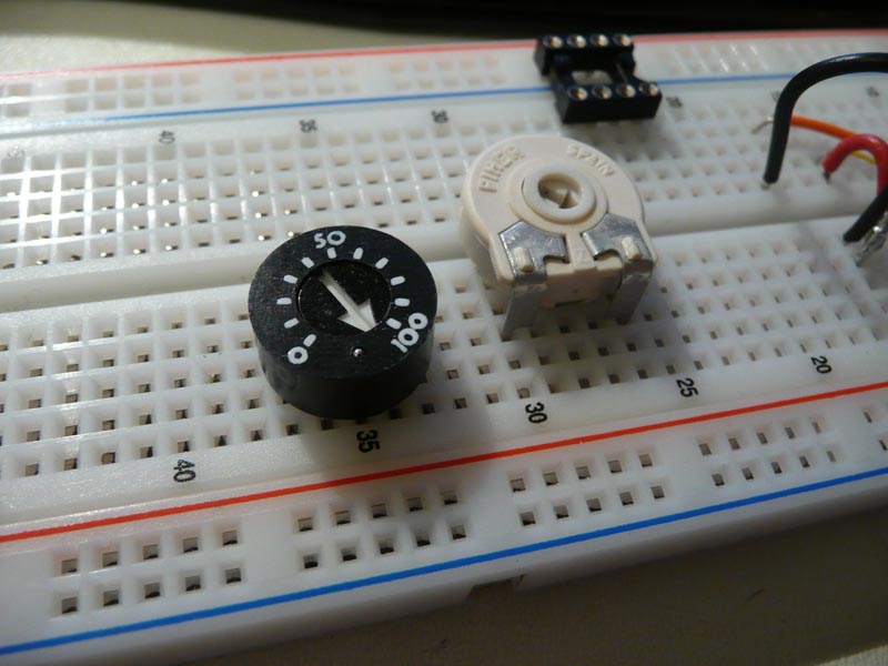

Check out these pics, the black one is the one I'm using for the 6970m mod, the other would work as well. Also make sure you don't get one of the flat trim potis, they're not meant to be adjusted all the time and are not easy to tune. A good trim poti should have a recess which allows to adjust it's value with a screw driver, also less than 20% tolerance is preferable imo.
