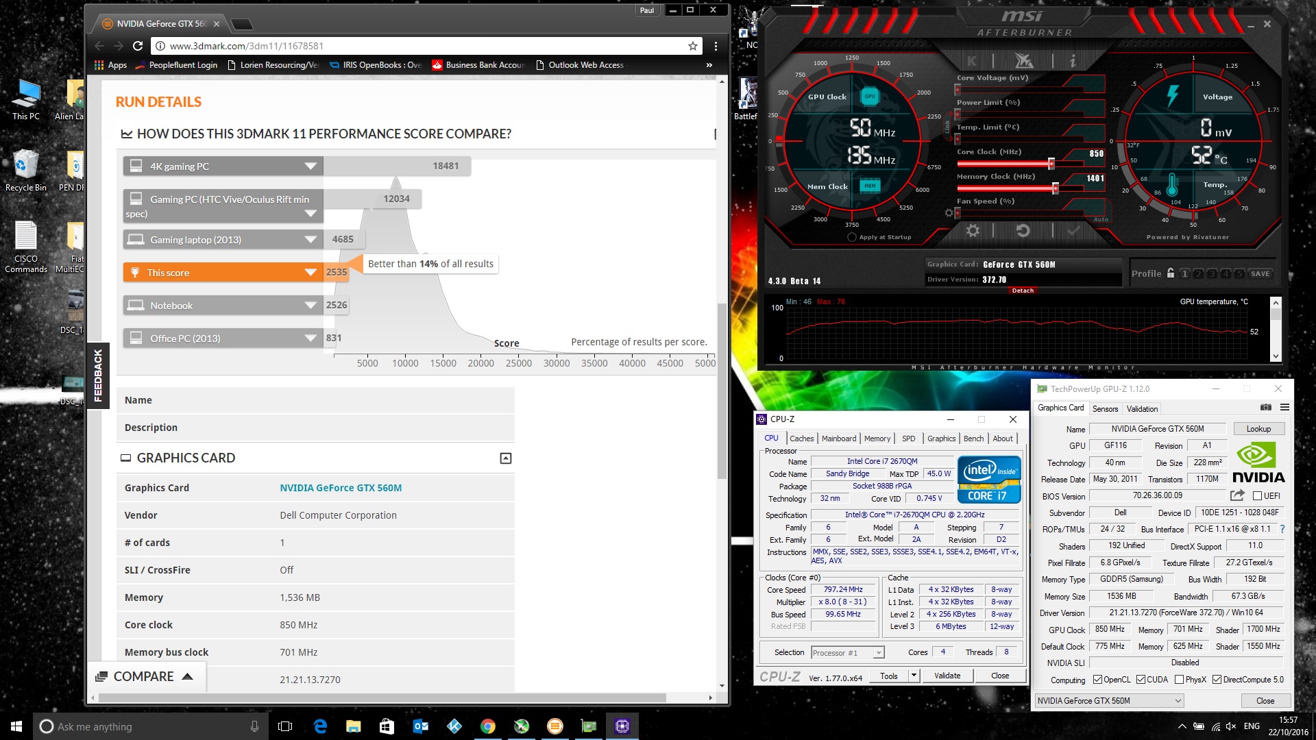

MavUK666 Posted October 22, 2016 Share Posted October 22, 2016 Not a great score compared to a lot of the ones I've seen, was on just over 2300 stock.... IS the QM chip dragging it down more than the GPU? Quote Link to comment Share on other sites More sharing options...
MavUK666 Posted October 22, 2016 Share Posted October 22, 2016 I must be doing something wrong... PCmark is a lowly 3176, but when I compare it to other systems with the same CPU & GPU, and a very similar setup of memory & SSD drive, they're up in the 5000's!! Anyone any ideas Quote Link to comment Share on other sites More sharing options...
