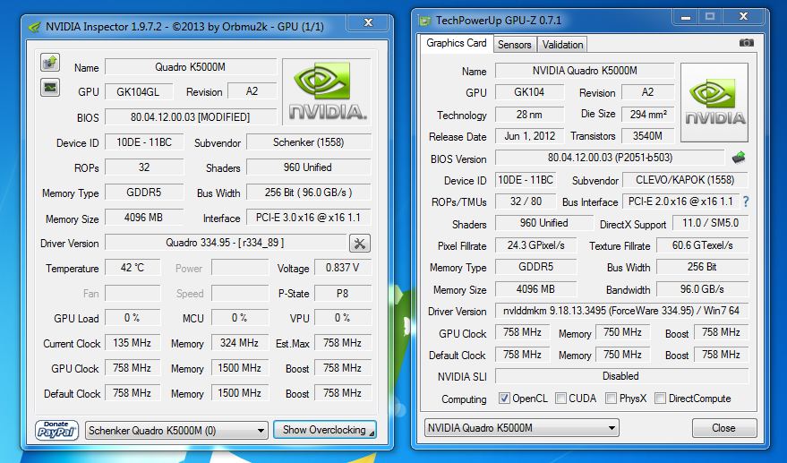

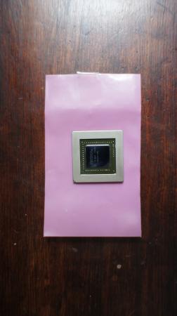

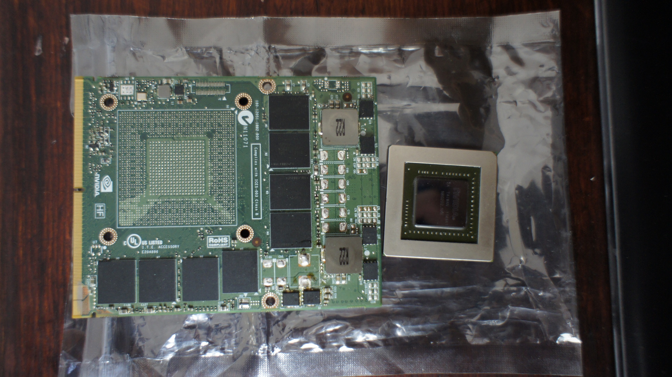

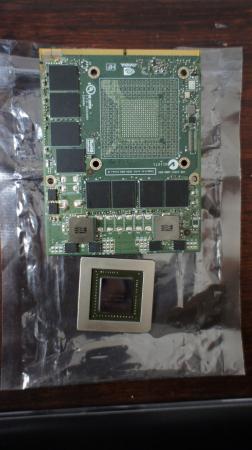

In brief. After my experience with the GK104 chip exchange in damaged K5000M for a GTX680 desktop chip (1203 A2), it seems to me that the number of total GPU active cores does not depend on the same chip, which in GK104 is almost identical for the desktop and for the mobile GPUs. It seems to me that it's only bios-power section depends.
I did not notice this thread earlier.
I don't think the vbios is the only thing that controls the number of active shaders; I posted earlier about crossflashing my gtx765m to a gtx770m, which didn't unlock any extra shaders. I think the chip still needs to have the shader cores enabled in the first place, otherwise the extra shaders should have been unlocked.
It's strange how your screenshots only show 960 shaders for the K5000m, as the normal chip has 1344 shaders, and the gtx680 should have 1536. If it was being limited by the vbios, then it should show 1344 for the transplanted chip, not 960. I guess one way to properly test if the vbios limits the shaders is to crossflash a high-end card with a lower-end vbios and see if the shader count changes.
I know this is not the bios only but its on connection with the power section. And what if that board id, or some stupid power phases jumper, decides the number of cores running?
Perhaps my damaged K5000M is not damaged but only is K4000M board crossflashed on K5000M?
That's a possibility. Have you tried flashing a stock K5000M vbios onto it? If it really is a K4000M board, then the drivers won't let the card enter the P0 clock state, with a non-matching vbios that isn't modified.
A little too late. As I have more time I will try to put together and test.
From what I remember this K5000M/K4000M with a GK104 chip from the GTX680 (desktop) had still a K4000M performance (6-7000 points in 3dmark11), same like with early 1149 A1 chip with which it got.
