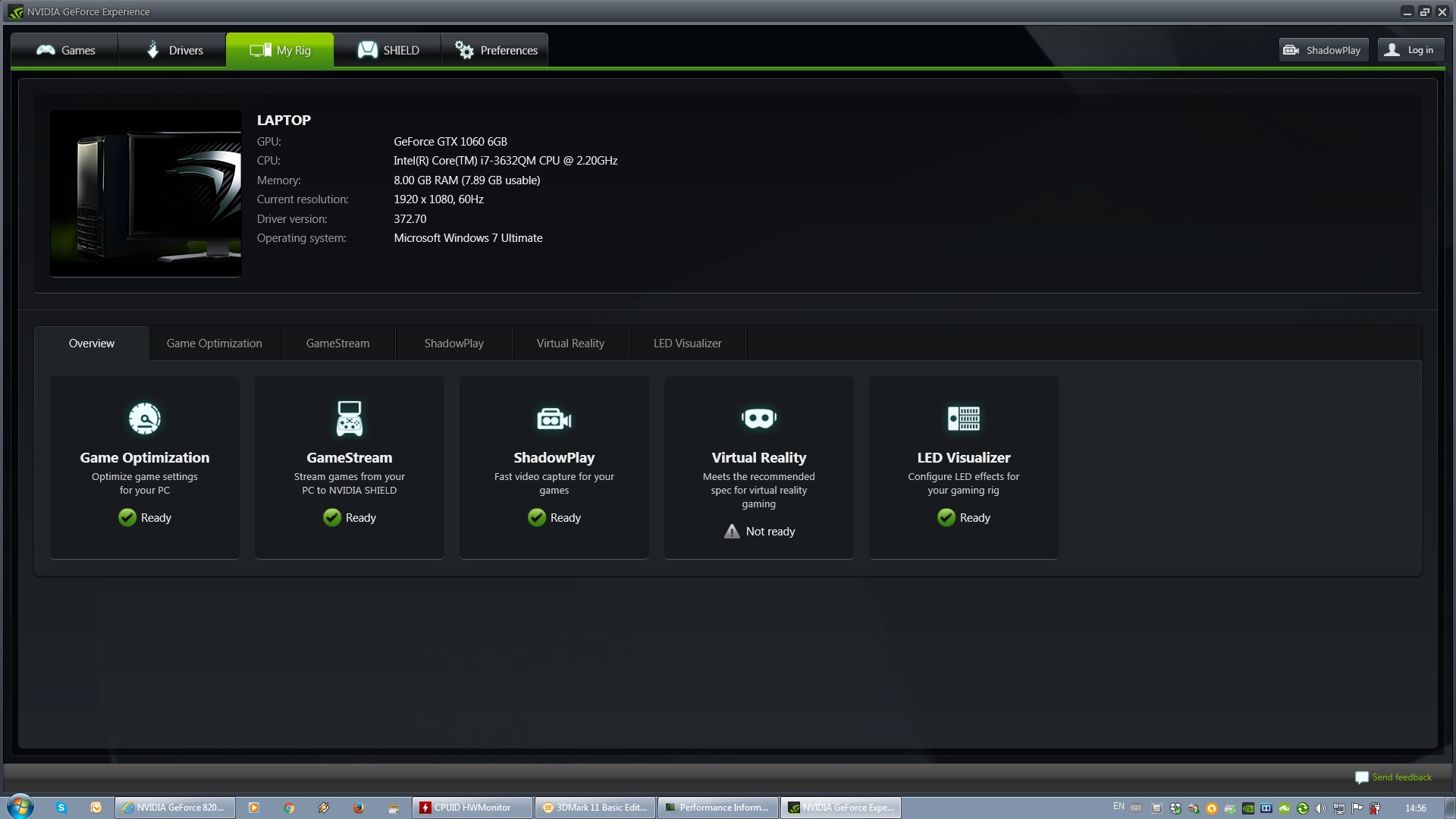

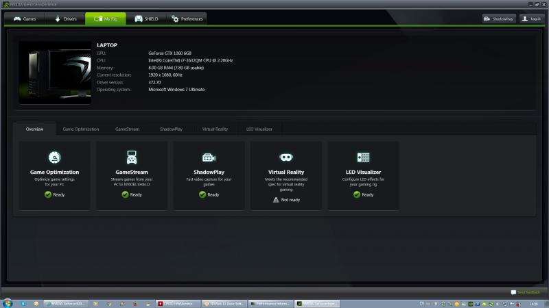

Hi ,
I have Acer V3-771G 73634g75makk  (i7 3632QM, 8G RAM, GT 710M) BIOS 2.28 A_A
S.O. W7 Ultimate/64 and W10 Pro/64
adapter : PE4C V3.0 mPCIe  http://www.hwtools.net/Adapter/PE4C V3.0.html  with Dell Adapter
eGPU : Asus GeForce GTX 1060 https://www.asus.com/us/Graphics-Cards/TURBO-GTX1060-6G/
Both windows detect GTX 1060 but no one works.
Any chanse to work without Setup 1.3 by Tech Inferno Fan just like rgpu ?
I ask this because I`m not a computer guy and I try to make a gaming laptop for my son.
I`m interested to use laptop display and only occasional external display
Edited by dan71
with last NVidia driver don't work , with 372.70 work but only on external display
done only 1 test, 3Dmark 2011 and I got
Graphics Score
12 506
Physics Score
6 806
Combined Score
6 932
and my gtx1060 is a 820 :))
http://www.3dmark.com/3dm11/11614037
can I use laptop monitor without seput 1.3 from ****** ?
BTW for Acer laptop V3-771G there is a nice moded BIOS.
