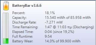

Battery life tweaks for the E6430?
@timohour , there's something you might want to investigate on how to improve battery life on a E6430. A good start being the list I have at http://forum.techinferno.com/hp-business-class-notebooks/2537-12-5-hp-elitebook-2570p-owners-lounge.html#post38399
I did get to play with a E6x30 a little while ago and noticed that Dell had a utility. It was either the "Dell Power Manager" or "Dell Feature Enhancement Pack". With it, there were additional Dell Settings in the power profile where you could further disable the SD card reader and the the optical drive when switched to DC.
If monitoring the idle power consumption with say Battery Bar software, setting those would drop power consumption a further 0.5W. A nice little gain to battery life.
This utility is only for specific devices. Seems like my E6430 won't like it (it won't install no matter what).
I started from an average of 17-20W. Now after applying most of the tweaks you linked I can go as low as 10-10.5W which translates to 6:29 with my 97Wh 9-cell battery (wear level 14% capacity 85.958).
I think it is great considering this is 14" 900p dGPU model compared to the 2570p 12,5" 768p iGPU model.
Tweaks that I used:
* Disabling the dGPU had the opposite effect raising the discharge rate with ~4-5W.
* Installed SSD
* enable ASPMs
There are UEFI variables that allowed me to set ASPM for PEG0 and every pcie (1-8) but I don't think there was more than 0.5W decrease (if there was any). Need to dig more on this one. Example.
Setting: ASPM Support, Variable: 0x52
Option: Disabled, Value: 0x0
Option: L0s, Value: 0x1
Option: L1, Value: 0x2
Option: L0sL1, Value: 0x3
Option: Auto, Value: 0x4
Every pcie port was set Auto and I manually set it L0sL1
* Enable AHCI Link Power management for SSD with HIPM+DIPM set.
* Set LCD brightness to be min+3 increments for DC mode in the power profile
* Set CPU max to be 99% in power profile for DC mode in the power profile. That disables the power hungry turbo boost.
* Set iGPU for max battery in Intel control panel and power profile
* Set wifi for max battery in power profile
* Using Throttlestop to decrease lowest max multiplier from x12 (1.2Ghz) to x8 (800Mhz).
I tried this but my laptop would be almost unresponsive (very slow) and I just went back. I didn't see much difference.
There is more work needed but even at 10W minimum with light wifi browsing for the dGPU and even less for the iGPU model I think stands ok for an 14" model.
What was your minimum with the E6440?
This utility is only for specific devices. Seems like my E6430 won't like it (it won't install what so ever). I started from an average of 17-20W. Now after applying most of your the tweaks you linked I can go as low as 10-10.5W which translates to 6:29 with my 97Wh 9-cell battery (wear level 14% capacity 85.958).
The 900P E6440 got down to 4.7W idle with a Samsung S840 that supported the Series-8 chipset's DEVSLP. I have played around with a E6230 and E6430s systems and could get them down to 5.4W idle.
Notebookcheck got a i5 768P E6430 iGPU-only model idling at 7.4W min: Review Dell Latitude E6430 Notebook - NotebookCheck.net Reviews . So collectively you might have some scope to drop your power consumption further.
Surprised those Dell Utilities didn't install for you. I installed the "Dell Feature Enhancement Pack" on a E6430s where had an extra "Dell Settings" item appear in the power management options. There I could disable the SD card reader on DC which gave a slight power reduction. I pay attention to that device because on a 2570P it would add a hefty ~2W overhead when active.
Oh.. and don't forget to disable the Bluetooth radio as well. There may be some power savings there. Your audio controller too might have a "power off in xxx seconds" option in the audio control panel.
Worth mentioning, the latest Haswell ULV ultrabooks can idle at 3.5-4W when equipped with a SSD!! Part of the reason for that is the their Series-8 Lynx Point chipset is on the ULV CPU itself.
Ok my bad I tried again and this time it installs, no problems at all. The one I downloaded yesterday was an older version and that's probably why it wouldn't work.
The funny thing is that I saw a huge difference. Setting Extended Battery Life Power Plan (which disables almost everything aero themes, SD card etc). I also manually removed the DVD drive and the lowest idle discharge that I saw was 7.2W!!!
Taking the full runtime from 6:29 to over 9 hrs? Impressive
Maybe better could be achieved if I replace my current SSD with an 850 EVO.
Right now I am using an old LIteOn LMT-128M6M mSATA drive that I pulled from my Chromebook with a cheap msata to sata adapter which probably spares power to heat for the 5V-->3.3V conversion.
Thanks for your help!!!
The funny thing is that I saw a huge difference. Setting Extended Battery Life Power Plan (which disables almost everything aero themes, SD card etc). I also manually removed the DVD drive and I saw an idle discharge of 7.2W!!!
Taking the full runtime from 6:29 to maybe 9 hrs? (to be checked)
7.2W is more like it :) Based on my E6230 I'd say lowest possible would be 5.4W min idle on your system. Is there another 1.8W you can find? It would be a matter of investigating further and maybe discovering some more power savings.
Regardless, starting at 17-20W, then 10-10.5W and now 7.2W is a huge optimization. Congratulations :78: I'd encourage you to document the most useful battery optimization tweaks as a checklist for other E6430 owners to easily duplicate and enjoy.
7.2W is more like it :) Based on my E6230 I'd say the best possible would be 5.4W would be the idle min on your system. Is there another 1.8W you can find? It would be a matter of investigating further and maybe discovering some more power savings.
Couldn't it be the dGPU that even @ idle uses some power? Or the extra screen size? Or even the quad core? I will continue my quote though.
Will do.

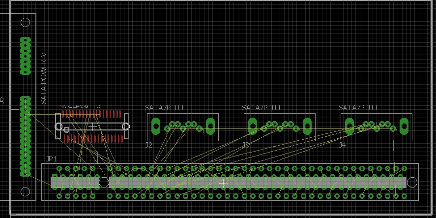

@TheClassicalCat seems like he is creating a custom adapter which theoretically would hold an x4.2 (16Gbps) signal.
This is an ongoing project but since he didn't update, may I suggest that he ceased the project?
If by "clean" solution you mean use the EC and port 4, there is no proof it will work.
Till now @sskillz and myself have tried with no results (check pages 6 & 9). We haven't found yet why we can't enable port 4's TX RX. There is maybe a signal that needs to be pulled in order for port 4 to work.
I didn't have the time to implement in depth tests though. I have been planning to get some new gear (E-module USB 3.0) to test further but this could take a little while.

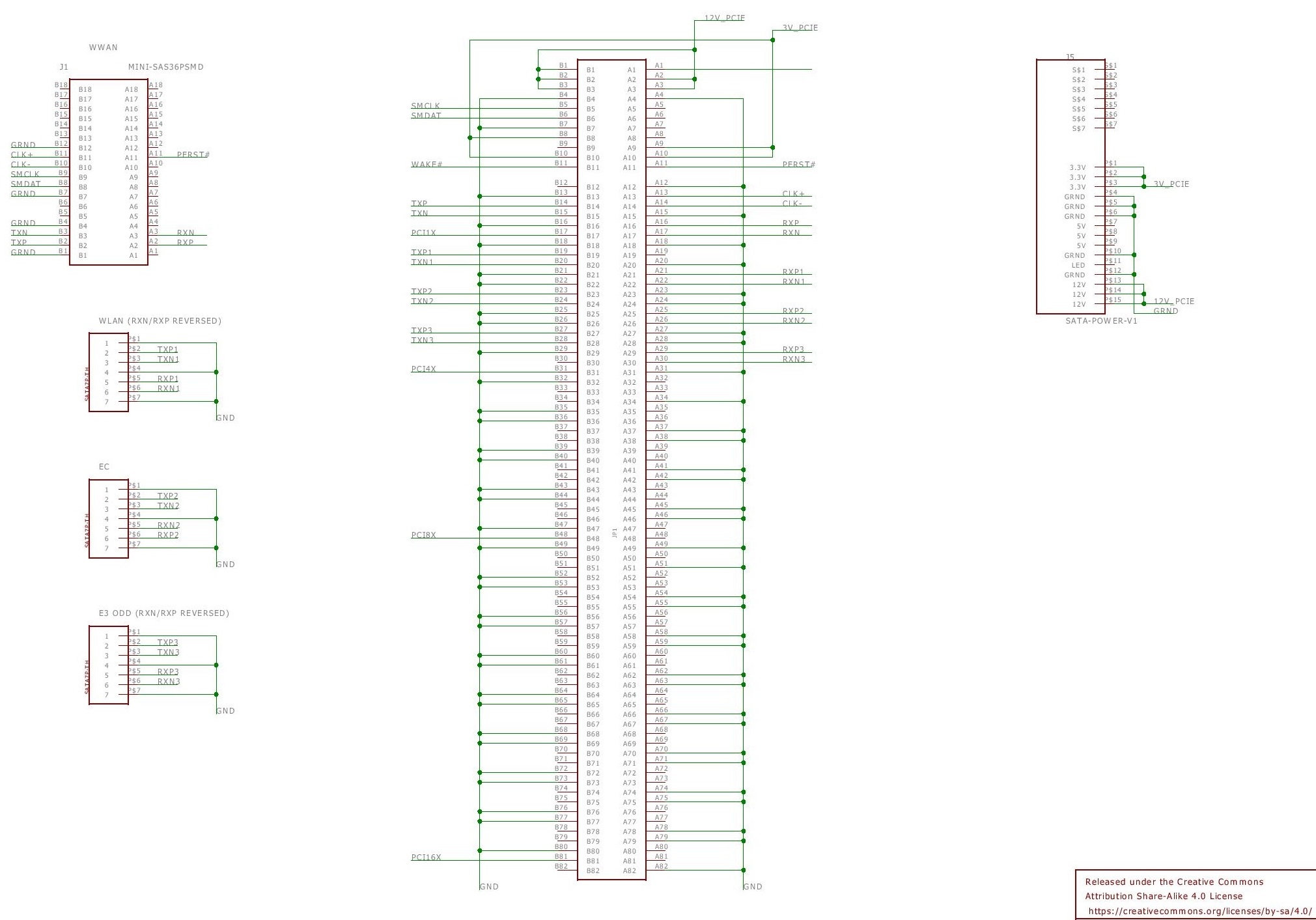

Yeah, it's been awhile since I worked on the x4 project, been busy since moving homes. But, here's a teaser of the near final layout before routing:
And I don't fully remember where I was at with the schematic but here it is (closely followed from other schematics):
As soon as I get more time I will continue this project but I would love for the E-module port to be figured out by the time I get this thing made. I have a few other projects to get done this summer with another mechanical engineering buddy so this may be a weekend only project. I already bought the connectors, no way am I giving up now :)

100th post and it must be something with value. That's at least what I thought.
Battery life on the E6430 is something that Dell boasted about at its debut, claiming that with all the batteries connected it would manage to hold more than a full day (32.7h).
Sounds amazing huh? So, after Tech Inferno Fan recommendation I decided to find out if this battery time could be reached.
Looking at reviews from notebookcheck.net, I could see that it would be the most efficient notebook among others in the same category:
 Dell Latitude E6430 proves to be very energy efficient with a power consumption of 7.4 - 10.7 Watts at idle. Particularly the ThinkPad T430 and Elitebook 8470p have to provide more and brighter pixels alongside a dedicated graphics card and thus need around 5 Watts more.
Note that the HP doesn't have switchable graphics and that's most probably why it won't last long enough.
Well I would expect more power consumption than that having in mind that I own a dGPU laptop with a bright 900p screen and since the first time that I installed BatteryBar and let it to idle I could see a massive discharge rate of 17W!
So I decided to try some of the tweaks that Tech Inferno Fan gathered on the 12.5" HP Elitebook 2570P Owner's Lounge thread and some new 02.47-tranquillity.png.

? maybe Use throttlestop to decrease lowest max multipler from x12 to x8. This resulted in a very slow computer... 1/5
X No Disabling the dGPU had the opposite effect raising the discharge rate by 4-5W.
Using the above settings I could see a minimum of 7.2W with the BatteryBar software predicting over 9 hours with my 97Wh battery (14% wear level)
I don't have the remaining Dell Batteries which would add up to 224Wh (9 cell on board + 9 cell on docking stations + 3 cell in E-module port II).
If I take for granted BatteryBar software results that would mean that my laptop in theory would last a little more than 23 hours. This is 9 hours less than the 32.7 advertise but keep in mind this results have been taken using a power hungry i7 quad, 1,5V dual channel memories, 900p bright screen and the dGPU model which definetely spends more power...
I am considering using my low power i3 over my i7 quad, which would use 0.7855V compared to 0.8756V @ x12. Using single channel DDR3L Ram would also lower the power consumption but these two would have a huge toll in performance. Will have more info on this soon...

Yeah, it's been awhile since I worked on the x4 project, been busy since moving homes. But, here's a teaser of the near final layout before routing.....
As soon as I get more time I will continue this project but I would love for the E-module port to be figured out by the time I get this thing made. I have a few other projects to get done this summer with another mechanical engineering buddy so this may be a weekend only project. I already bought the connectors, no way am I giving up now smile.png
Glad you are still in on this. Hope we have working results on the E-module II port 4. Waiting to be able to purchase the E-Module II USB 3.0 bay for testing...
May I suggest that you add USB signals on your first port. It won't make any harm and you could maybe add a USB hub on eGPU for keyboard, mouse, storage or even the uplink on an external screen... 5V power is already there.
