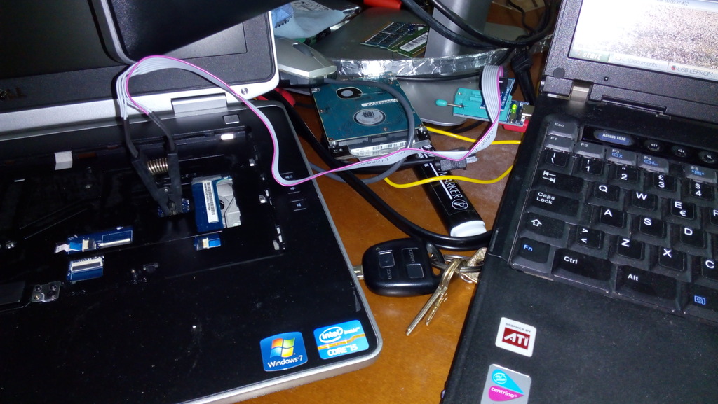

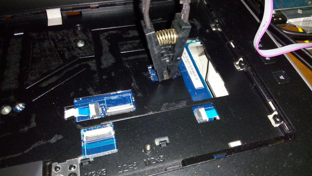

ericnickset Posted June 1, 2017 Share Posted June 1, 2017 I don't understand how to locate IDT chip to pin it from newbie guide. Can you help me? Maybe send photo? Quote Link to comment Share on other sites More sharing options...

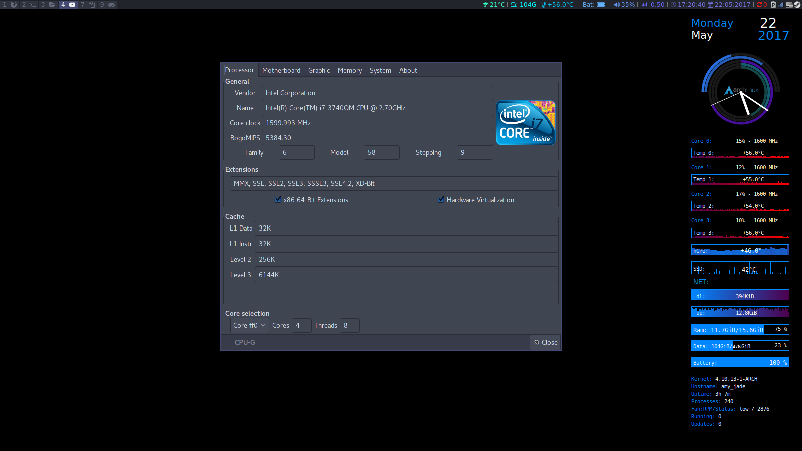

Skimpypimp Posted September 27, 2017 Share Posted September 27, 2017 (edited) Hello, I am a owner of e6430. My current specs are: i7 3740QM 16GB Corsair Vengeance DDR3 1600 MHz BIOS A18 Windows 10 64bit I had no problem unlocking the flash descriptor. However, the true purpose of me doing the tweak is to overclock my processor and that has failed. #1: I tried manually to modify my bios using FITC. I did everything guide said, flash was successful but Intels XTU tool did not let me overclock. #2: I tried flashing the provided bios E6430UCME.bin and that to did not let me overclock using Intels XTU Tool. Does anyone have the proper way to get Intel XTU to work with BIOS A18 and running Windows 10? Maybe someone could provide me with instructions or a bios backup with the modification for e6430 model. Thanks and much appreciation!! $$$$$$$$$$$$ PS: Anyone who can help me setup overclocking with the XTU utility and XMP memory MOD I will gladly compensate you through paypal. $$$$$$$$$$$$ My contact: [email protected] Edited September 27, 2017 by Skimpypimp Quote Link to comment Share on other sites More sharing options...

ericnickset Posted October 8, 2018 Share Posted October 8, 2018 Hi, can anyone do backup of own E6430 with bios a21 or a22? I need dump of two bios chip under keyboard. I have flashed bios from web a14, because killed own. And now I have issue, I can't update bios in regular way and network adapter has error 10 and work only after turn it off, and then turn on. Quote Link to comment Share on other sites More sharing options...

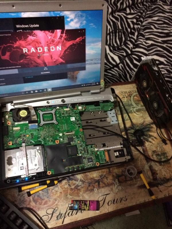

Devo552 Posted April 29, 2019 Share Posted April 29, 2019 (edited) So this is my first time posting. I have spent the last 2 weeks trying to get my eGPU R9 380 to work with my Dell Latitude E6430. And THIS LAPTOP DOES HAVE SOME SORT OF BIOS WHITELIST OR VENDOR ID BLACKLIST OR SOMETHING on all 3 mPCIe slots. And from my testing and research, it does NOT affect the ExpressCard Slot in any way shape or form. I can prove it. I have one of the less than $10 PCE164-008C mPCIe to 16x PCIe riser boards. I have done every possible thing to get this working. From Bios settings, hotplugging, DIY eGPU Setup 1.35 and 1.3x. MBR boot, UEFI boot, Clover boot. EFI variable settings with setup_var. Using port 1 (wwan), port 2 (wlan), and port 5 (1/2 mPCIe). Tried setting gen1 and gen2 speeds (x1.2 and x2.2) with Flash Image Tool. Wrapped the cable and board in case of interference. And did all tests in Win7, Win10, and Linux Mint. If you can think of a possible variation to get eGPU detection on an mPCIe slot, I tried it. eGPU just will not get detected. Period. No Exceptions. I tested the graphics card in my buddy's gaming Desktop in case of faulty hardware. I tested the 16x riser board with a 1x pcie adapter and USB 2.0 cable. And just to make sure my mPCIe adapter piece wasnt faulty or collecting interference, I jigrigged my old busted Dell Inspiron 1525 into life and hooked my eGPU assembly to it. I never expected this rig to turn on let alone read the eGPU. I have attached a pic of it plugged into the card and installed the drivers for the R9 380. If anyone can help me mod the standard A23 or A20 bios from Dell to remove this block on the ports, I will GREATLY APPRECIATE IT. I have spent 90% of this weekend dumping and modifying and inspecting and reflashing my own bios trying to find this whitelisting or whatever it is and I have hit a roadblock. I will continue testing on my end so that I can get my assembly working but if anyone has any tips or insight, I would love to hear it. Good thing is, this all lead me to building a gaming rig out of my old parts which so far is working quite well. And Yes, I could get the EXP GDC or Expresscard or jigrig an adapter. BUT, thats really no fun at all. Too easy. Plus, I built my eGPU assembly for less than $100 and $50 for the R9 380. Go Kijiji. And tell me that does not look cool? Dell Latitude E6430 i5-3360m 8gb RAM (no dsdt override for Largememoryaddress just a couple bios efi variables) Only iGPU (no discrete nvidia or ati dGPU) Intel HD 4000 Win10 64-bit+LinuxMint UEFI+CLOVER bootloaders And the miraculous Inspiron 1525 No clue about processor or iGPU 4gb RAM Atheros wlan card 4gb R9 380 eGPU https://ibb.co/N3q0pGvhttps://ibb.co/ypsJv0chttps://ibb.co/b70SXxJhttps://ibb.co/DQFBBDLhttps://ibb.co/yRGGF7mhttps://ibb.co/SPpX7BZhttps://ibb.co/gy255vQ Edited April 29, 2019 by Devo552 Quote Link to comment Share on other sites More sharing options...
