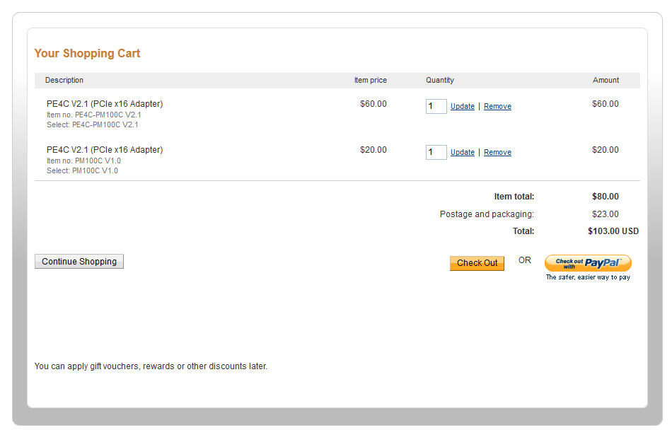

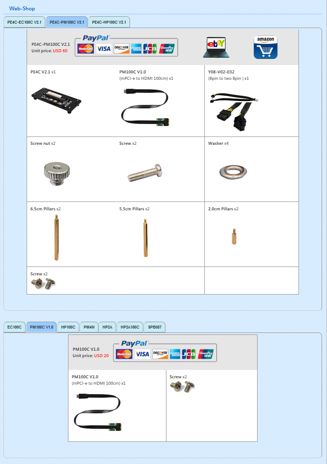

Which of these adapters I should buy to get that 8Gbps speed over my PE4L 2.1b EC adapter I have right now?
http://www.ebay.com/sch/i.html?_odkw=PE4C+V1.2&_osacat=0&_from=R40&_trksid=p2045573.m570.l1313.TR0.TRC0.H0.XBplus+PE4C+V1.2.TRS0&_nkw=Bplus+PE4C+V1.2&_sacat=0
follow this link http://www.hwtools.net/Adapter/PE4C%20V2.1.html
and select PE4C-PM100C V2.1 along with PM100C v1.0 as you can see in the following screenshot
That's a total of 103$ including s/h
Spoiler
If you want to use this adapter with your EC (and maybe sell the old adapter online) you can buy the PE4C-EC100C v2.1 along with 2 x PM100C v1.0. total cost will be $129.
Edited by timohour
  Reveal hidden contents
Will I get the 8Gbps speed with the EC version of PE4C v2.1?  If I can get the 8Gbps through EC port alon it would be good, because I really do not want to mess with underside of the laptop (make a cut out).
1 hour ago, viilutaja said:
Ok so 2 cables from adapter to laptop (EC+mpci-e or mpcie+mpcie)?
This is only possible when using the two mpcie ports. You set the #1 PM100C in port 1 (WWAN) and the #2 PM100C in port 2 (WLAN).
I suggested you grab an extra EC100C adapter in case you want to give away your current adapter.
Edited by timohour

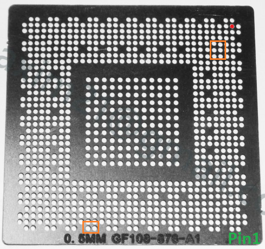

So I removed the g108 core for the nvs5200m and slapped on a 28nm gf117 core.
It doesn't work. The core and memory power up, indicating that the bgas really are compatable, but the gpu is not detected. The only sign of its existence is the TOLUD is not raising over 2.75gb. I did rip 3 solder pads off the motherboard getting the gf108 off, but the odds of one of these being required for gpu detection are very low. All 3 are likely uneccesary (likely power, gnd, display output, or unneeded part of pci-e), and I know they are not near the memory interface, which are really the only 100% required connections.
It looks like the gf108 vbios is not compatable with the gf117 core.
That's kind of weird. GF117 according to multiple sources was supposed to be Die-Shrink of the GF108 chip. Is it possible that your GF117(N13M-GS) chip is defective?
If you have a photo we can find out which pins were destroyed. I also think that it is highly unlikely those were crucial but just to be sure.
Edited by timohour

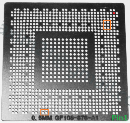

Do you have a ball description? I remember exactly where one is. The other 2 I remember within a few connections.
no but I could check through the schematics.
Edited by timohour
So this is looking down as if you were looking at the motherboard. Pin 1 is in the lower right corner. The pad marked in red is definitely missing. For the orange blocks, one of the pads is missing within that block, but I'm not sure which because I put the chip on and can't see.
The memory interface half that is active (the chips supports 128-bit, but only 64 are used) is on the left side, and other than that there are not that many required connections for a GPU. PCI-E will downsize as needed if defective, and over half the pins are power and ground. There are very few connections that should be required to detect if a gpu is present.
I'm leaning towards incompatible vbios as the problem. For example, the driver sends some instructions (vbios stores gpu instructions) and expects a result, but since the instruction set is changed it doesn't get anything back. If I have a stencil for it though I'll reball it and use leaded solder. I did have a tough time with the unleaded using a heat gun, so it's possible it isn't on right. There are no shorts though so it probably is on right.
Edited by Khenglish
Thanks, but I couldn't search without the photo from the board where every row has its letter. (I don't have mine around). I agree with you though that it must be a pin from the first RX-TX pair or one of very few pins used for detection in order for it to fail to be detected.
Do you think that it could be due to the incorrect setting of the straps? Or straps are only used after detection? I am sorry for my noob Q but never tried such a swap.
On these schematics pg. 22 you can see different straps used for different N13P chips and memory configurations. GF108 seems to be N13P-GL. I don't think it would help though.
On these pg. 4 it seems like our GF108 (N13P-GL) is probably interchangeable (same straps) with the GF119 (N13M-GE) which has 48 cores instead of 96...
The GK107? & (N13P-GS most probably GT640M or GT645M) would be a good bet too (according to the first schematics, & here).
Edited by timohour

@timohour since pin 1 is in the lower right, the bottom row in the image is row A, and column 1 is on the right.
@kondilac unfortunately there was no gf117 made with the same memory interface as the nvs5200, so no compatible vbios will exist. It would have to be a frankenvbios.
You were right the red pin is B33 from pcie lane 14
and the other pins you mentioned are not used at all (mem channel B )
another think I found which is worth mentioning is the fact that GK107 and GF117 are mentioned as compatible (at least the pinout)
Most probably a vBIOS issue. What do you mean no GF117 with the same memory interface as the nvs5200m?
Edited by timohour
@timohour
The nvs5200 has a 64-bit GDDR5 interface. All cards with a GF117 core have 64-bit DDR3 interfaces. Memory setup will be completely wrong if we try to copy/paste the whole vbios.
It's possible that the E6530 BIOS does not allow for pci-e downscaling. It needs to run x8 with the pad missing. I put a damaged 7970m that could only do x8 into a P150HM once and it did not run, and another undamaged 7970m worked fine. Meanwhile the P150EM did downscale the damaged card to x8 and worked fine. I could check if a sliver of the pci-e trace is left and try to get a ball on it, or maybe expose what's left of the trace and get a wire on. This is not something I will try for a while though as this will take a lot of time to do, and we're talking about a 96 shader fermi core here.
Also TY for the schematic info.
UPDATE:
So Prema is confident that the core cannot work with the GF108 vbios. I'm going to try a GF117 vbios and hope enough axillary stuff matches to at least get something out of it. It's possible the vbios will have a GDDR5 section in case GDDR5 is detected. Even if not the the should still be detected even with no functional memory.
Edited by Khenglish
