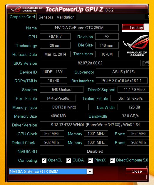

Post here a screenshot of GPU-Z.

Here you go.
it didn't work, still showing the default clock
I don't know what is the real problem then
