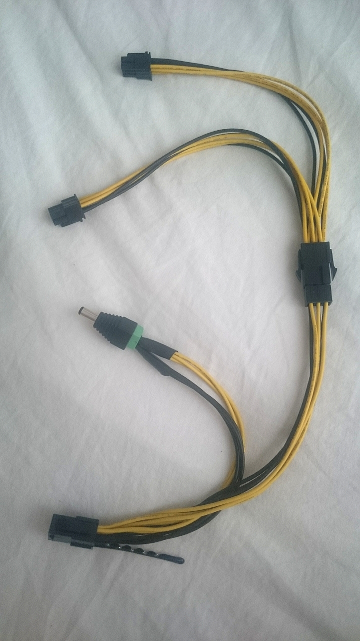

Note to get the wires to fit, I snipped the zip ties and flattened the wires to the sides. Still close, but nothing is getting pinched or slit as long as you're not a brute about it I imagine. I think a shorter version for internal use might be good. The vendor on eBay will make anything you ask for it appears.

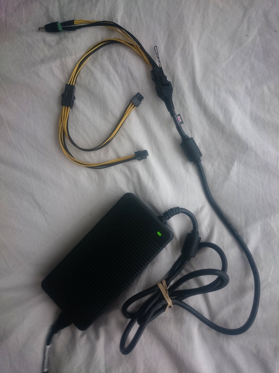

Hey guys just wanted to share a photo of my cables. I went with the way Morv did it :)
EDIT: My DA-2 just arrived a couple hours after my PCI cables did, just after I posted this, so extra pic added with DA-2 connected.

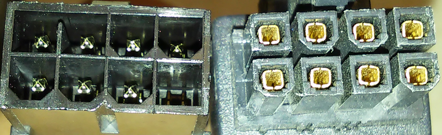

Bad news, just got that adapter thingy and the notching is incompatible with Dell DA-2 notching
EDIT: It can still fit, but you really have to force it in
PS I can confirm that this adapter will allow use of Dell DA-2 power supply with PE4L.
That's because they use a 8-Pin PCIe plug on that cable and the 8-Pin pf the DA-2 is different. Still they fit each other with a bit of pressure :D
Don't worry, that's the way it is supposed to be. Just make sure, that the row with the removed pin is connecting to the bottom row of the DA-2.

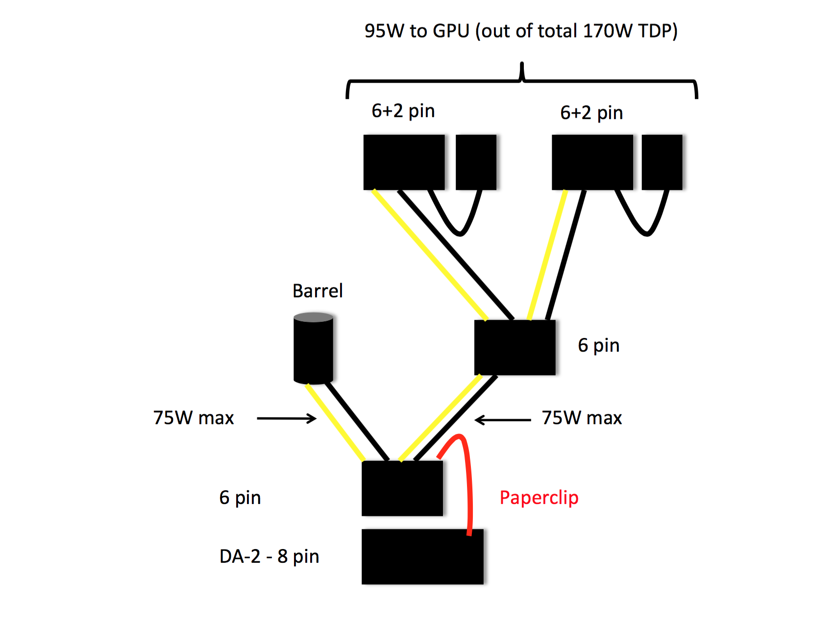

Hey guys,
My current eGPU setup:
- ATX Corsair CX500M PSU
- EVGA GTX 760 (170W TDP)
- powered PCIe x16 riser
The GPU requires 1x 6 pin + 1x 8 pin connectors and I'm not sure if the new setup I'm planning will safely provide that:
New eGPU setup:
- DA-2 PSU
- 6pin Y splitter (1x male to 2x female)
- 6pin to 2x6+2 splitter (got this from the PSU)
- barrel mod
So the GPU has 170W TDP, whereby 75W is provided directly from the PCIe slot and the remaining 95W is provided by 6 pin + 8 pin. However, the 6 pin splitter is only rated for 75W, so we are going slightly over. I found somewhere that in practice, the 6 pin is apparently able to provide way more, up to 150W, still not sure if it's safe over a long time.
Is this going to be a problem? Probably not during light use but how about when gaming or other GPU heavy tasks?
I made a super professional diagram to better illustrate the setup:
Bonus question: I'm about to solder the 2x12v and 2xGND onto a barrel. - Can I solder both 12v wires together onto the + terminal as well as both GND together onto the - terminal? Or how would I go about this?
Would really appreciate your input. Thanks for the help.
I would think you'll be fine. I'm running a Zotac GTX 970 with the same setup (though mine has 2x 6pin). Gaming has been working fine so far (granted Batman has been locked at 30 FPS so it's not straining the card that hard). But all has been well for me.
And yes to the soldering. I think that is fine as well.
@TryptoPhan: The GPU doesn't need that much power that is any way to worry. Also is the DA-2 limiting the mac. amount of power so I would say that it is safe to use the 6-Pin y-splitter.
Combining 2x12v and 2xground is no problem. Inside the PSUs it is already the same but splitted to separate wires later to spread the load.
