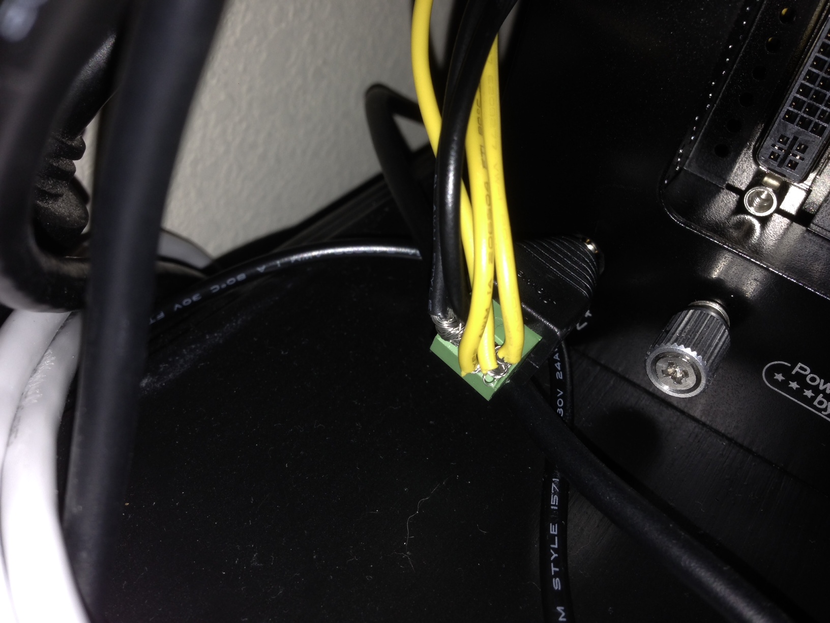

Got everything hooked up & working great with the DA2 + (2) 6 pin PCIe splitters + Screw Terminal 2.5mm x 5.5mm barrel adapter!
Only issue I ran into was fitting all of the wires into the screw terminals. 3 wires twisted together and stuffed into each terminal seems very tight fitting with a bit of exposed wire. I know this isn't recommended....and the photo makes it look even worse :-/
I was going to use some electrical tape and see if I can clean this up a bit. Any other suggestions from you guys?
[ATTACH=CONFIG]14992[/ATTACH]
Nice but exposed wires like this can be problematic. Put some electrical tape at least to be safe :) try also to cut the end bit of the wires to be able to insert them more ? Last resort you can cut a few filaments from each individual wires to thin the combined result.
I think you can spare the middle wire of each color. Most Molex->PCIe adapter only provide 2x12V instead of 3x12V, so it should also work for you. If it makes the wires fit even better… :)
Additionally shrink tubing and/or electric tape should be applied!

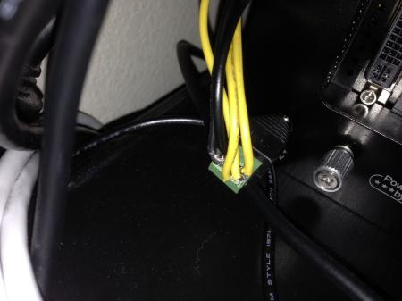

So here is the picture of my cables, still works like a charm, can't await my GTX 970 *sobbing* :D
@Morv: Really, really good.
Maybe you can show how you got the 3 wires each into the barrel plug. computersaysno seems to run out of space to squeez them all in.
[ATTACH=CONFIG]14994[/ATTACH]
Looking good. I see you used one side of the split only to power the 970. I instead spread the load by using one split from each to be "safe". Nice work.
Both ways can put loads up to 150+W to one of the splits.
Imho Morvs way is even a bit better because the barrel plug can draw up to 80-90W (75W PCIe slot + 10-15W of the AKiTiO).
So one of his splits is using 80-90W on the barrel and up to 150W on the other (2*75W 6-Pin PCIe).
Your way you can create loads of 75W on one split (1x6-Pin PCIe) and 155-165W on the other (1x6-Pin PCIe = 75W and 80-90W = 75W PCIe slot + 10-15W of the AKiTiO).
Still, both ways seem to work and before you can create such high loads the DA-2 will probably die.

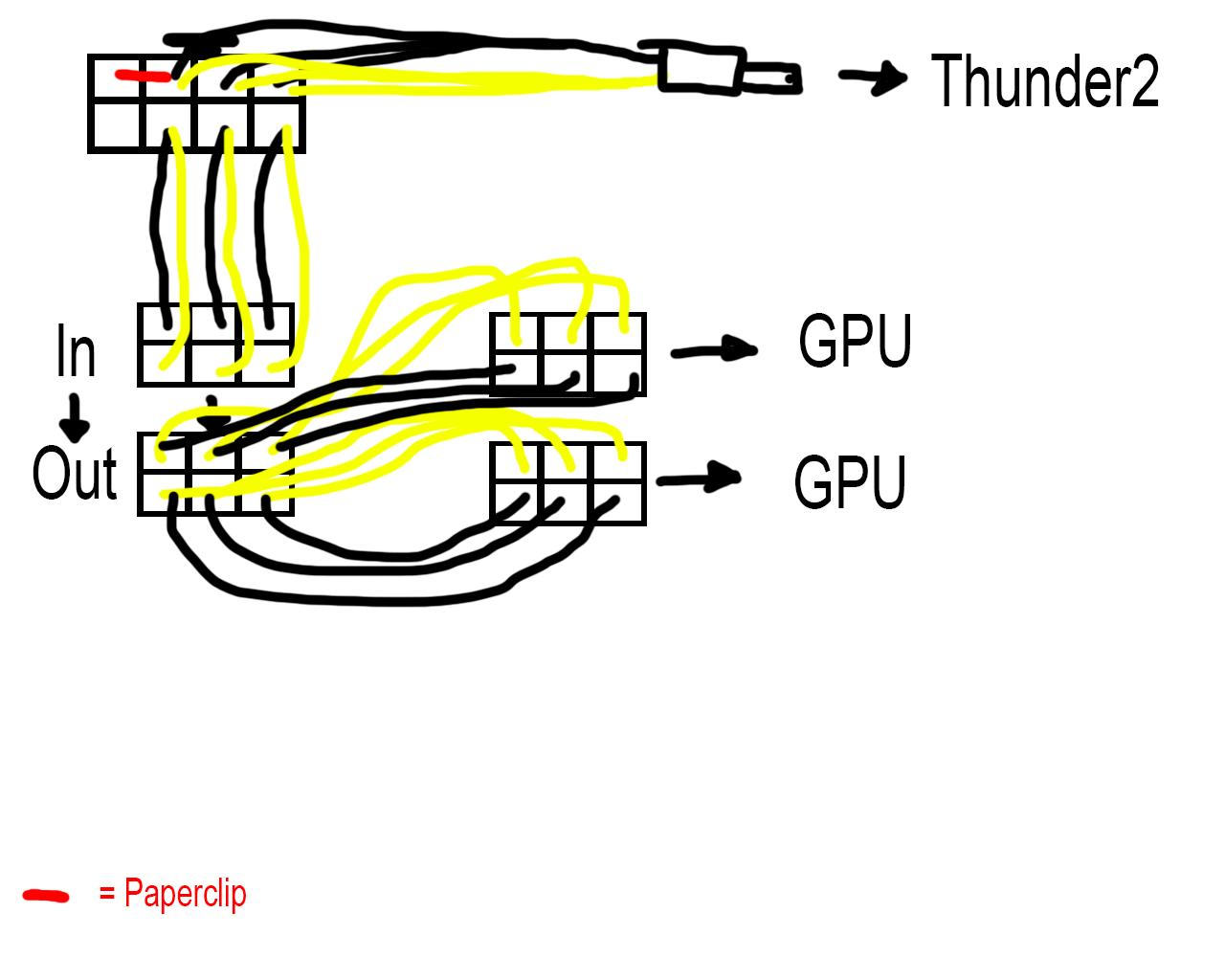

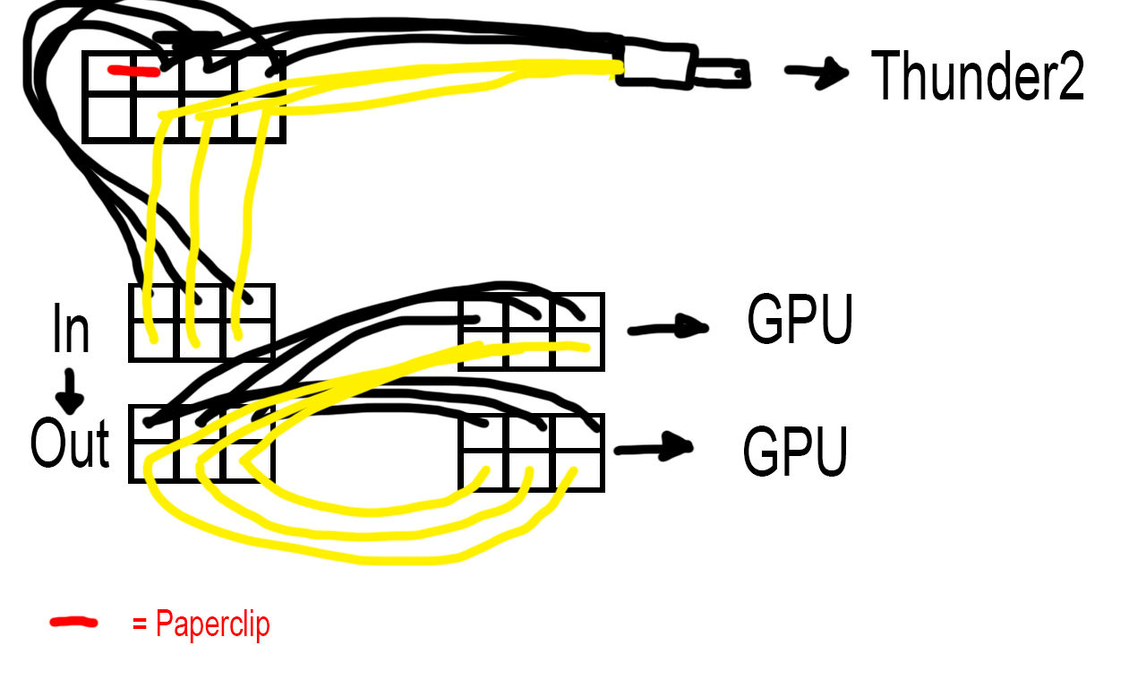

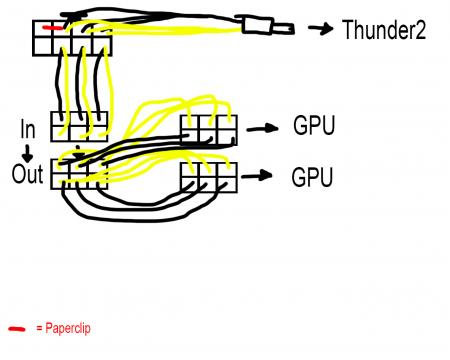

Thanks for this! Just to be clear, this (my terrible drawing) is what you have done right?
*EDIT: Ignore the 2nd photo. Not sure why it's there or how to remove it!
