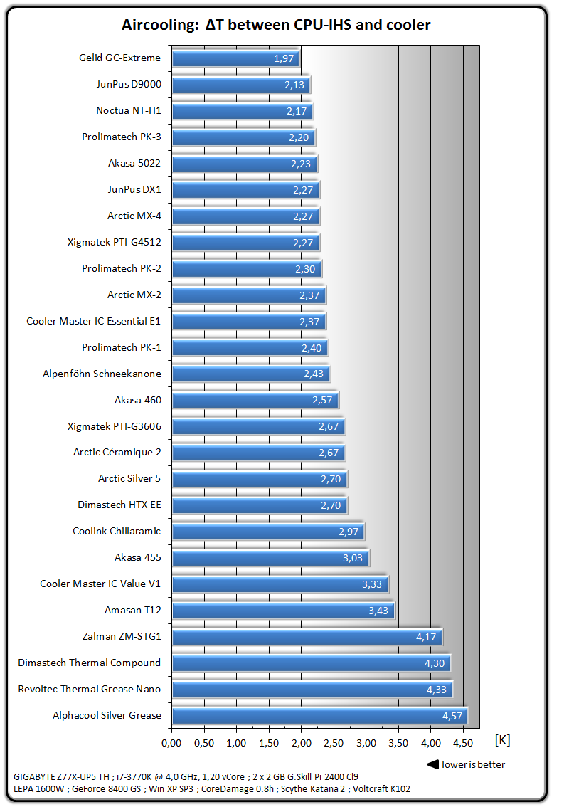

issdar Posted May 3, 2015 Share Posted May 3, 2015 There seems to be a thread on thermal compound roundup someone conducted already, I am surprised that Arctic Silver 5 performed so well considering its age I have heard that it is no longer good because of its age but still can hold up. Gelid CG Extreme seems to be the best non metal TIM. http://forum.techinferno.com/alienware/7460-tested-all-thermal-paste-range-best-them.html Quote Link to comment Share on other sites More sharing options...
