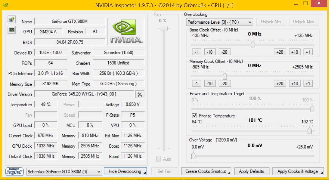

With today's new (non modded) stock 345.20 driver that allows for OCing:
With old stock shipping vBIOS OC works:

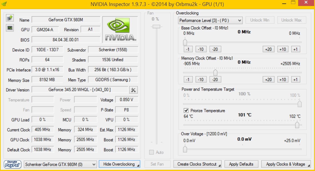

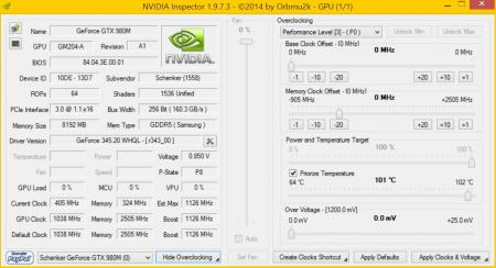

Same system with new stock shipping vBIOS core is locked:
[ATTACH=CONFIG]14218[/ATTACH]
The amount of fury and rage....
Is it possible to flash the other vBIOS on the new card to allow OC'ing? Or is there something restricting you.
You can flash the mod or a stock pre-lock vbios to get around the block. The scary thing though is that if nVidia keeps down this path, all new card launches will be locked with no bios to roll back to.
That's the same card, same system & same driver with old and new vBIOS flashed back and forth.
Upcoming GPU models like this one will no longer have that freedom as there are no earlier stock vBIOS with enabled OC.
