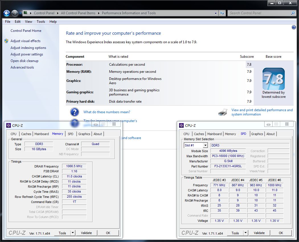

I did some more testing with the G.SKILL and substantially improved their lackluster performance by loosening timings for all but the tRFC setting.
Before and after benchmarks are shown in the quote below.
@Meaker - I took your advice and tightened up the tRFC. Could not get to 150 or below, but MUCH lower than default. After doing some benching and stability testing with tm5, that being tighter and other timings looser (what the RAM sticks are rated for) seems to produce better results. See comparison below. CL11 is faster than CL10 (probably because CL10 was silently experiencing errors).
