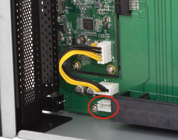

Edit: If you take a look at the manual of the OWC you can see that the internal looks pretty much the same, as the AKiTiO. Maybe they have the same supplier?!
Can't see anything of the supplemental power cable....

I think this one is very interesting if it does in fact have a power connector. That would make for a very compact and simple case that can be used with a GTX750Ti or maybe even a 960, without the hassle of external PSU's and modifications.
I agree. It has a free 4-pin power socket, which should be able to output nearly 75W (based on my tests of AKiTiO's 4-pin power consumption).
Would be interesting to know if they provide a 4-pin to 6-pin cable for that or a splitter from the PSU.
It’s hard to distinguish the markings of the AKiTiO 4-pin yellow cable, but it looks like 22 AWG, 80°C, 300V. If the outer chassis was a bit higher than AKiTiO’s, it would be possible to fit also non-low-profile 6-pin power plug. However, the manual says it’s the same 14.9cm (including the feed pad I guess).
EDIT: Hmm.. in pdf the enclosure is positioned differently - if it is indeed 14.9cm without the feet, there is more room (maybe extra ~5-6mm) inside for the 6-pin plug!
[ATTACH=CONFIG]13936[/ATTACH]
You've figured it out. A while ago I got some info on how the 25W slot limit could be extended. Originally the message didn't make any sense but now it does. The J6 plug is how they are splitting off a 120W AC adapter to feed PCIe power. So the OWC must come with a 4pin-to-6P PCIe cable. This from a AKiTiO engineer:
Re: Development for graphics applications
Message: The board is designed for a maximum of 25W on the PCIe slot, this cannot be modified. The only option for extra power to the card is with that 4-pin connector and a bigger power adapter that is plugged into the existing DC jack.
You mentioned that you have the skills to modify the circuit board yourself, so with this drawing, you should be able to add a 4-pin connector to the pins labelled J6 for extra power. You can then replace the power adapter with a more powerful one sufficient for 75W. Having said that, the maximum power must NOT exceed 120W and as you said earlier, the modification is at your own risk.
Yes, and the spots for C3 and C4 are on the board already.
Save yourself $100 and make the mod yourself.
What i would really like to know is what all the empty spots on the PCIE board are for. Two giant caps C12 and C13, a coil, some buck controllers, and a large power plug, all laid out but left off.

No 6P PCIe extension cable from the board is included or available from OWC
From http://forum.techinferno.com/diy-e-gpu-projects/7910-diy-egpu-macbook-experiences-77.html#post132715
P.S. I got a delayed message from OWC tech support about the power extension cable mentioned in the Helios manual. I had hoped that this cable would connect the Helios' mini-4 pin PCB-mounted connector to a 6-pin graphics card connector. It turns out there IS a cable included, but it has a SATA connector at the other end, not a 6-pin. Guess the Helios doesn't offer much advantage for those looking for a plug-and-play closed-box eGPU option, unless you want to wire up your own internal connector cable.
Maybe the following could be (or is) the reason why there is no 6P PCIe expansion canle included.
It is not wise to get so much current over these JST connectors.
Their max current is about 3A (<40 Watts).
Due to the small contact surfaces there is the risk that the housing melts when you will pull more

A small incongruity:
http://forum.techinferno.com/enclosures-adapters/7205-us%24189-akitio-thunder2-pcie-box-16gbps-tb2-120.html#post129670
1) “By spec the x16 PCIe slot is capable of 75W power while the x4 is spec’ed at 25W..”
The board is designed for a maximum of 25W on the PCIe slot, this cannot be modified. The only option for extra power to the card is with that 4-pin connector and a bigger power adapter that is plugged into the existing DC jack”
2) power goes through the 4-pin JST 3A connector -> TB card -> x4 (max 25W) -> x16. As far as I know, there is no other route.
3) “For the eGPU application, users do not connect anything else to the Thunderbolt daisy-chain. In such case 10W for the Thunderbolt circuits should be enough and there is 50W to the PCIe card. In order to support 75W power to the PCIe card, users can simply upgrade the power to 90W or larger.”
Did he meant only PCIe cards that draw max 75W total, including 4-pin auxiliary power connector?
Nando’s reference about 22AWG was 7A, but it's for copper: “The following chart is a guideline of ampacity or copper wire current carrying capacity”.
American Wire Gauge table and AWG Electrical Current Load Limits with skin depth frequencies and wire breaking strength
“A commonly used rule-of-thumb for converting the two conductor metals is to have aluminum two AWG sizes larger than copper for equivalency.”
How to Convert From Copper to Aluminum Conductors
Two AWG sizes larger would be 24AWG 3.5A = 42W with aluminium, matching closer JST XH specs.
Anyhow, my energy meter showed numbers from ~30W to max ~60W from the x16 slot depending on the GPU. I don’t know what would happen if I use a GPU consuming that 75W from the x16 slot? No melting seen so far... I am still a bit confused.

If you do power budget calculation based on the 120W AC adapter then we have:
- 75W PCI slot (max)
- 10W TB circuitry
- leaving 35W available for a PCIe power connector
35W is under your suggested 40W limit.
I could see AKiTiO/OWC deliberately not including the 6P pigtail connector to prevent exceeding their safe operating limits. For instance, say a user adding a 150W AC adapter and then attempted to draw 65W to their 6P connector. That would give an unsafe situation.
The AKiTiO engineer I was in contact stipulated to not exceed the 120W AC adapter input.
So a 75W GPU should be fine at any time right? By that I would assume that we can run a GTX 750Ti in
- a OWC Mercury Helios
- a AKiTiO Thunder2 with a e.g. 120W PSU (of course using less)
And if I would solder the 6-Pin PCIe plug directly to the PCB at the power input port, that would fine as well to run a bigger card with less than 150W TDP.
Is there any limit of that barrel plug for safe usage?
I would suppose that power is splitted equally:
- max 45W (PCIe x16) through the x4 spec'ed 25W
- max 30W TB circuitry (Apple/Intel requirement, when two TB ports in use)
- max 45W (auxiliary 4-pin JST connector)
= 120W
Still cannot understand that they said: “The board is designed for a maximum of 25W on the PCIe slot, this cannot be modified.” and it would be fine to draw 75W through the x16 slot. The power goes via that 4-pin cable as we know. They were speaking about PCIe cards, not x16 slot power consumption if we are precise. Damn :D
