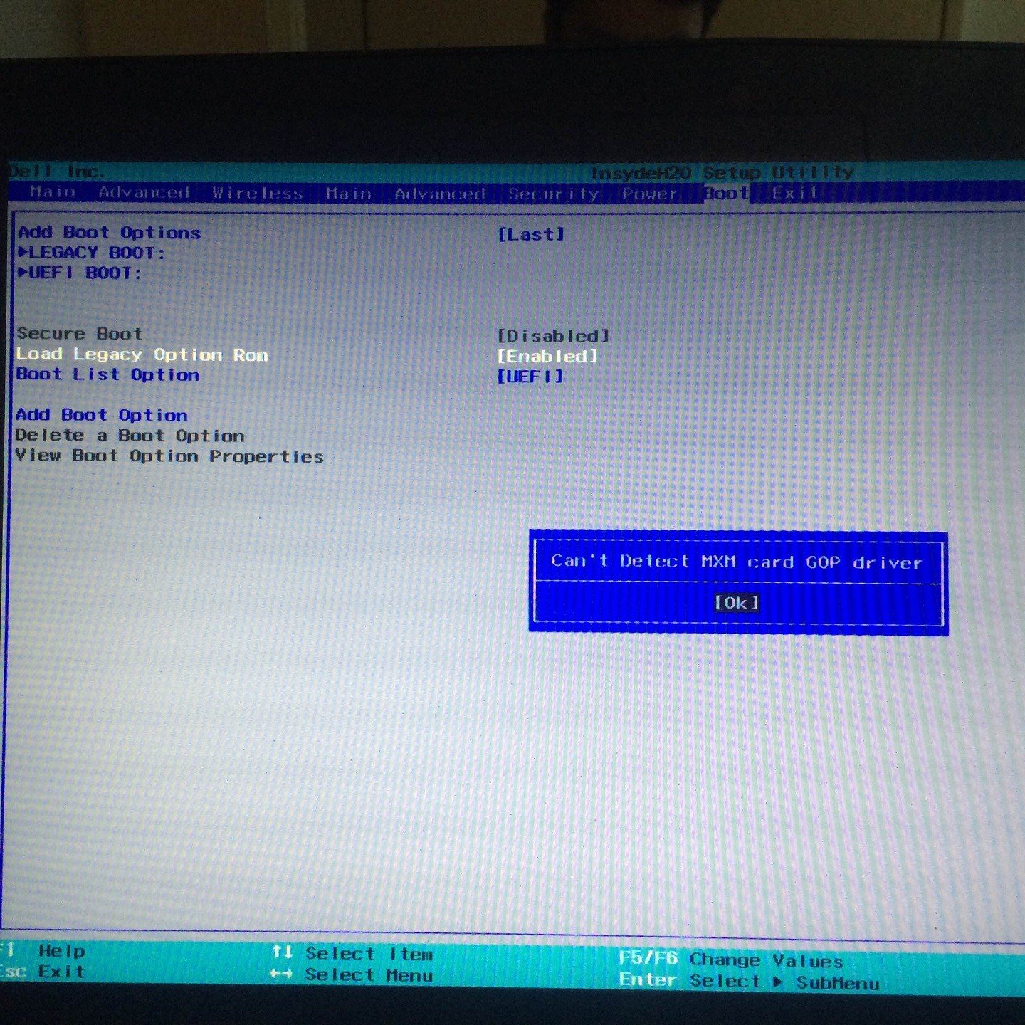

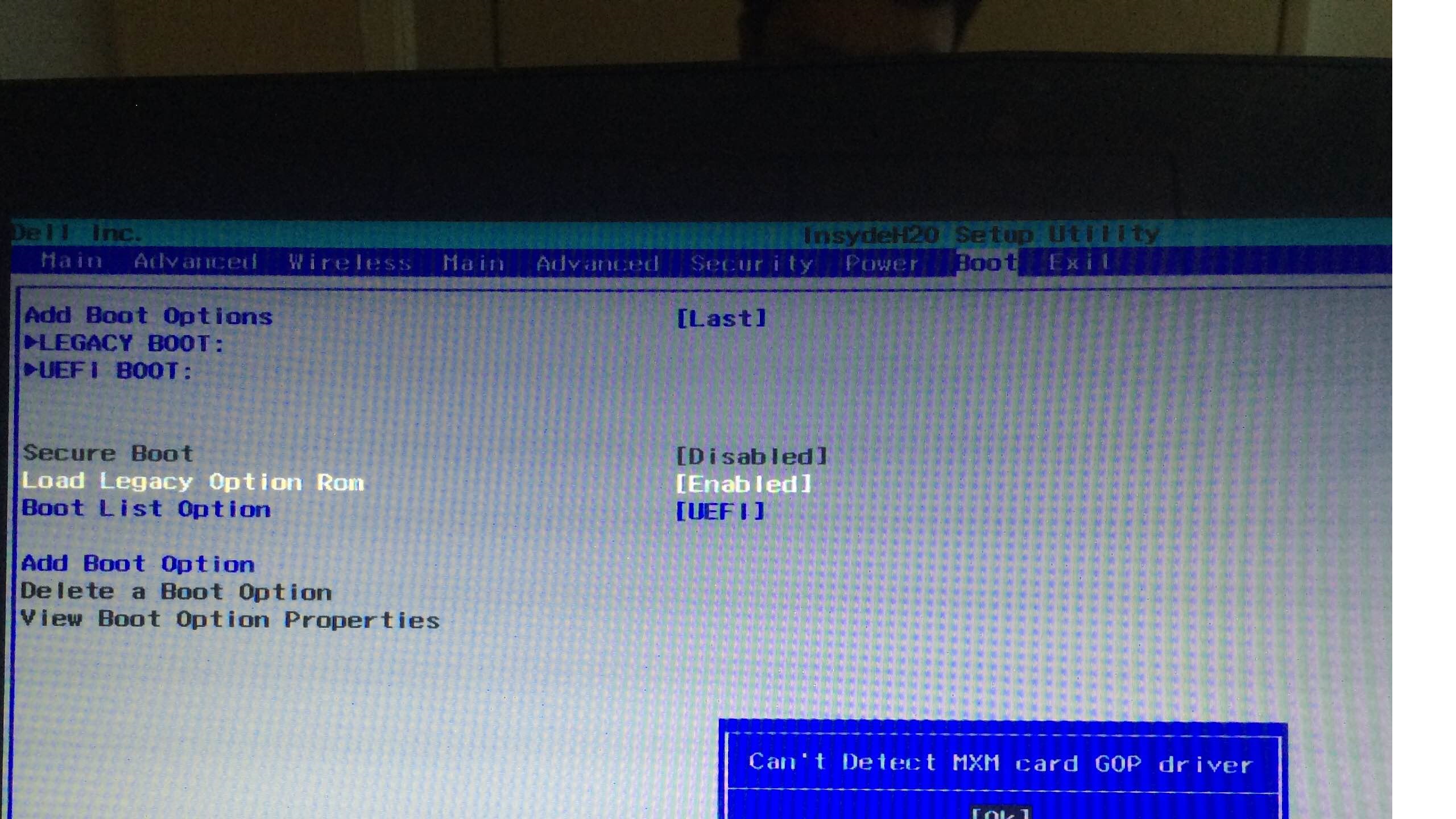

I recently purchased the 970m for my alienware m17x r4 but doesn't POST and I get 8 beeps when booting. Besides, there's is no integrated graphic card detected.
I read that I need to have UEFI enabled and legacy room DISABLED.
I cannot disable legacy room in the bios (A013): "can't detected mxm card gop driver"
I tried to flash the bios and I looked at this thread: http://forum.techinferno.com/alienware/2658-%5Bm14x-r2%5D-%5Bm17x-r4%5D-%5Bm18x-r2%5D-uefi-fast-boot-secure-boot-gpu-issues-*solved*.html
But there's no version for the 675m card.
Which means that I have no solution for my problem and that I have to return the card to the seller?
Please help me guys thank you.

I got the A11 instead of the A13. But still cant get legacy room disabled.
Hoping someone could help me on the next step to follow

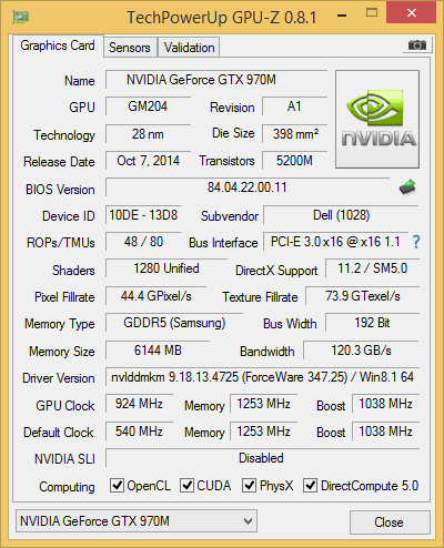

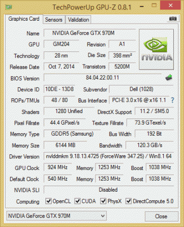

Installed the new card 970m after flashing the bios, still without success... keep getting 8 beeps
the vbios version on the card is 84.04.22.00.11
don't know if it helps.
cheers =D

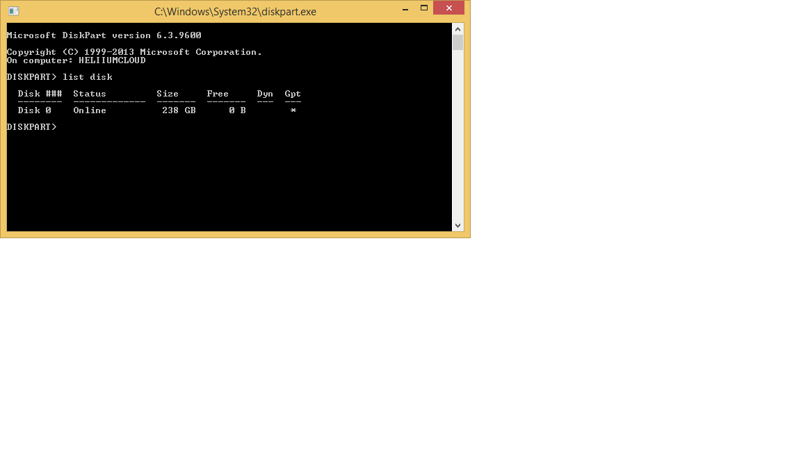

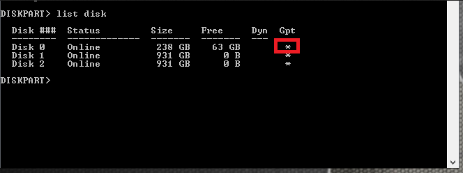

@heliumcloud
Search -> diskpart -> list disk. Post result
Primary disk GUID Partition Table/GPT?

That's exactly what I did... I deleted all hard disks and partitions and reinstalled windows and all driver on my ssd...
You have to use UEFI Boot up!!!
Otherwise you'll hear those disturbing beeps :D

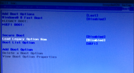

Try disabling legacy option rom using 675M.
Power off -> unplug power cord & remove battery -> Hold power button for 30 seconds (power drain) -> remove 970m -> Insert 675M -> Plug power cable -> F2 -> Boot options "disable Legacy option rom" disable "Fast Boot" & keep "secure boot disabled" -> F10 -> F2 Enter the BIOS & shutdown -> again, unplug power cable then hold power button for 30 seconds -> remove 675M -> Insert 970M -> Plug power cable -> Power on -> F2 -> enter the BIOS & Shutdown -> re-insert battery -> boot normally.
Edit: If the above fails -> 675M installed -> Set UEFI to Legacy without rebooting then set UEFI back -> disable "Legacy option rom" disable "Fast Boot" "disable Secure boot" -> Exit menu -> Save without exit option -> shutdown -> re-insert 970M.
The problem is that when you disable "legacy option rom" by default it enables "Fast Boot", which requires the UEFI/GOP driver...

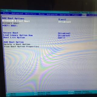

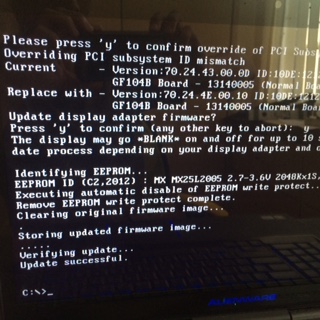

I added the 675m VBIOS to the mentioned thread: http://forum.techinferno.com/alienware/2658-%5Bm14x-r2%5D-%5Bm17x-r4%5D-%5Bm18x-r2%5D-uefi-fast-boot-secure-boot-gpu-issues-%2Asolved%2A.html
Maybe I should make a bios with the necessary settings saved as default values, then a bios reset won't mess up things...
  • Thumbs Up 3
Great idea...UEFI/GPT after a BIOS reset it defaults to UEFI/Legacy option rom.

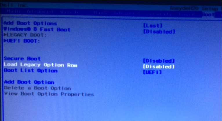

Hey guys,
Just now I was able to flash the vBios of the 675m! I chekced in the Bios and now I can disable windows 8 fast boot and legacy rom:chuncky:
Now its time to try and install the 970m card. I will keep you updated.
Thank you very much
