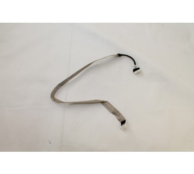

Yes, this is how 686016-001 look like (the HD version):
As one can see, no 40pin rail in there, that's what brought up the confusion.
LVDS 40pin is exactly defined, so I wouldn't worry about different pinout, but the connector can be positioned so that it's impossible to fit it in with HD cable.
LCD Cable, more specifically 686018-001 is quite expensive as well ($28 on Aliexpress). Also my primary concern was to avoid disassembly of the laptop base (considering it's still covered with warranty)
