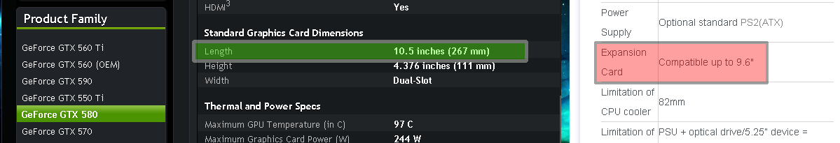

Arbystrider 30 Posted August 12, 2016 (edited) For those wondering why the Silverstone SG01 is not listed in the OP: (Left: geforce.com page for the GTX 580. Right: Silverstone's page for the SG01) Sigh. And I thought I could snap up that SG01 that just went on sale on a local classifieds for $10 and stop having my eGPU be mounted in an open plastic basket with zip-ties and power cables hanging everywhere. That said, there's no reason the SG01 wouldn't work if you were using a short card. EDIT: Can anyone who has an SG01 answer this: What is preventing longer cards from being installed and could you just saw it off to make more space? Edited August 12, 2016 by Arbystrider Quote Share this post Link to post Share on other sites

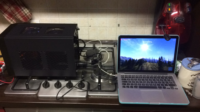

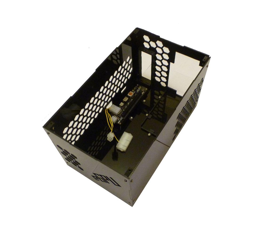

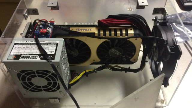

Way 0 Posted November 15, 2016 Hi to everybody, I made a case for EXP GDC Beast adapter that can fit in ATX power supply. To made it, I used 3mm Plexiglas and parts printed on my 3d printer. Case is very solid and allow to hide all cables from eGPU. I use GTX580 3GB Windforce connected to my old HP 8440p. GTX580 is very good priced card for making renders- I'm not playing games, just using it in VRay. If anybody want to make this case, or make something similar, I published all files on thingiverse: http://www.thingiverse.com/thing:1893913 Quote Share this post Link to post Share on other sites

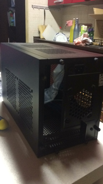

El_Febio 2 Posted December 9, 2016 (edited) hi guys, I've just updated my config from the plexiglass handmade one to a clearer Inter-Tech GmbH - ITX SY-800, you can see both in the pics. One question only, I used a powered riser, and forgot completely to consider the space occupied by the riser curve, so temporarily I fixed the gorgeous JetStream 970 with three firm, affordable, cable ties. It is locked, but I can't access the back outputs and it's quite ugly respect to the rest, imho. Would be a problem if I add a 90 degrees pci curve? Should I have to change the riser? Is it mandatory to have the molex power? Thanks in advance and hope you like my work. EDIT: about now I can't find powered angled risers "in the direction I need". So the chances are - no power angled riser - powered riser + passive curve which one is less performance draining? Edited December 9, 2016 by El_Febio Quote Share this post Link to post Share on other sites

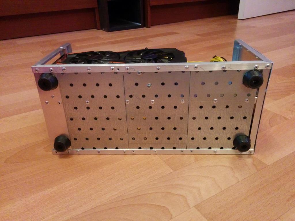

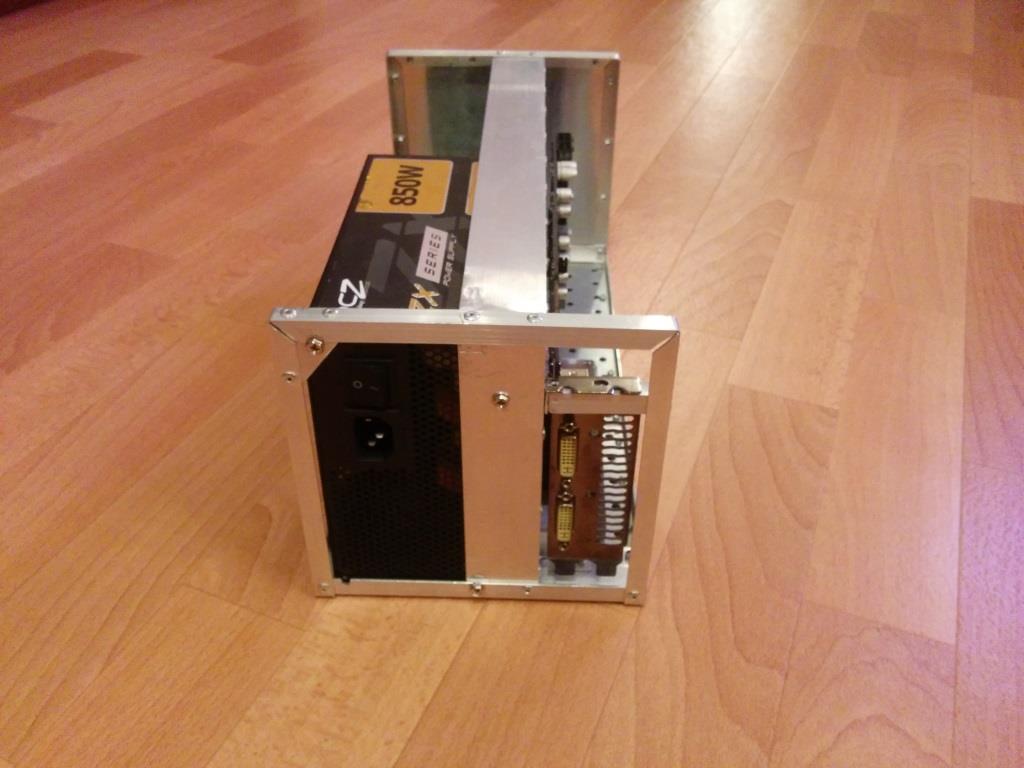

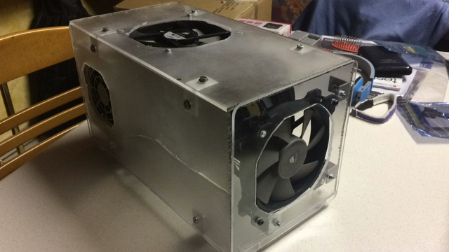

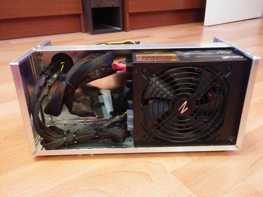

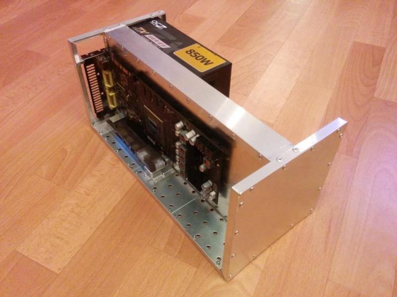

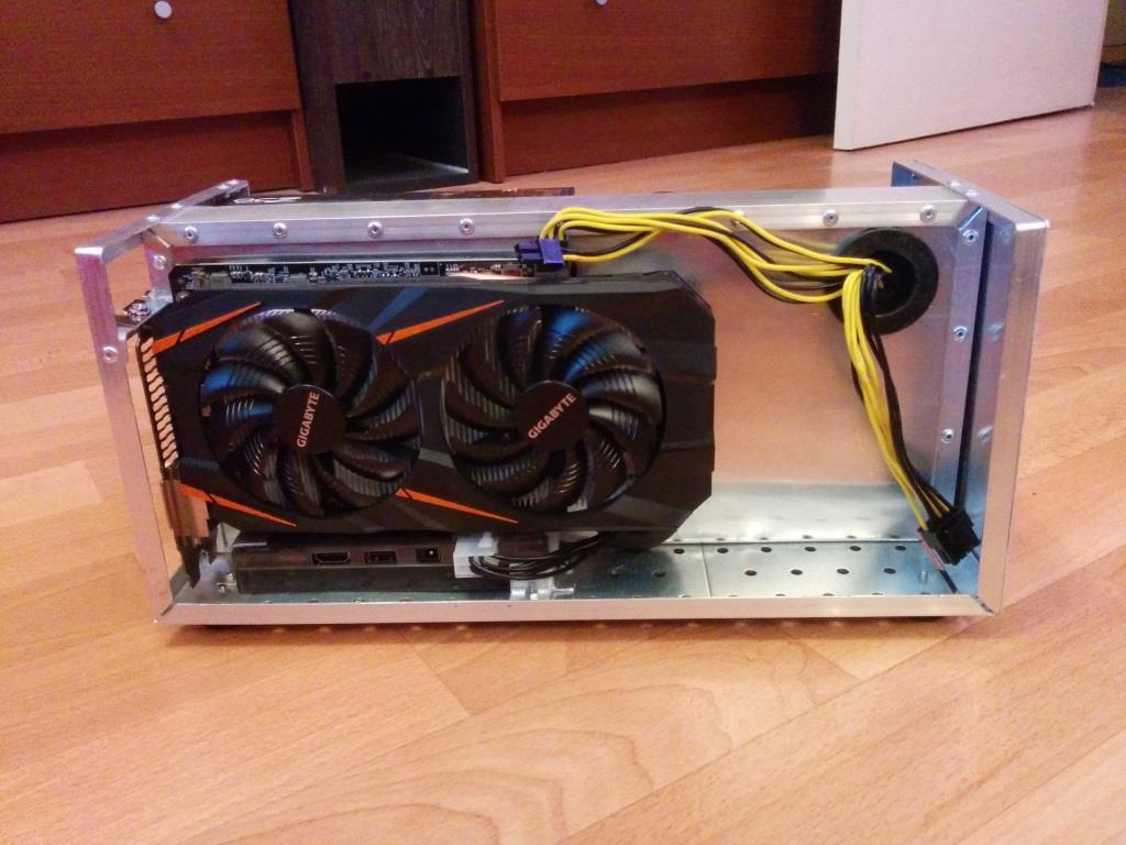

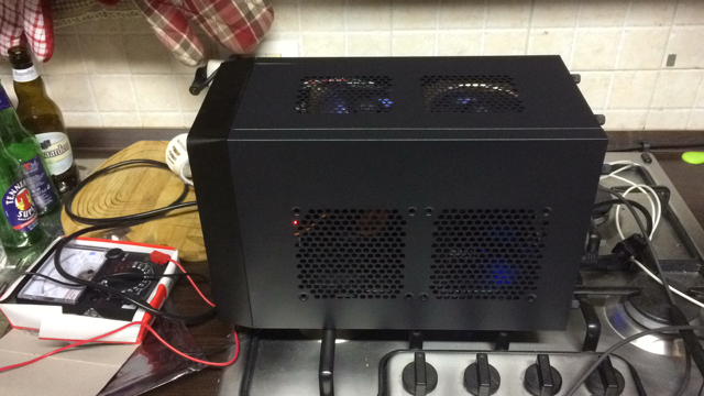

giv 11 Posted March 3, 2017 Hi guys! Here is my case for EXP GDC v8.3 fully hand made from aluminum. All i need is to make cover and then paint it with black color. The sizes of this case are: 350mm *160 mm * 160 mm. All cases that i saw before has two critical lacks - you need to place somewhere PSU for your eGPU and use small size videocard. And i decided to make all-in-one case in which you can put any standard PC PSU and GPU (even long size, about 330-340mm) together. So i wanted to make it universal. (here are 5 photos, and two of them with GPU without a cooler were made much more earlier and i poste them for you can see my case in perspective). 1 Quote Share this post Link to post Share on other sites
