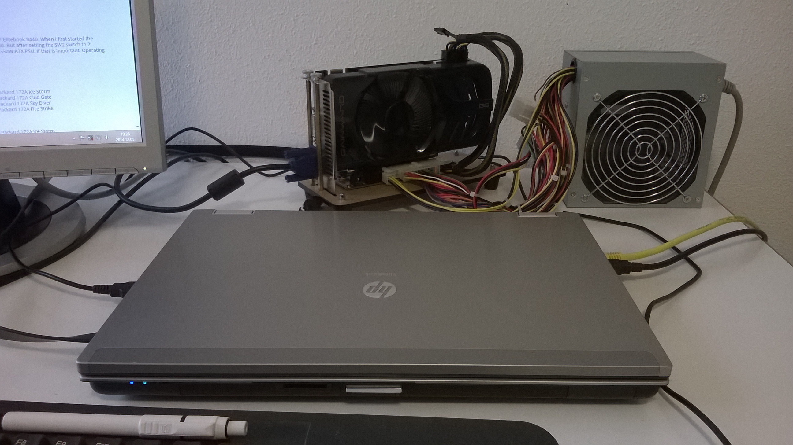

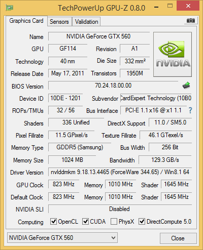

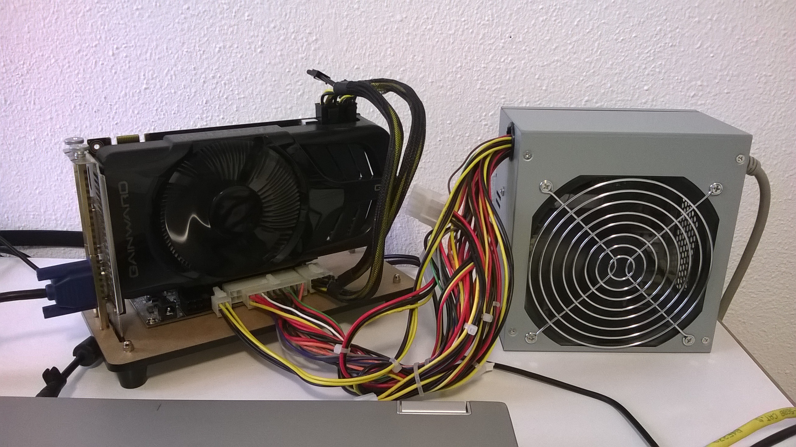

Hi to everyone in this forum!

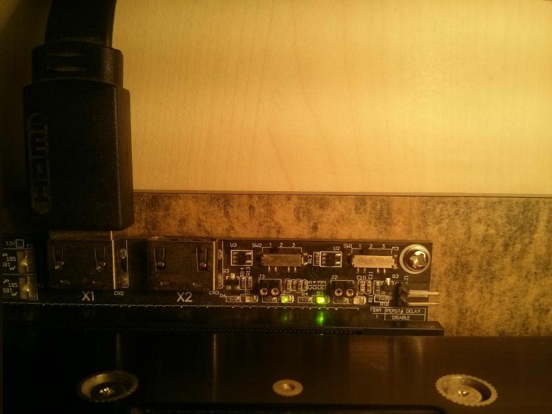

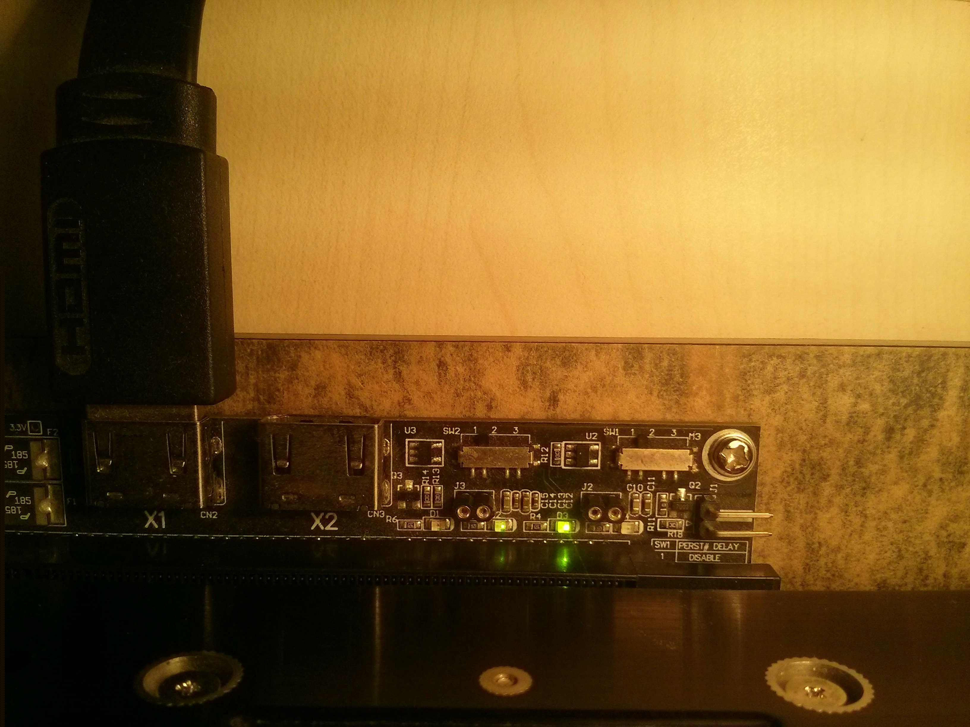

I just built my egpu system with the new PE4C V2.1 and i want to share my experiences. I have a HP Elitebook 8440. When i first started the system with the egpu attached (single x1 with the express card), i got a black screen, as lapytopy did. But after setting the SW2 switch to 2 (CLKREQ delay to 11.97 sec) i got a fine bootup. So no setup 1.x was required. I am using an FSP-350-60MDN ATX PSU, if that is important. Operating system is Windows 8.1 x64.

Though my PSU seems to be not enough sometimes for these benchmarks, considering my GTX 660 Ti has got 2 6-pin additional power connections, it is good up to 225W theoretically, my PSU is good up to 234W. I do not know how much power PE4C requires, but I think it's time to replace my power supply.
hello could help me please. I have the code 12 on my HP 8440w ELITEBOOK and have the same components that you appointments. I do not understand is how you do this ... "after setting the SW2 switch to 2 (delay CLKREQ to 11.97 sec) I got a good start." .. I could help please
Sorry, I don't really know anything about the 8440W (though I think it must have an Nvidia graphics chip onboard), because I had a 8440p. Since then I sold my it, and both the GTX 560 and the 660Ti GPUs as well. The SW2 switch on my adapter has 3 positions. What I did then to make it work, I set the SW2 in the middle position, then plugged the express card in the 8440p, then started it. On the picture, both switches are in the 1st position.
