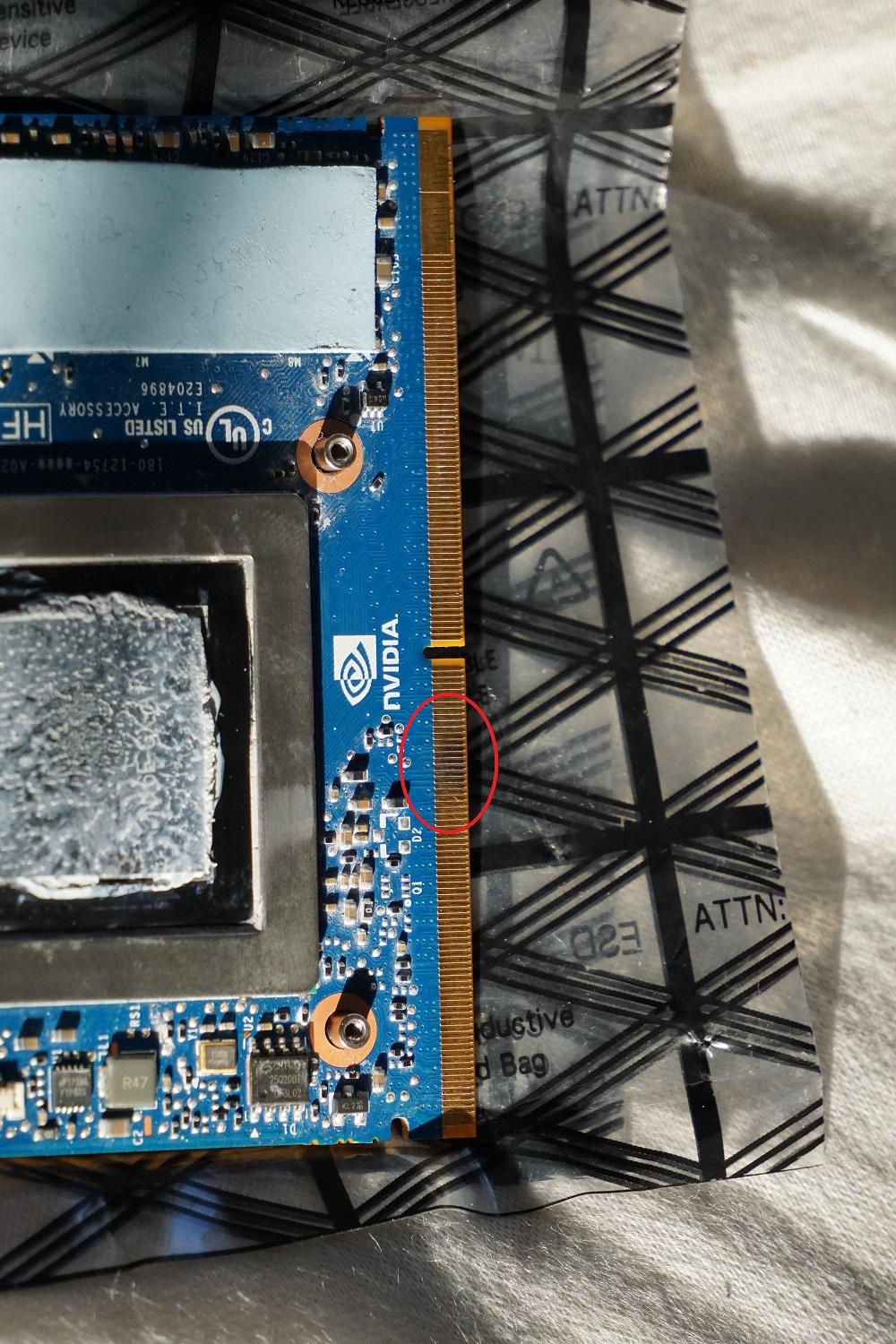

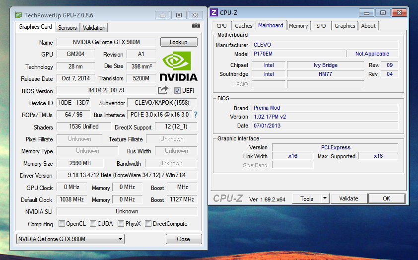

Hello,I was reading this thread carefully, but after all tries, I didn't manage to get the card running.
I removed the AMD drivers (via DDU) and mounted the new graphic card. Then, I successfully flashed the Bios as explained and updated the vBios of the 980M to 84.04.2F.00.79. After that, I installed the 347.12 driver as in this thread they seem to be the most reliable (followed by 347.52. I tried it both with unchanged and changed nv_disp(u)i.inf.
Now I wonder why it doesn't work. Do I have to update the EC as well? Is it the wrong driver?
If so, which file would I need to change in the newest (358) driver? I couldn't find a nv_dispi.inf over there. Or do I have to create a new disp(u)i.inf file?
And why does it show only 3GB? Is the GPU broken, or is it a bug?
I am asking that, because I bought the GPU on ebay from a user who wrote that he didn't succeed to get the GPU running in an Alienware (SLI) but both ran on a Clevo P650SG. And if it is broken, how could I check that?
I posted some screenshots below. Sensors of the NVidia don't work either.
System stats:Clevo P170EMi7 3840QM (@2,8-3,8GHz not OC | Intel HD 4000
24GB RAM
NVidia GTX 980M (AMD Radeon 7970M worked fine before)
Win 7 Professional 64bit
I hope that you can help me out somehow.
Update: With the 347.52 driver (I extracted the .exe with 7zip as I found no other way to edit the .inf), the GPU won't be recognized in GPU-Z.

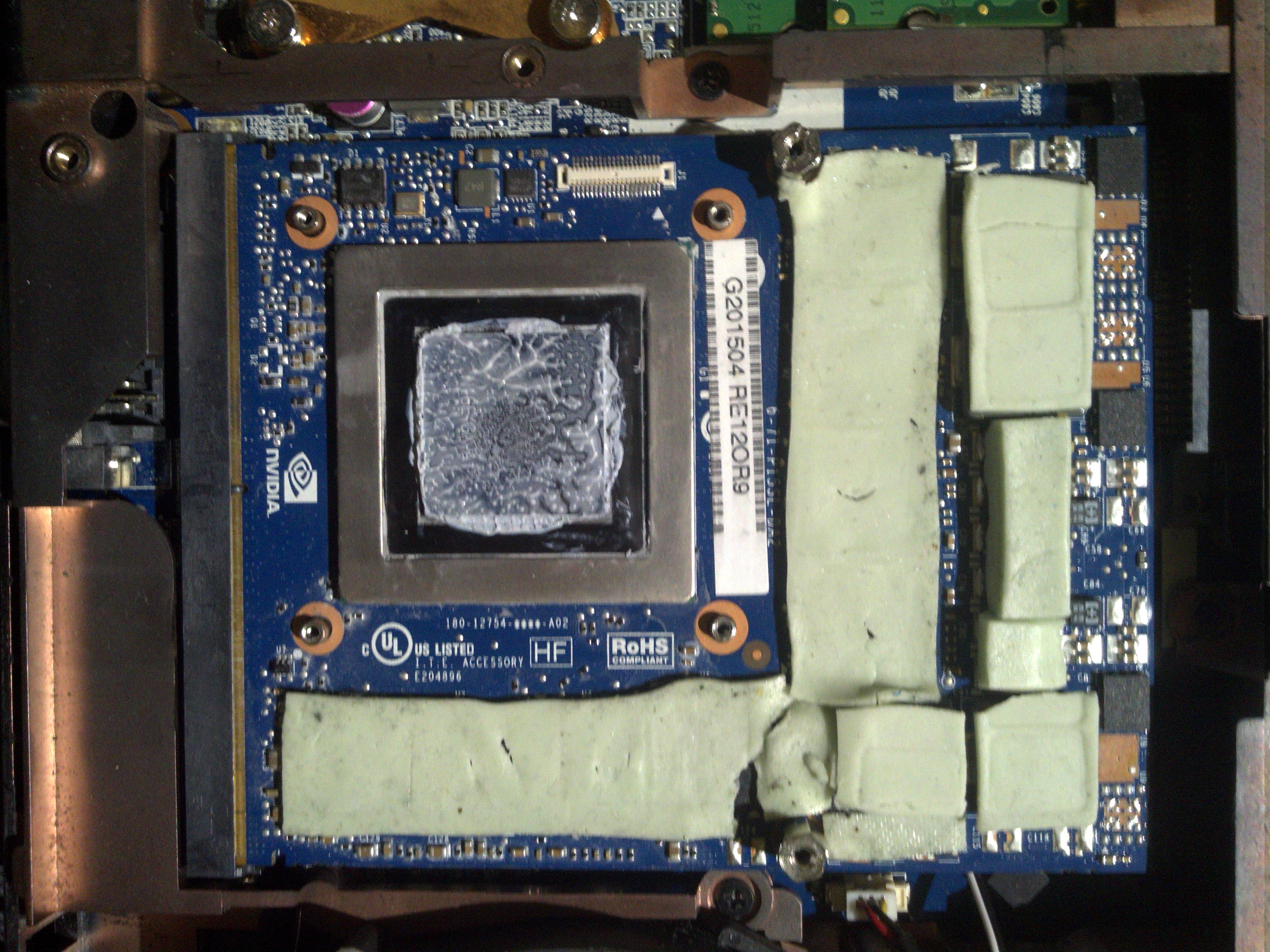

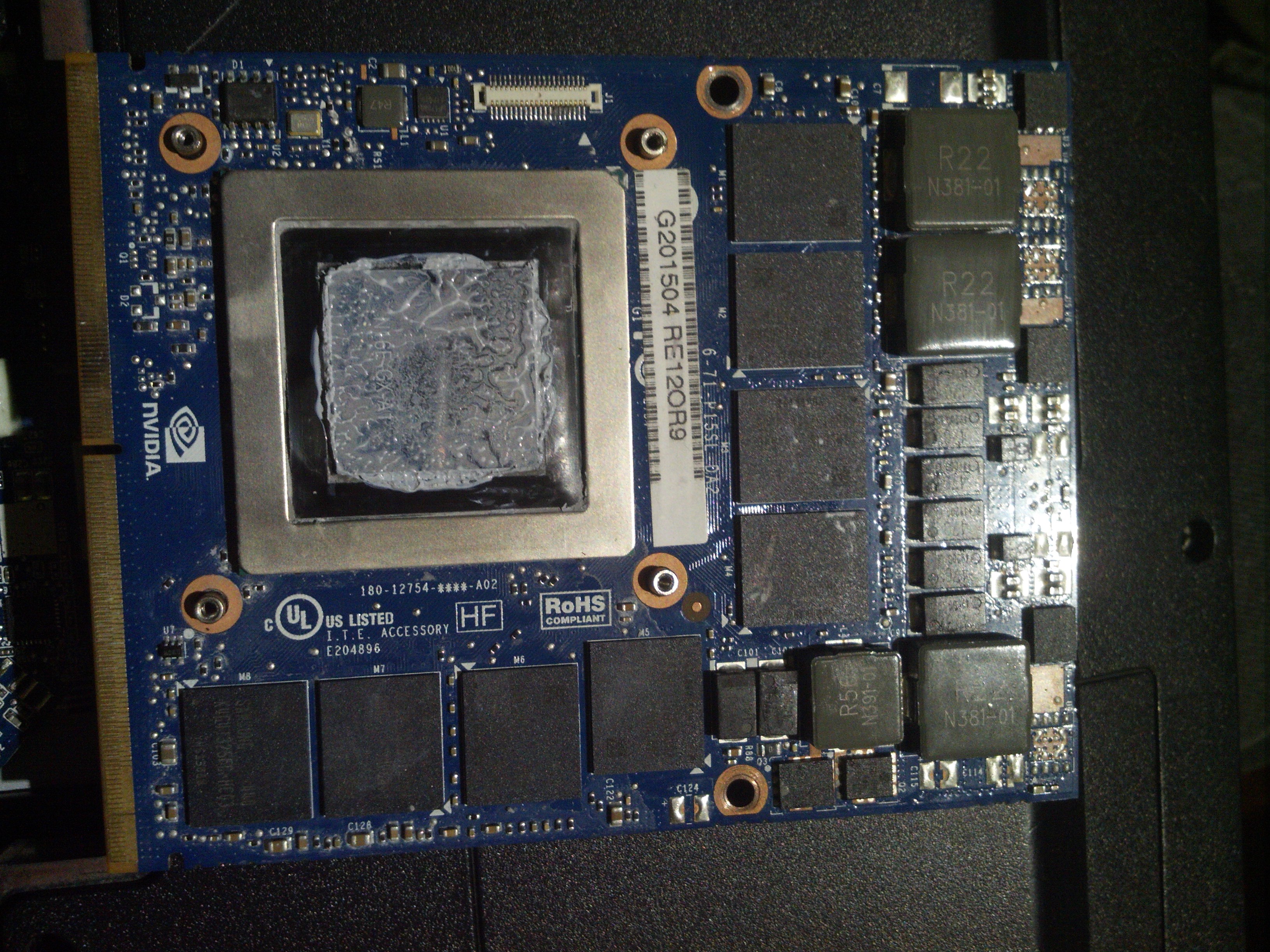

I'm sorry for my late response. Two days after the flash, my laptop started beeping and shut down automatically. I flashed the EC various times (power+battery off for 5 minutes + pressing the ON-key to make sure), but it didn't help.
I even reflashed Prema's Bios and reset the EC but it didn't help. I can't really imagine that this is the graphic cards fault as the notebook continues shutting down even without graphics card.
Anyways, the requested images:
With old termal pads (moved the AMD ones around)
Without thermal pads
I get Arctic Thermal Pads (0.5mm/1.0mm) tomorrow, so I can try it again with new pads. If you have recommendations, please go ahead.

Thank you for your answers. I am using my Radeon 7970M at the moment, because it shuts down eighter with the GTX 980M or no card at all (as Khenglish mentioned before).
While having the NVidia plugged in, the program NVidia Inspector shows nothing, it's all greyed out as if there wasn't any card existing. The Bios also shows an empty VGA-slot with the GTX 980M, but GPU-Z does recognize the card without problem (as visible on the screnshots before.
This happens without any drivers installed as the notebook shuts down too fast. So if the program NVidia Inspector needs drivers, that could be the reason for it.
Also, the last time I tried installing drivers, it told me that there was no compatible hardware on my computer, although it worked before (and GPU-Z recognizes the card).
What can I do now?

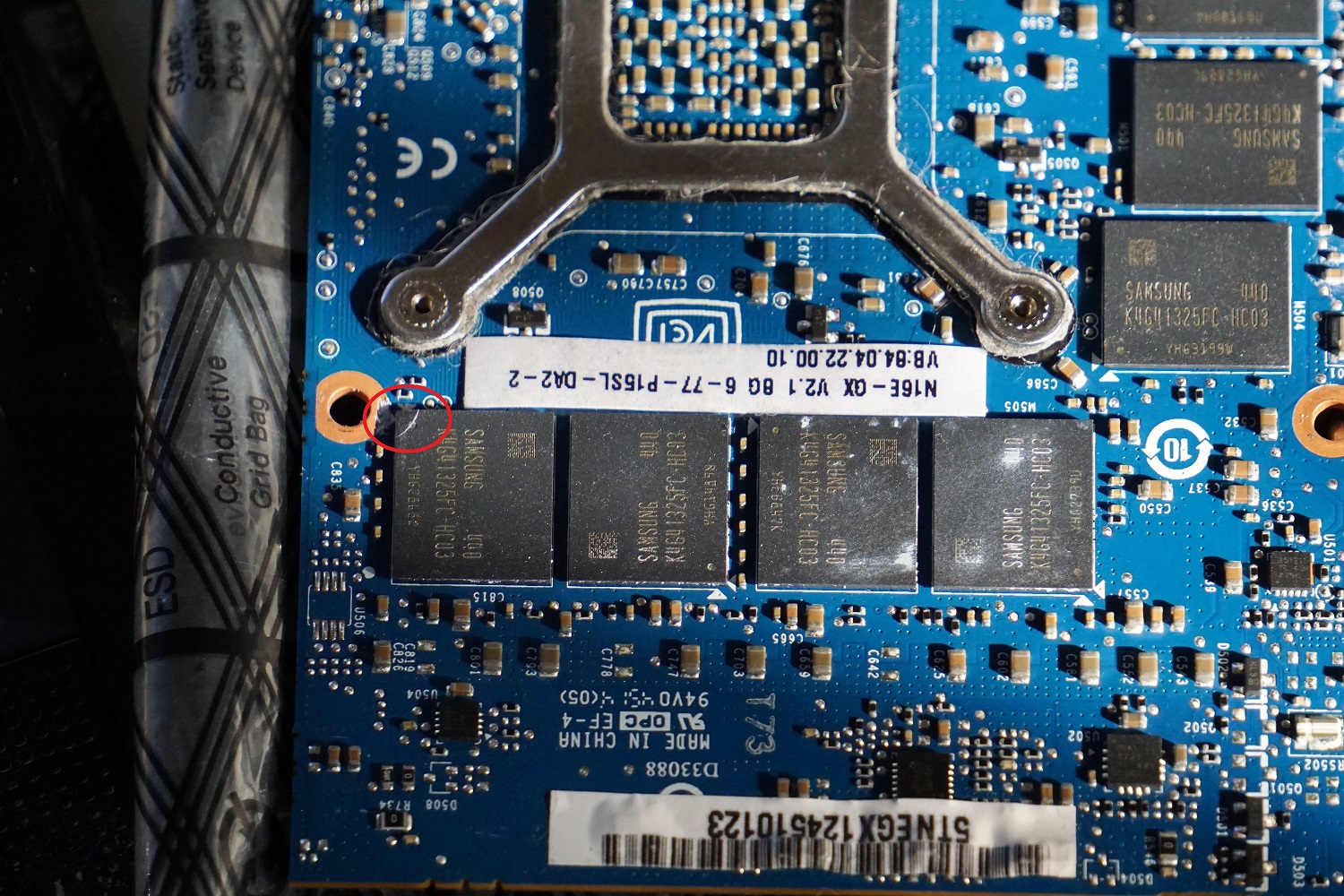

In the last week, when the forum was down, I checked the graphics card on broken/overheated parts and found out that one ram stick was broken at the side. Also, the entire graphics card is extremely dirty and some pins are not golden anymore but silver.
The seller says that it's my own risk when I buy something out of a private hand, although it was not declared before. I guess, I will open a case on ebay and send it back. If you have any recommendations to make it work anyways, please do tell me.

That's the Mod version...stock version is hosted under "Important" > "stock" section.
Those contacts look indeed a bit "smoked", maybe try to clean them...

So my current bios is version 1.02.17PM v2, the vBios is 84.04.2F.00.79 (see screenshots above).
Stormy mentioned before, that the versions seem to be fine. Can I do anything now, or is the card definitely broken?
