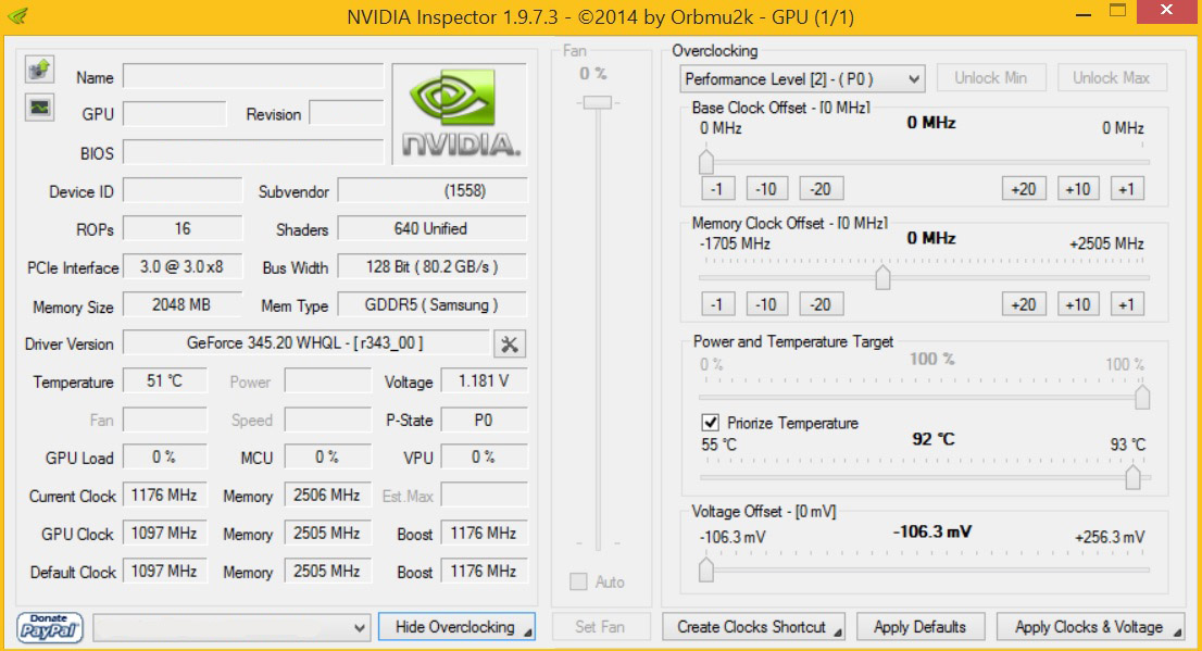

That's a Clevo (subvendor ID 1558) 960M. Picture caption even says "GTX9X0M.jpg" (GG Prema ;)). So it confirms 960M is a rebadged 860M with higher core clock. Old 860M boost is new 960M base. 79 MHz is a pitiful OC though.
Wow... I could puke... I thought the 960m would at least have more shader cores available (840 pipelines or so, just something in between 1024 cores (965m) and 640 cores (860m). Hope dies last. Hope died right now. Wanted to buy a new midrange laptop next month. Not anymore. Don't know what to buy. Certainly not that renamed crap of a 860m which is over 1 year old at this point. This is ridiculous.
And AMD has nothing to offer for competition, so Nvidia can just f*** around all they want. Nvidia f**** around with bad news until now and keep f**** around. Again... I could puke. If the mod is not publishing this comment because of swearing I would understand it. I am just so frustrated.

Yeah disappointing. A 768 or 896 shader GM206 would've been much better. Or even an underclocked 965M which is a halved GM204, similar to how 760M was an underclocked 765M. There's no reason to get a 960M now over an 860M, esp. if its vBIOS is clockblocked.
Exactly that. Similar to what happened to the 760m/765m, or a gimped down GM204... any of these solutions would have been better than the worst and cheapest of all: a slightly overclocked 860m.
Well they won't cut down GM204 any more than 965M already is, so it would have to be GM206 if it has fewer than 1024 shaders. I'm just surprised there is no mobile GM206 at all this gen by the looks of it.
