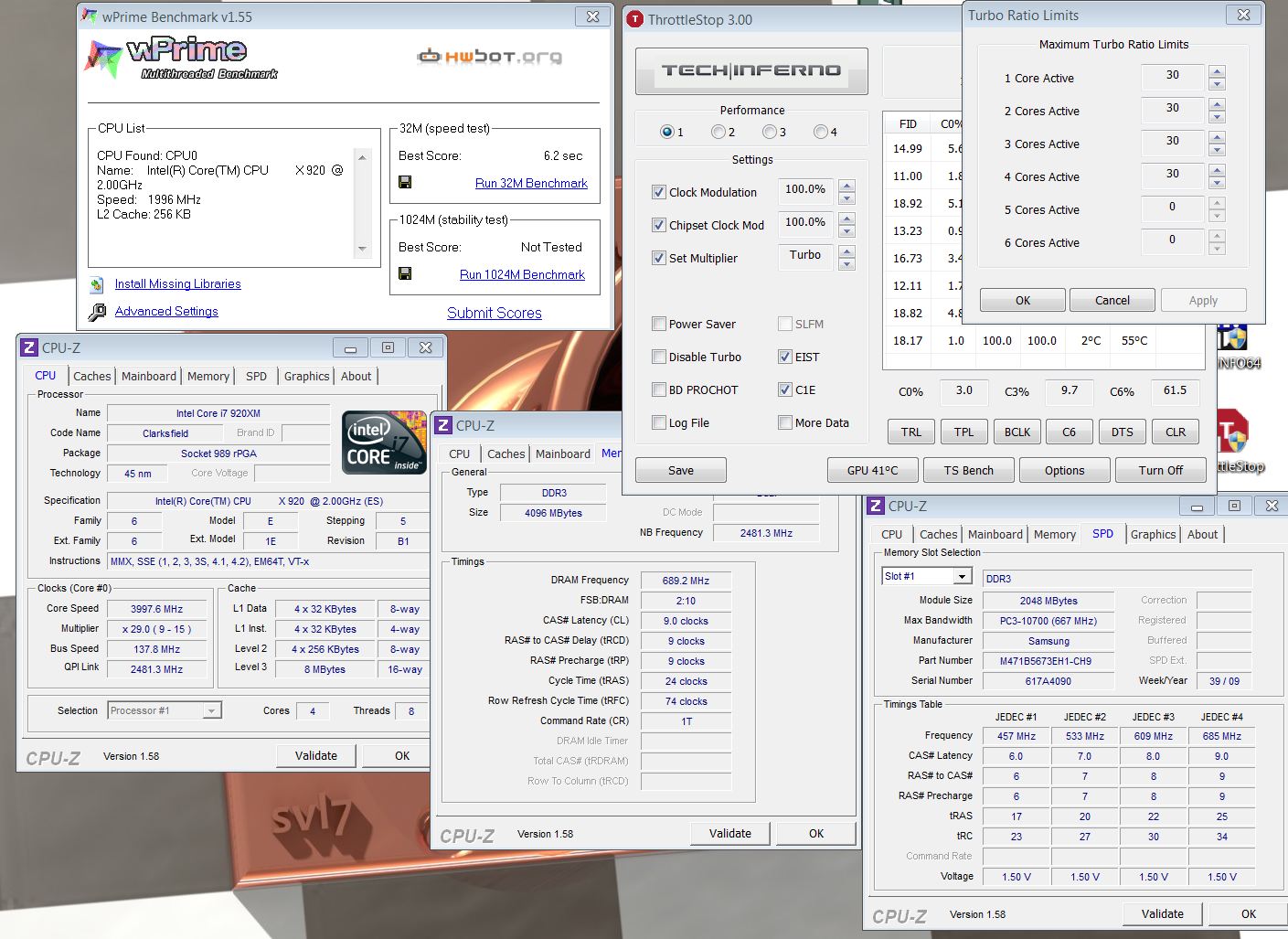

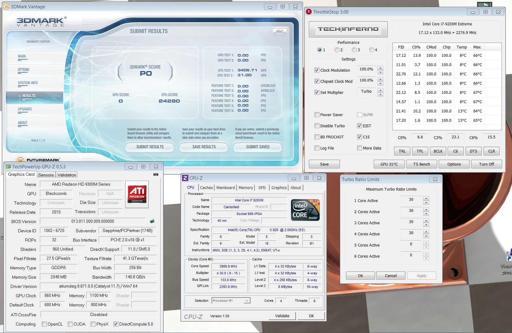

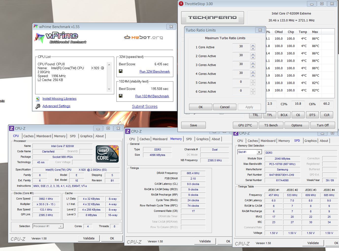

svl7 Posted July 27, 2011 Author Share Posted July 27, 2011 This CPU can really do crazy stuff when there's enough voltage and power (and cooling, lol): Vantage and the 1024M wprime were done at 30x, the 32M at 30x with a raised BCLK (137.8MHz). 3 Quote Link to comment Share on other sites More sharing options...

svl7 Posted July 28, 2011 Author Share Posted July 28, 2011 Thanks bro! I was hoping to crack 16k Vantage, but my GPU was always at 400/900... no idea why. Tried several drivers etc... haven't found the solution. Will investigate a bit, but for the moment I'm annoyed, was hoping for a cool bench session and I only had troubles. At least I managed some crazy CPU scores. Quote Link to comment Share on other sites More sharing options...

svl7 Posted July 28, 2011 Author Share Posted July 28, 2011 SVL7 did you know how close you are to DR650SE's 1024M score for wprime and thats with DICE... I bow to you lol!Well, my runs were with dice as well, no chance that I can run 30x with a 200mV core voltage increase without extreme cooling, would've melted my mobo. I tried to beat his 1024M score, but it's pretty hard to find a sweet spot with the BCLK, it always crashed halfway through the test. 30x without BCLK increase was very stable, no crash. 1 Quote Link to comment Share on other sites More sharing options...

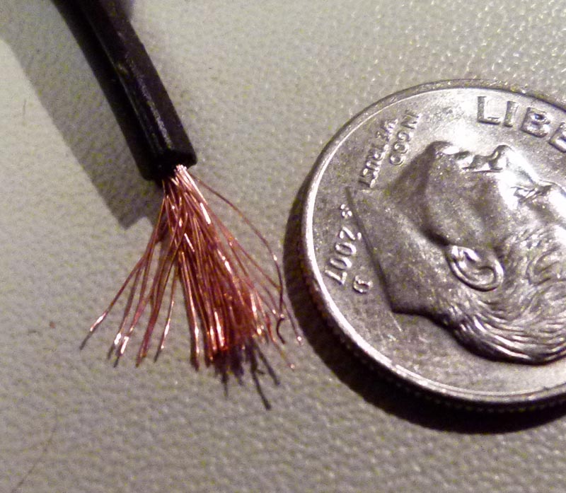

DR650SE Posted September 17, 2011 Share Posted September 17, 2011 Hmm, this would definately help me get some global boints with my 540M. I wonder if the solder wire I have is thin enough. Quote Link to comment Share on other sites More sharing options...
svl7 Posted September 17, 2011 Author Share Posted September 17, 2011 The thinnest solder wire I have is 0.5mm in diameter and that's definitely too big. Also usually solder wire is rather fragile, you don't want the wire to break when you insert the CPU. Quote Link to comment Share on other sites More sharing options...
DR650SE Posted September 17, 2011 Share Posted September 17, 2011 (edited) Yea thats what I was thinking about. It's very fragile. Where did you get the copper braid? I might be able to strip some CAT 5 line. If I can get this done, it will mean rerunning benchmarks on the 520M, 540M, and other chips. Not sure if the 540 will be an issue with heat, but breaking out the dice cup would be necessary for the 940XM.Just hit me, I can use speaker wire. I think essentially your just connecting the pins right? I mean when you jump the two holes, the socket still slides into place once the chip is locked in so essentially it appears your just jumping the pins. Edited September 17, 2011 by DR650SE Quote Link to comment Share on other sites More sharing options...
svl7 Posted September 17, 2011 Author Share Posted September 17, 2011 Where did you get the copper braid? I used a wire from a defective power adapter: It's copper, pretty thin, but much less fragile than for example solder wire. For the +200mV mod I used two pieces as you can see on the picture in the first post. The second time I used only one, works fine. 2 Quote Link to comment Share on other sites More sharing options...
