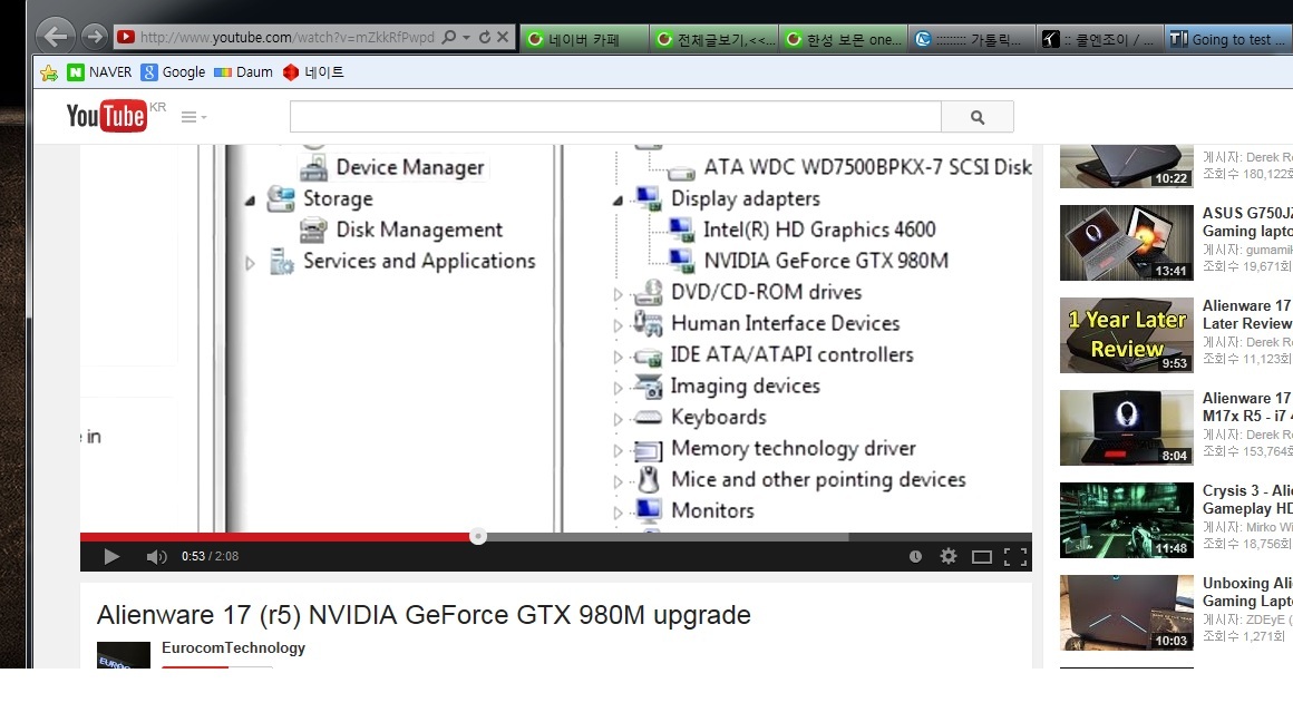

And here we have it.
Alienware 17 confirmed to work with GTX 980M :thumbsup:
Yeah you are right.
And as I told you they did with OPTIMUS.
0:53 of the video.
OKay?
This is called OPTIMUS.
I can't believe I am doing this man. I kept saying it works with optimus.

Yeah you are right.
0:53 of the video.
OKay?

I've asked Eurocom whether MUX function still works or not.
They said they will release guide on how to get the 980M to work on the AW17 in the video.
