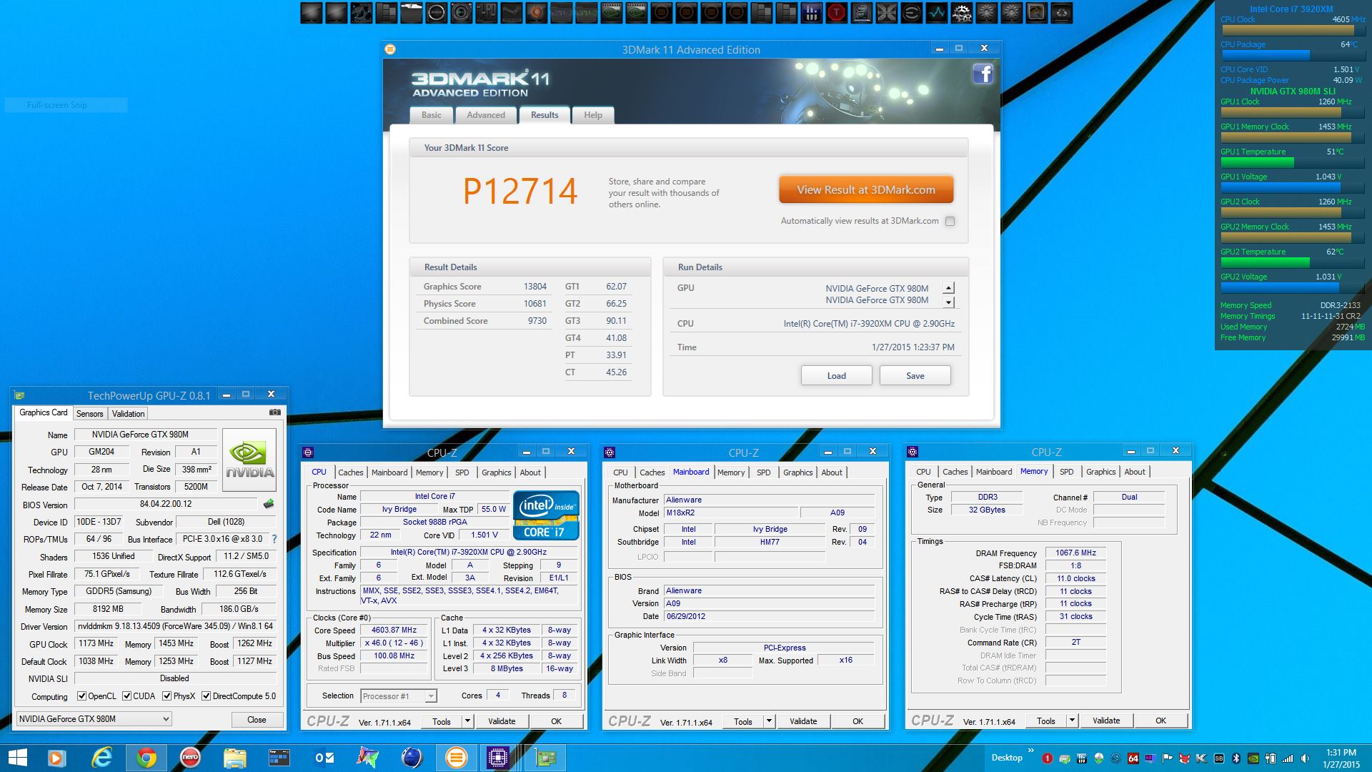

With SLI disabled, no throttling. Got P12691 in 3DMark 11. Will post a screen shot and link here in a bit, along with a photo of the max watts draw from the UPS.
Edit: ran it again and a little bit higher score. Didn't bother uploading it to to Futuremark because it won't win any contests with a stock vBIOS and +135 limit... good result, but not great for 980M potential.
