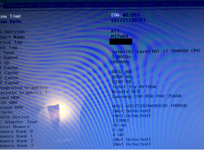

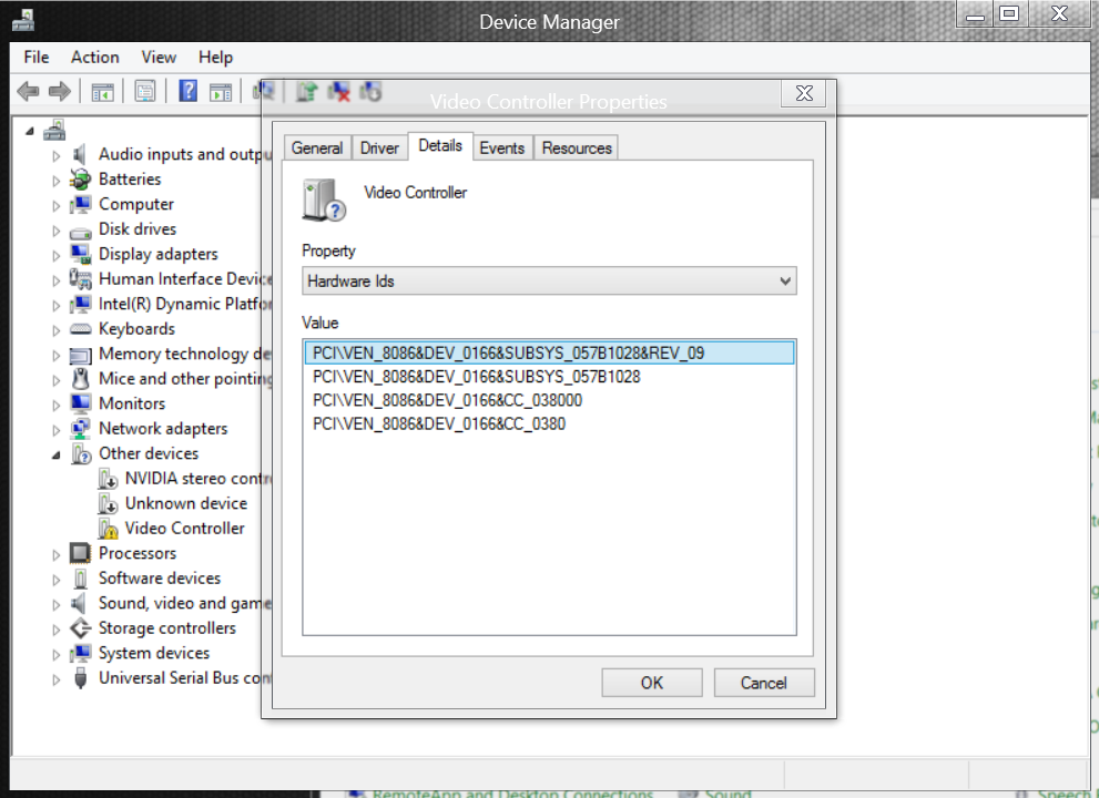

Hello everyone,
I have received my gtx 970m card today and I tried to install it in my alienware m17x r4. I guess the 980m and 970m have similar installation process. I made sure in the bios to have UEFI mode but I cannot disable the legacy. Everytime I do it it says that no mxm card is detected and put it back to "enable". The bios version installed is A13.
Is there anything I've been missing? Thank you for you help.
