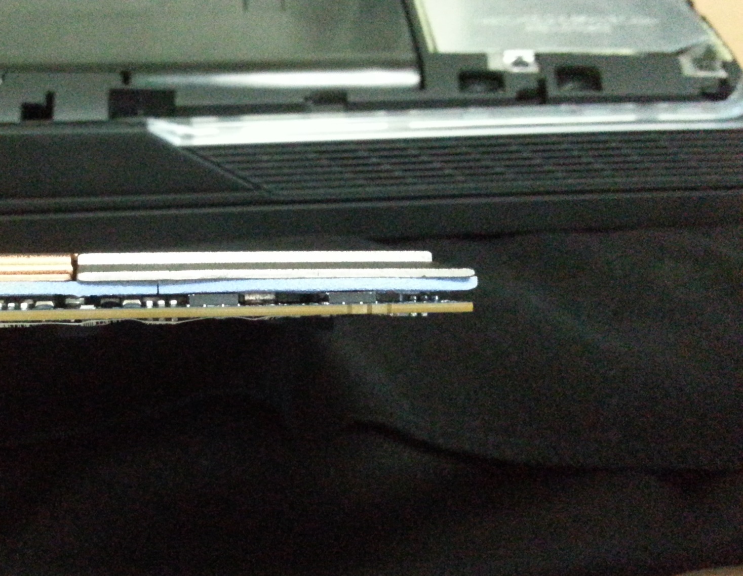

It will work fine! Compare the height of the die and PCB components. My last upgrade...probably not...;) vBIOS dump soon then...:D

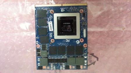

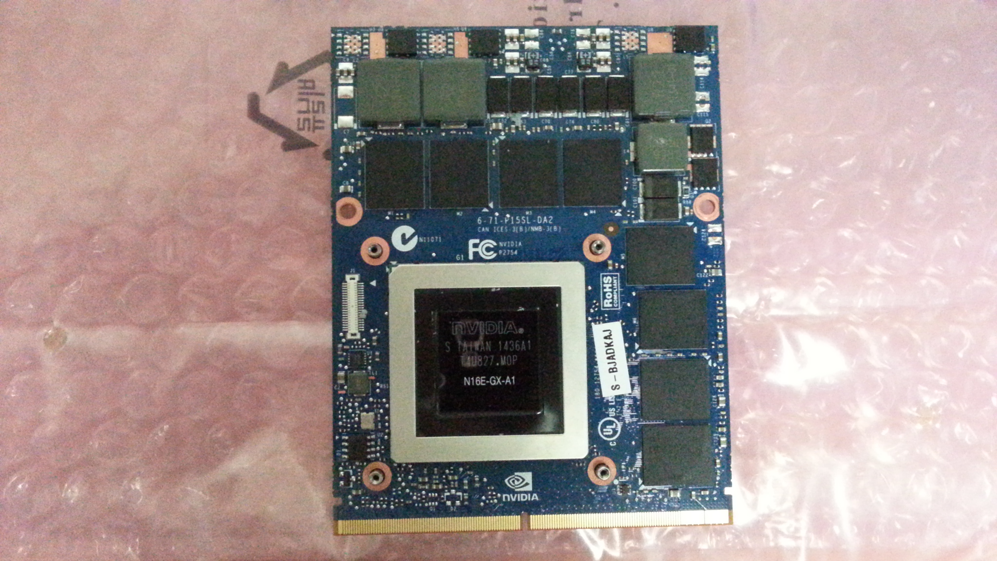

Okay, this is the 980m that they let met test.
It failed to post with m18x R2, m17x R4 and AW17.
So I am guessing that they sent me a gpu that was used for 2nd GPU of SLI.
Tomorrow they are giving me a vbios or a new card.

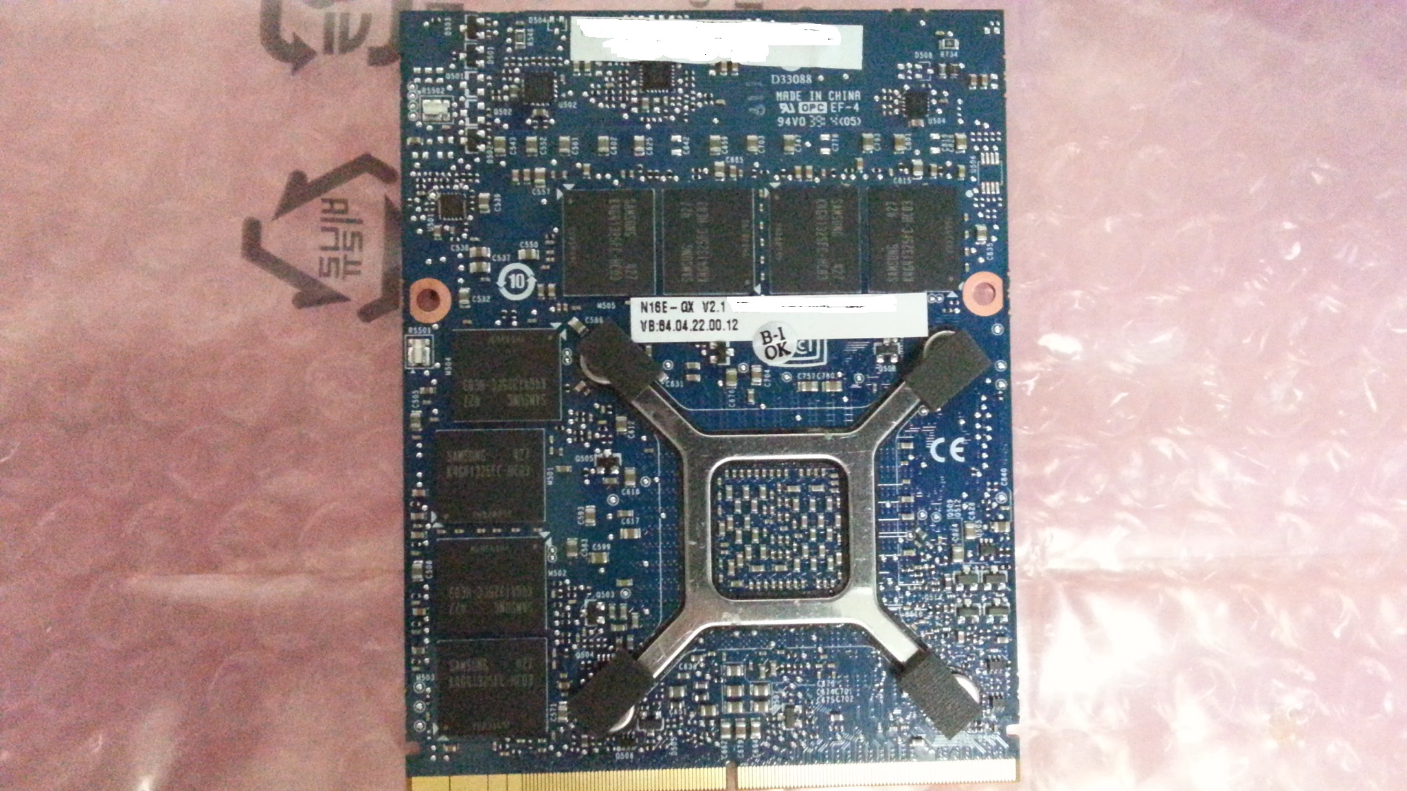

The X-bracket is different from dell vendor. So you need 4 screws that match the holes of the X-bracket.

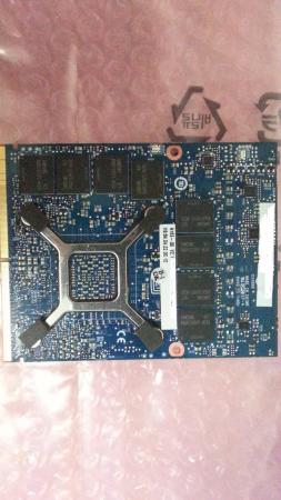

This is the bottom part of the GPU. It looks different.
You need to take off the black sponge to set this on alienware.
And an extra heatpad that can cover the memory.
The inner part of alienware heatsink and the GPU chips match very well. So we dont have to mod the heatsink of alienware m18x R2, m17x R4 and AW17.
