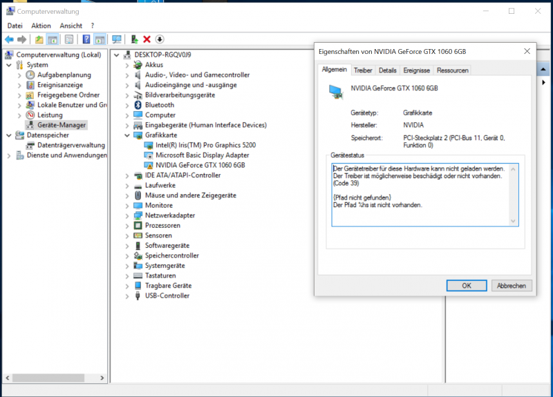

21 minutes ago, pixelvaganz said:
 That means after i'm starting up the card showed error 18, then comes the decice detecting, the shows 1 second no errors and then switch to error 43. I'll try the 372.70 driver. Thank you
Now i tried the 372.70 and this is the result:

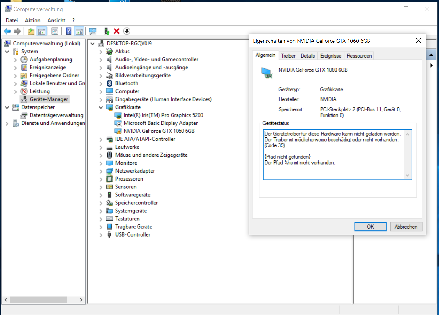

https://support.microsoft.com/en-au/kb/310123#bookmark-39
Quote
Code 39
Windows cannot load the device driver for this hardware. The driver may be corrupted or missing. (Code 39)
Cause
There are several causes of Code 39 errors:
  • A required device driver is missing.
  • A required binary file is corrupted.
  • There is a problem with the file I/O process.
  • A driver that is referencing an entry point in another binary file is unable to load.
Recommended resolution
Uninstall and reinstall the driver
Uninstall the driver from Device Manager, and then scan for new hardware to install the driver again.
  1. In the device's Properties dialog box, click the Driver tab, and then click Uninstall. Follow the instructions.
  2. Restart your computer.
  3. Open Device Manager, click Action, and then click Scan for hardware changes. Follow the instructions.
Note You may be prompted to provide the path of the driver. Windows may have the driver built-in, or may still have the driver files installed from the last time that you set up the device. However, sometimes, it will open the New Hardware Wizard which may ask for the driver. If you are asked for the driver and you do not have it, you can try to download the latest driver from the hardware vendor's website.
Now i'm getting the error 43 again. What am i doing wrong? I read a lot of threads and tried everything they explained... I had a GTX970 before and it was the same problem. Can it be caused by my PSU? But it is the second PSU and the lights of the Akitio seem to be right... I'm stumped...

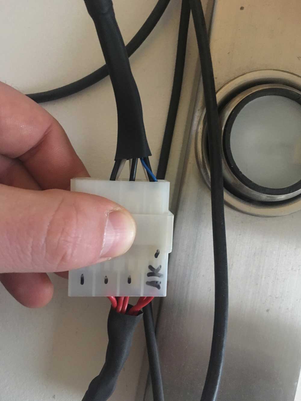

How are you triggering the external PSU?
The DA-2 requires 2 wires shorted to turn on.
Easy way to tell is green LED lighting up on it?
If green LED is dark, it isn't on.
"plugging it to socket" isn't a full answer.
Edited by MVC

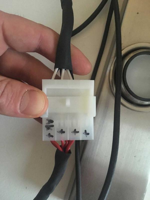

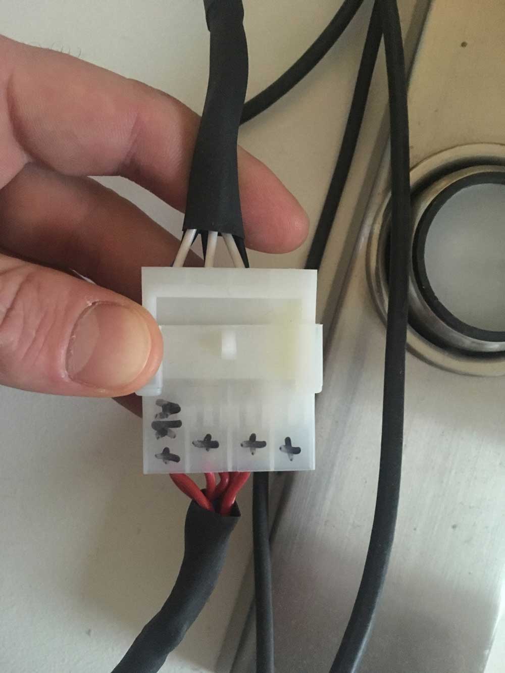

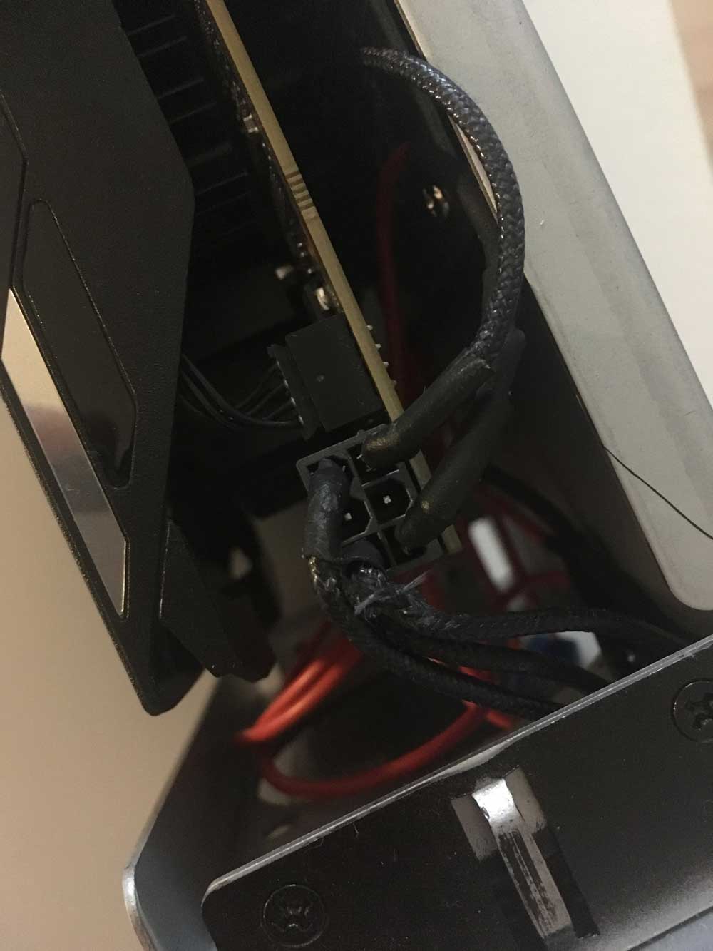

Sorry, my english isn't very well. I shorted two cables and Dell Da-2 shows green light. I only use the 3 white cables (for +), the 3 black (for -) and a blue cable (as remote). Please look at the pictures. AK+ and AK- on the plug are the slots for the Akitio. I used the blue cable for remote and putted it to the AK- together with one black cable. The slots with only + and - are for the Gpu. I only use 4 cables on the pci-e slot on the GPU as you can see on the third picture (two + and two -). These are the cables from the + and - at the plug.
