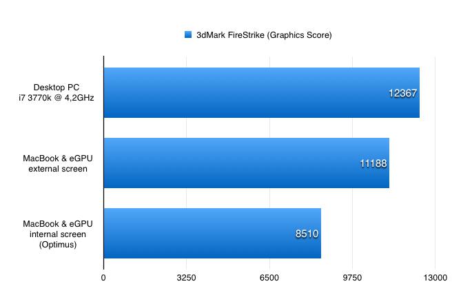

Expect a loss of performance if using the internal LCD for display since part of the TB bandwidth is sending display traffic. There is no such penalty if using a LCD attached to the eGPU.

Internal screen performance:
Performance loss will be sth like this with a GTX 970

Yeah, attaching an external LCD means no internal LCD traffic being used on the TB link.
Otherwise yours tweak fors improved internal LCD performance include (1) disable the NVidia audio to use your inbuilt soundcard audio instead to save precious bandwidth (2) run a lower resolution or color depth to reduce internal LCD traffic (3) apply a FPS limit using Rivatuner/EVGA Precision.
