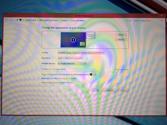

OK Time for a buch of help needed..
I have my eGPU up and running from a power and connection point of view but now I have no Idea what I need to do to get it to run.
It is an Akitio w/Galax GTX970 powered by a DA2
I am just looking to get it to run an external monitor set-up not needed to run the internal graphics.
Currently OS X Yosemite 10.10.3 is recognizes the Akitio (not sure if it should recognize the card at this point).
In Windows 7 64bit (it appeared to install all of the drivers for the PCIe bridge but notifies the Code 12 error on the MacBook.
I have a Macbook Pro 15" Mid 2015 with TB1 and the internal 650M Nvidia Chipset along with the IBM 4000
Any help would be greatly appreciated at this point, step by steps or otherwise to get the computer to recognize the eGPU in both OS X but Primarily In Windows 7 64bit
Thank you
Brion Sohn
Update: OK the eGPU is recognized through the Akitio in Windows 7 64bit with Code 12 as a Standard VGA Adaptor at the moment. So I am guessing that all I need to be able to do to get it to be recognized in Windows is to figure out how to reallocate the PCI resources to eliminate the Code 12 and then clean Install the NVIDIA Drivers so that it can run the GTX970 and also the GT650M as well.. Please correct me if I am wrong and there is a lot more to it.. Though that being said I am not sure how to go about Reallocation of the PCI Resourced with a Bootcamp load. As I mentioned earlier Getting it working in Windows is Primary..

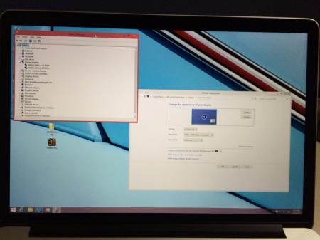

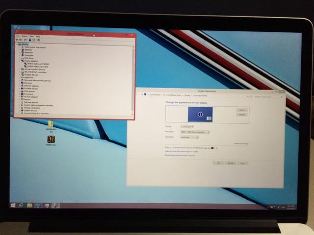

As for OS X I have been reading that the NVIDIA drivers for the GTX970 don't currently support Yosemite 10.10.3 so getting it to work right now in OS X Might be Futile even if I can get OS X to recognize it.. Though if anyone has any pointers or methods with this it would be greatly appreciated as well.
BTW I do plan on posting the build as soon as I am totally finished and get it running. I think I have the first fully contained GTX970 on here meaning that all all I have as far as seen parts are The Dell DA2 and the Akitio (which will be modified for airflow but will be closed and dimensionally standard. It a bit beautiful BUT Honestly it was a PITA to wire and did take all custom wiring and a special made board to hold the DA2 plug-in port and power switch Which are both on the rear of the Akitio.
More Update.. In Win 7 the Card is now fully recognized when attached and ON when Windows is opened through the BootCamp Launcher.. Drivers are good for the GTX970. Still getting the Code 12 but I really haven't attempted anything to get rid of it yet as I am not sure what the Best method is DTST Override, Setup, ???.. I am guessing that once the Code 12 is gone that things should work well as everything is up and running..
Still havent attempted the OS X Kext Mods to allow it to be recognized but part of that is I am having a hard time locating what exactly needs to be done.
