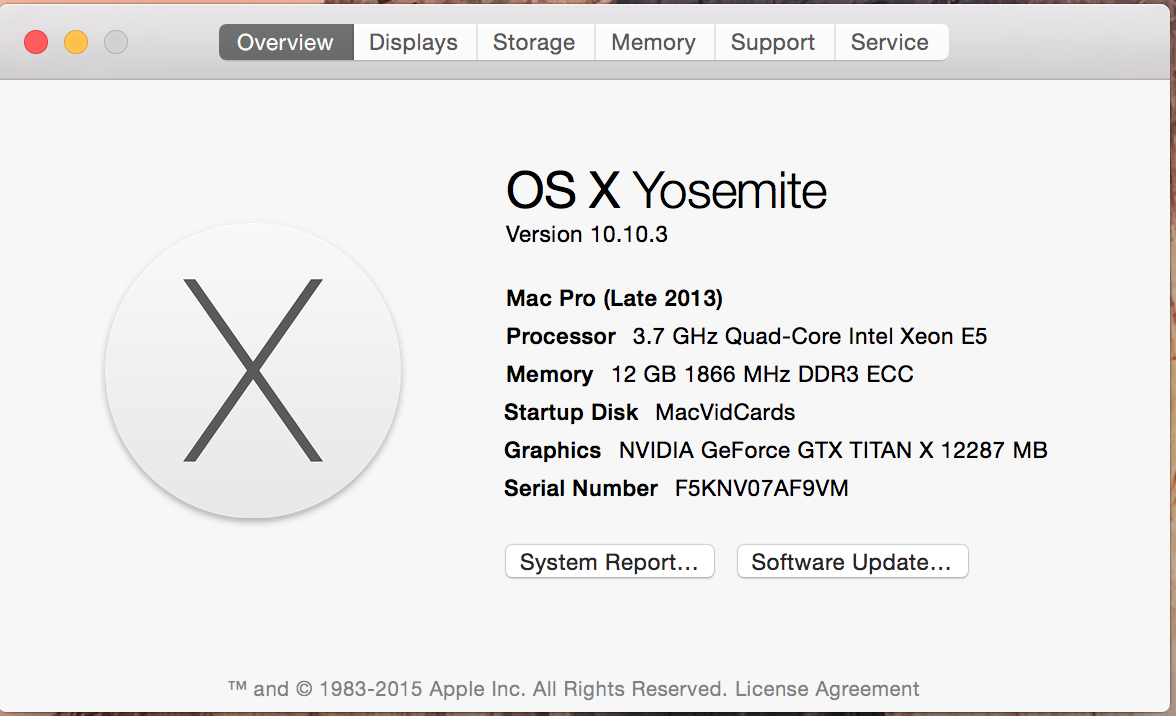

Pic or it didn't happen :chuncky:
I can and will post the pic.
I do have what I claimed to have.
So if I do....who will be the asshole then?

I just assumed if one had this big hardware-porn collection, one would automatically share the images with us :)
