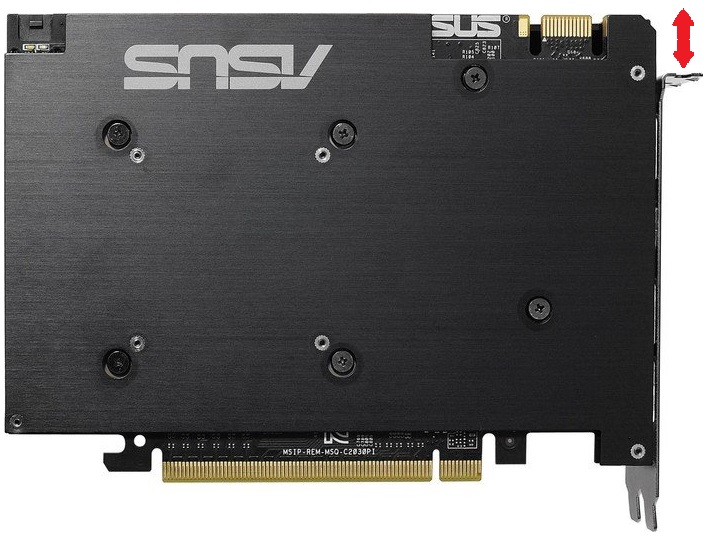

m1sk Posted May 20, 2015 Share Posted May 20, 2015 @m1sk: The MSI cards are very "big", so you will not be able to put it all into the AKiTiO itself or even think about closing the case! The PSU is crap, seriously get a 450-500W branded PSU.If you like it a little experimental you can buy a Dell DA-2 external PSU and follow this thread: http://forum.techinferno.com/enclosures-adapters/9426-220w-dell-da-2-ac-adapter-discussion.html So I should go for one the form factor cards? like this one: ASUS GTX960-MOC-2GD5 GeForce GTX 960 2GB 128-Bit GDDR5 PCI Express 3.0 HDCP Ready SLI Support Video Card - Newegg.com And what do you say about this PSU: http://www.amazon.com/Corsair-Builder-EPS%C2%A080-certified-Power/dp/B0092ML1SC/ref=sr_1_2?ie=UTF8&qid=1432140092&sr=8-2&keywords=Corsair+450W I'm still considering where to my stuff since my country has high import tax And I wanna check option that I could buy locally... Thanks a lot! Quote Link to comment Share on other sites More sharing options...
Tech Inferno Fan Posted May 20, 2015 Share Posted May 20, 2015 So I should go for one the form factor cards? like this one: ASUS GTX960-MOC-2GD5 GeForce GTX 960 2GB 128-Bit GDDR5 PCI Express 3.0 HDCP Ready SLI Support Video Card - Newegg.comAnd what do you say about this PSU: http://www.amazon.com/Corsair-Builder-EPS%C2%A080-certified-Power/dp/B0092ML1SC/ref=sr_1_2?ie=UTF8&qid=1432140092&sr=8-2&keywords=Corsair+450W I'm still considering where to my stuff since my country has high import tax And I wanna check option that I could buy locally... Thanks a lot! Please read about GTX970 card sizing at http://forum.techinferno.com/enclosures-adapters/7205-us%24189-akitio-thunder2-pcie-box-16gbps-tb2.html#post98210 . The GTX960 cards using the base board. So that single-fan ITX cards you've shortlisted will fit the AKiTiO chassis but be too tall to allow the outer cover to slide over it. Consider that link has are some other twin fan cards listed there that are shorter vertically but longer horizontally so the outer cover can be made to fit. eg: Galax, Zotac. I understand Galax/KFA2 is one of the cheaper options in Europe. There's been a great mini Galax GTX970 eGPU implementation by Dschijn at http://forum.techinferno.com/implementation-guides-apple/9821-2014-15-macbook-pro-iris-gtx970%4016gbps-tb2-akitio-thunder2-win8-1-%5Bdschijn-2%5D.html 2 Quote Link to comment Share on other sites More sharing options...
ba10s118 Posted May 20, 2015 Share Posted May 20, 2015 QuotePlease read about GTX970 card sizing at [URL]http://forum.techinferno.com/enclosures-adapters/7205-us%24189-akitio-thunder2-pcie-box-16gbps-tb2.html#post98210[/URL] . The GTX960 cards using the base board. So that single-fan ITX cards you've shortlisted will fit the AKiTiO chassis but be too tall to allow the outer cover to slide over it. Consider that link has are some other twin fan cards listed there that are shorter vertically but longer horizontally so the outer cover can be made to fit. eg: Galax, Zotac. I understand Galax/KFA2 is one of the cheaper options in Europe.There's been a great mini Galax GTX970 eGPU implementation by Dschijn at [URL]http://forum.techinferno.com/implementation-guides-apple/9821-2014-15-macbook-pro-iris-gtx970%4016gbps-tb2-akitio-thunder2-win8-1-%5Bdschijn-2%5D.html[/URL]Just bare in mind that the KFA2/Galaxy GTX 960 is longer than the 970 and MIGHT not fit! Source:GTX 970: Quote Standard Graphics Card Dimensions: Length 179 mm Height 111.2 mm Width 38.6 mm GTX 960:Quote Standard Graphics Card Dimensions: Length 193 mm Height 124.3 mm Width 41.5 mm As you can see, the Gtx 960 is for some reason a tad larger than the 970. 1 Quote Link to comment Share on other sites More sharing options...
Dschijn Posted May 20, 2015 Share Posted May 20, 2015 @m1sk: The PSU is fine, but the Asus card is to wide as well! 1 Quote Link to comment Share on other sites More sharing options...
Tech Inferno Fan Posted May 20, 2015 Share Posted May 20, 2015 Just bare in mind that the KFA2/Galaxy GTX 960 is longer than the 970 and MIGHT not fit! ...As you can see, the Gtx 960 is for some reason a tad larger than the 970.It's longer and taller. I can see they've got this unusually high heat pipe near the PCIe power connector. This card will also be problematic in fitting the outer AKiTiO cover over it. It's strange why GALAX made their "ITX" lower performing GTX960 bigger than their higher performing ITX GTX970. 1 Quote Link to comment Share on other sites More sharing options...
ba10s118 Posted May 20, 2015 Share Posted May 20, 2015 It's longer and taller. I can see they've got this unusually high heat pipe near the PCIe power connector. This card will also be problematic in fitting the outer AKiTiO cover over it. It's strange why GALAX made their "ITX" lower performing GTX960 bigger than their higher performing ITX GTX970.Exactly - you would expect that a larger TDP footprint would require larger cooler and case. On another note! My project has started out by soldering some heavy duty cable for the 12v rail. http://puu.sh/hUqoe/7aedbb624f.jpghttp://puu.sh/hUqqB/ad9b462e66.jpgI will start a building thread as soon as all the parts are here. Quote Link to comment Share on other sites More sharing options...
