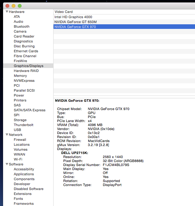

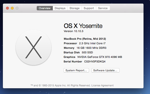

Well, to help out I busted out a GTX970 fro Zotac and fired it up with my 2012 rMBP
I started in clamshell mode, the internal screen isn't even showing up in proflier
So whatever issue you are having isn't with the 970 device id and/or the drivers

GTX 970 should not be a problem:
maxserve blog: (MacOSX 10.10.2 edition) How to recognize GPGPU via Thunderbolt external PCIe Box at MacOSX
