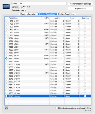

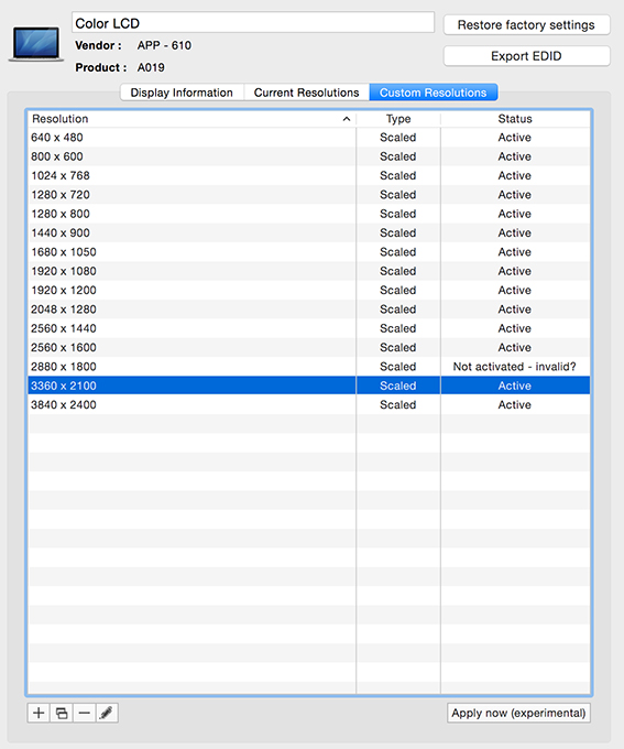

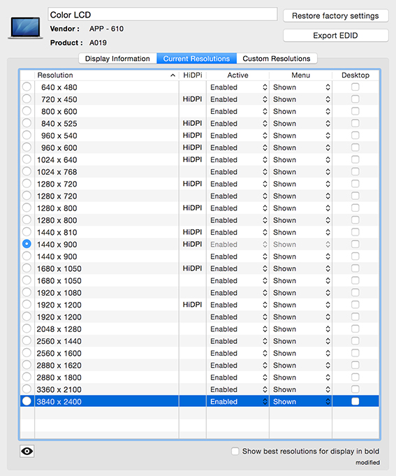

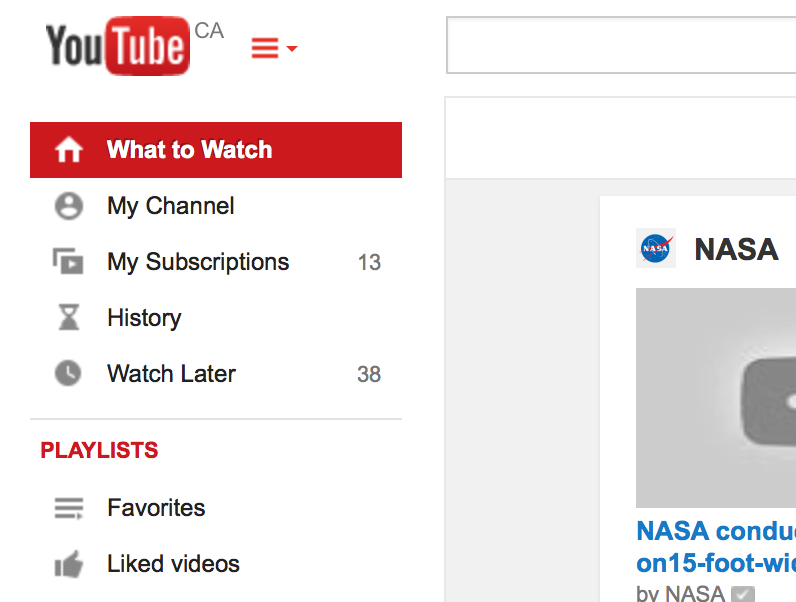

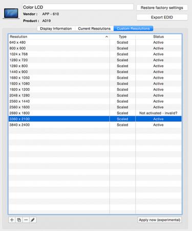

I noticed that after installing the Windows drivers for my eGPU on a 2014 rMPB with 750m, that both OS X and Windows have scaling issues. Please check out the weird "pixel blurring" on the attached images. These screenshots were captured at 2880x1800.
It seems like certain elements like text and varying web elements are upscaled at the wrong aspect ratio. This happens across Windows and OS X, which is driving me completely mad. I've tried restoring from different images, clearing the SMC and PRAM and yet the problem still persists.
Help!
EDIT: Here's a couple screenshots from within SwitchResX- does this EDID look screwed up?
