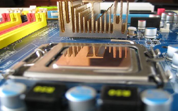

I would like to note that IC Diamond is classified/called a Flour in the business, below is an image of a IHS intentionally lapped with ICD - This can be accomplished with just about any thermal compound.
Another way to picture it - Most thermal compounds are approximately 600- 800 grit, so take some typical aluminum oxide 600 grit sand paper and Mount it between sink and IHS

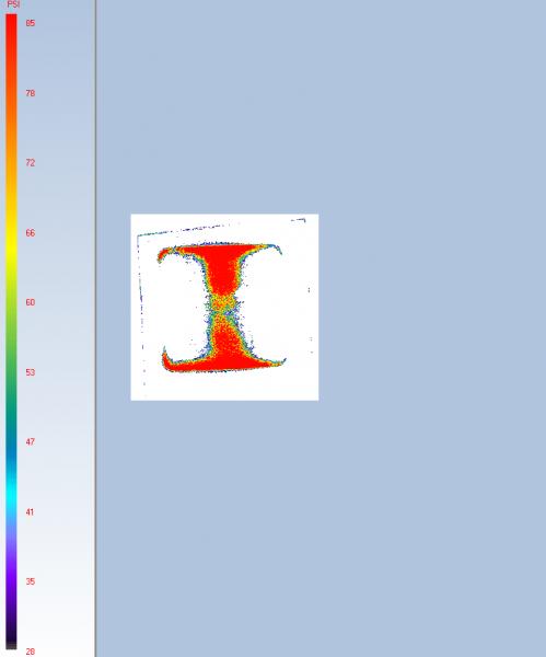

Generally 80% of all retail sinks have 50+ PSI contact pressure, if you have high spots with an irregular contour the high spots can have a PSI of 100 lbs (see picture)
now rotate the sink back and forth a few times under pressure it's going to leave a polished mark, so a general caution for any thermal compound but not ICD in particular.
Also note we are doing a video comparing an assortment of compounds and their polishing capability along with microscopic images of the results with enough detail to qualify as a professional analysis and alleviate any concerns people may have.

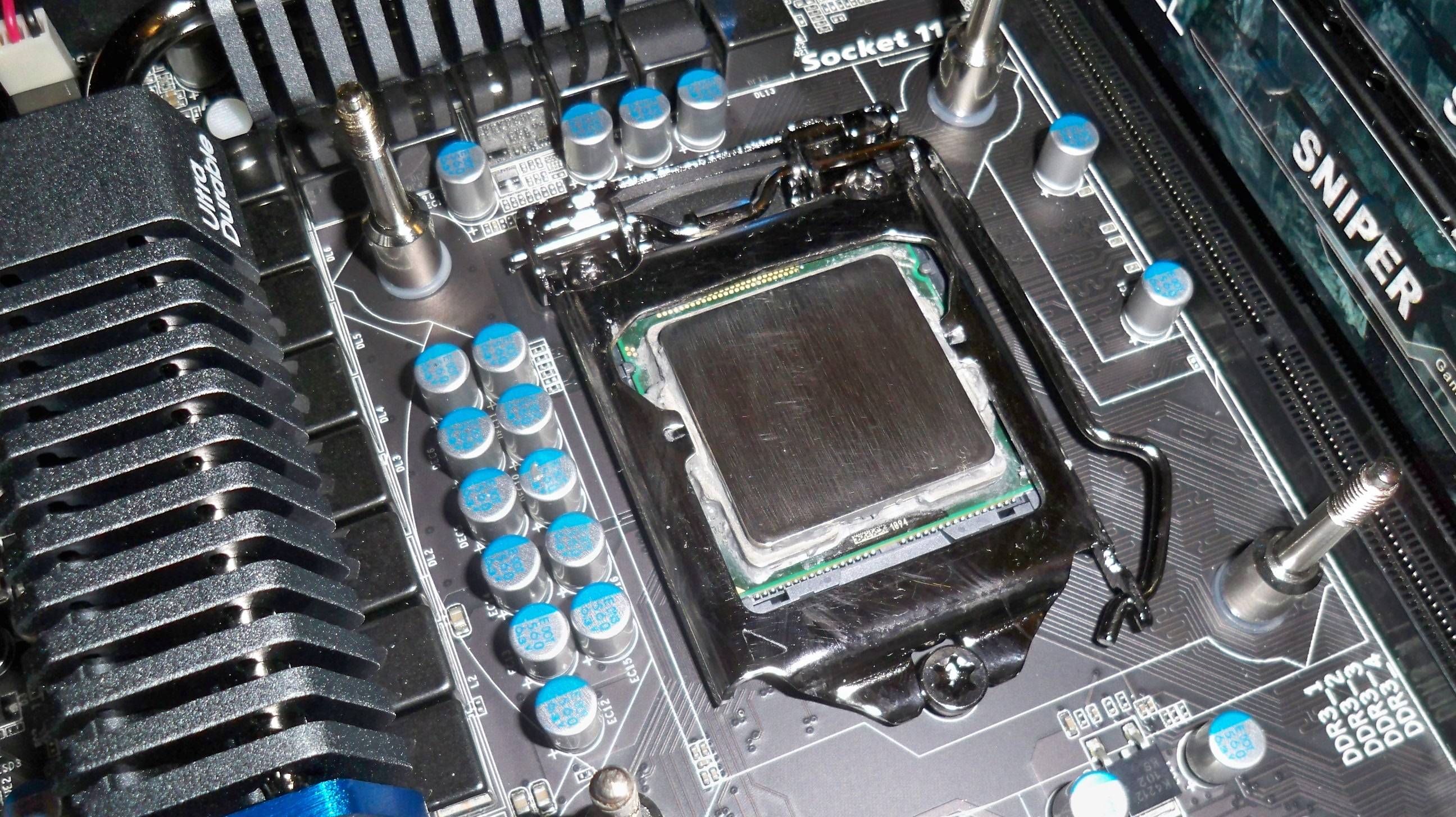

Here is one from overclock.net CPU IHS scratched, is this normal? - Overclock.net - Overclocking.net
The scratches shown here are claimed to be IC Diamond. It is physically impossible for ICD to have caused those scratches either the top to bottom sanded grain most likely from lapping or the random scratches. Any abrasives expert would testify the scratches could only have been produced from particle sizes 10X the size as what makes up ICD. Bottom picture is the result of concentrated lapping with ICD no large grain scratching in sight, go figure.
There are no "large" diamond chips in the compound we buy from one of the largest and most reputable US manufacturers, if you understand the process it is just not possible - it is like saying you have silver nuggets coming out of your tube of AS5.
Unfortunately a couple of hardware reviewers commented on it without much thought overlooking the fact that in the test series alone they did 25 mounts without mention of how many mounts were run in previous testing series which could have been 50? 100? 200? all on a micron thick laser etch? Basically it is a non issue, urban/internet myth, negative buzz marketing etc.
