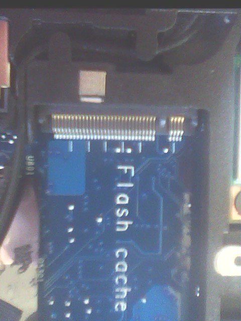

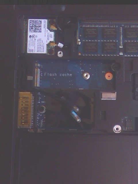

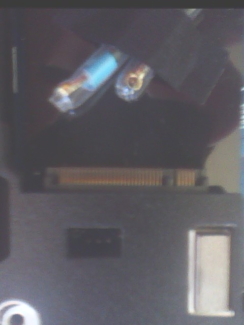

Am looking to setup an egpu on a HP elitebook 820 and would really like some help, am aware I am reposting some of this stuff, so will be last time.
The 820 has two M.2 ports, one for 'flask cache' / ssd the other for wwan and was wondering if it is possible it tell if either is pcie wired. @Tech Inferno Fan suggested trying wlan card in M.2 ports to see of it was registered, but have tried and unless there is something I a missing, or miss understanding, it will not fit, let alone the pins line up.
820 ports - mpcie, 'flash cache' M.2 and wwan(?) M.2
(sorry about picture quality)

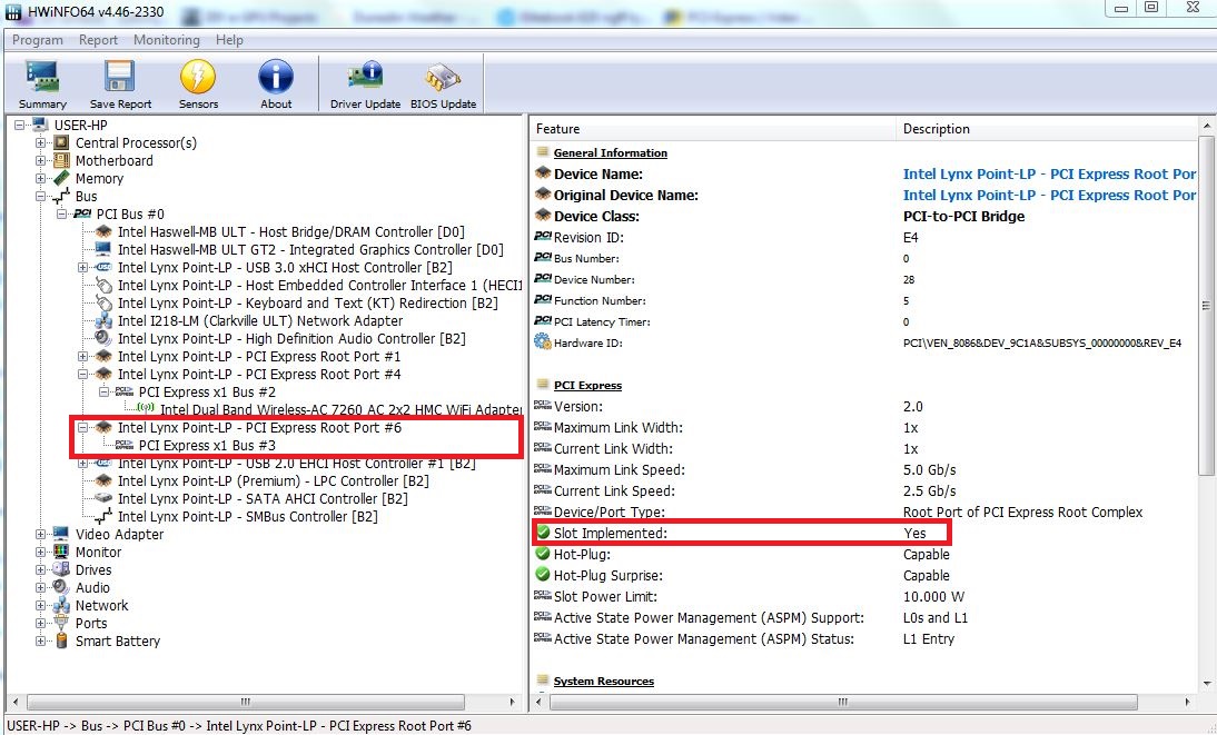

Also playing round in HWinfo64 and noted second pcie port with slot implemented, could it be M.2? or something else?
[ATTACH=CONFIG]12848[/ATTACH][ATTACH=CONFIG]12850[/ATTACH][ATTACH=CONFIG]12849[/ATTACH]
[ATTACH=CONFIG]12851[/ATTACH]

Port6 hosts the hidden Intel LAN adapter. In addition it's listed as a x1 width link, not x2 as you desire. I'm 95% sure that you have a SATA NGFF.M2 slot, which unfortunately makes it unsable for eGPU purposes. Which only then leads your mPCIe2 wifi slot which can be used to host a 4Gbps+c link using a NVidia card.

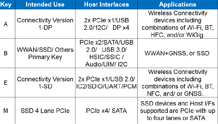

You can easily check what type you have and what it can.support. go on the wikipedia page for m.2 and they have pictures of all the key formats and what functions they have. Pretty sure most of the laptops out now have B key which has x2 pcie
Unfortunately not so. The 820 G1 has a 42mm SATA M.2 connector. From M.2 NGFF SSD Compatibility List | My Digital Discount.
42mm SATA M.2 NGFF (2242)
HP Chromebook 14
HP EliteBook: 820 G1, 840 G1, 850 G1
HP EliteBook Revolve: 810 G2
HP ProBook: 430 G1, 430 G2, 450 G2, 640 G1, 650 G1
HP ZBook 14
Furthermore, from the many PC notebooks with a M.2 connector, it's only the pricier Sony VAIO Pro 13 and just released HP ZBook 15/17 G2 that have it in x2/x4 PCIe form at this time. Most PC notebooks are using SATA lines to the connector making it unusable for eGPU purposes.

Actually looking at the chart again all currently used keys are electrically pcie 2x. So there is a high probability that it would work. If you end up having a slot that is not A. I can make adapters for M B and E. I have the m.2 spec for my m.2 daughterboard so it wouldn't be too much trouble to make an x4 cable. Though I'd have to force output into multiple cables for use on pe4c, I'm developing one with minidp but its in the pipeline for after I mass produce my main board.
