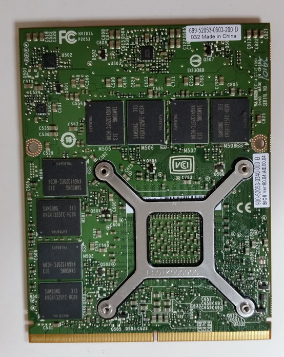

EDIT: Seller sent me photo of card: Label says that VBIOS HP K5100M is: 80.04.AE.00.04
I received Quadro K5100M intented for HP notebook. VBIOS is : 80.04.AE.00.04.
Tested with CLEVO P570WM and is not working, notebook don't boot and black screen only (boot loop). Tried also in P170SM-A and same problem.
svl7 do you have any other VBIOS which could properly run this card in any CLEVO notebook ? Thank you in advance.

Yes already my card is working in CLEVO P370SM and P570WM , I didn't checked in P17X0SM.
VBIOS change did a work, try: stock CLEVO K5100M VBIOS. What I heard that K5100M can make some problems to run it properly on P1X0SM series. My card has 8GB GDDR5 of memory. It runs very good without any modding drivers.
CLEVOK5100M.zip
YES the vBIOS Lightning posted above will work just fine (IRC we tested it together a while back)...
(HP cards expect another vBIOS in sBIOS, thus they are useless on their stock HP vBIOS in other systems.)
