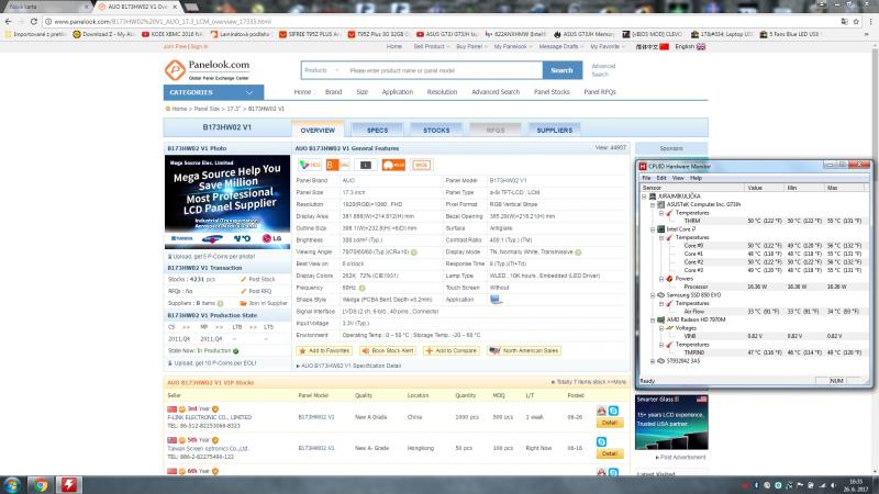

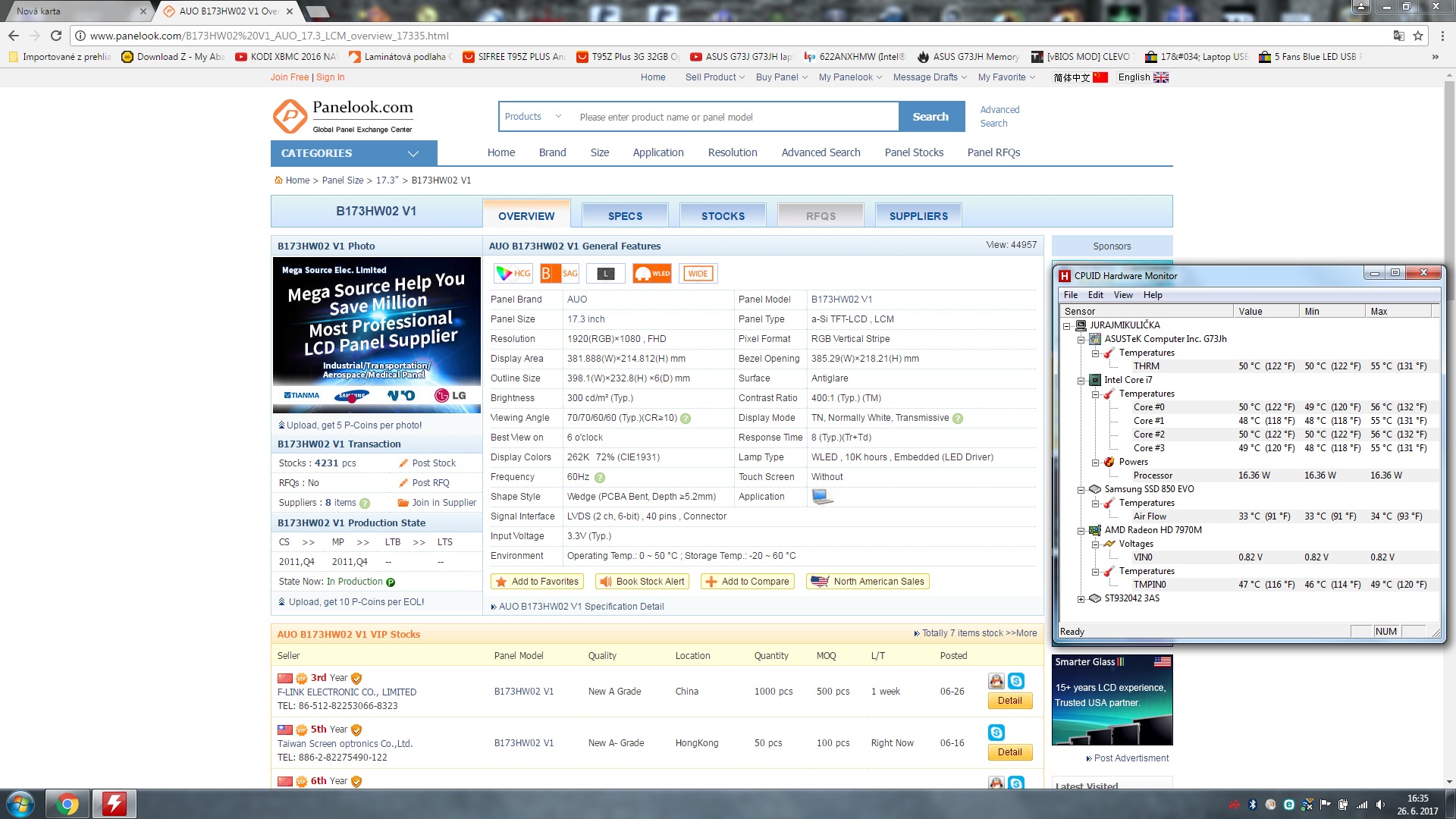

Hi, cclecle2000
great job man :-). Your max CPU clock is unbelievable ;-). I have my NB still at home and I am running my 7970M Clevo on 0.975V. It has more advantages. Incredible silent notebook, temps and battery life is almost now 4 hours :P. My vents on NB are almost for all time off :-D. I did at the end LCD display upgrade also by this guide section 5c - http://forum.notebookreview.com/threads/ultimate-asus-g73jh-cpu-gpu-upgrade-guide-hybrid-heatsink-mod-soldering-desoldering-heatpipes-lapping-guide-more.763001/ or better video guide here >>>
I have this new LCD panel on my NB. Better resolution 1920x1080, endly antiglare surface and much better viewing angle ;)
Edited by MaIsNeR
