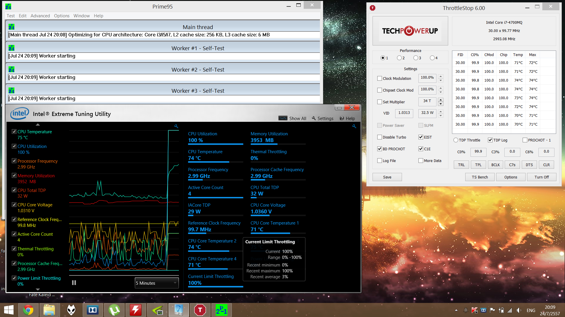

My Y510p i7-4700mq won't run at max frequency when stress using Prime95.
I have my i7 undervolted by -80mv voltage offset using XTU.
Multipliers are set to 34x 33x 32x 32x for 1 2 3 and 4 active cores.
But when running prime95 CPU max at 2.99GHz when it should max at 3.2GHz.
XTU show 100% CPU Current Limit Throttling but cpu has only use around 32-34 Watt only while it should throttle at 47watt tdp and it also hasn't reached temp limit yet as shown in the screenshot.
So can anyone tell me what's wrong with my system?
Looks like you're running into the current limit. Apparently, Haswell is really restricted in this regard compared to Ivy Bridge. Can you increase the TDC limit in ThrottleStop or XTU? What about in BIOS (if unlocked)?

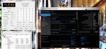

Yesterday I tried meddling with the settings and CPU overclocking. With p95 28.5 (and Intel XTU Benchmark) I always run either into current limit throttling (strange how - its should be huge 85A) or with higher voltage into thermal one. So Took Prime 95 v26.6 without AVX, disabled hyper threading. At 3.3-3.4 Ghz, from -50/-40 to -20/-10 mV corrections, I manage to run the test and stay at 80-90C (28C room temperature). But it was stable and no throttling (do not remember exact undervoltage values). TS showed 44-48 watts or something like that. In fact, running all cores at 3.4ghz with 0 undervoltage and adding gpu-z test on top of it I always thermal throttle (even on stock clocks on GPU, but -100mV undervoltage; probably because they are on the same fan and heat pipes connect altogether). So if nvidia GPU is used together with p95 test (meaning 100% load on CPU cores, ~80% on GPU, but no CPU AVX), still better cooling is needed. Or I lower cpu clocks to 3.1-3.2 in XTU, run gpu-z test at ~78C and get no CPU throttling too. All these numbers are what I remember, did not write them up on paper during tests, just wanted to re-code some videos with x264 so had to put CPU at 3.4Ghz constantly to encode and it ran fine (was not loading CPU cores 100% of course), so later on did some tests. Please note again my room temperature of 28C.

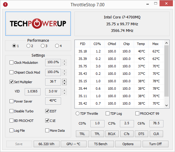

Are you using ThrottleStop? Post some screenshots when you have a question. imgur: the simple image sharer works great. You can do a CTRL+V and paste directly from Windows into imgur and upload pics quickly and then post a link in forums. If you want to post a screen shot of only CPU-Z or whatever app, click on the app, highlight it and then hold down the ALT key and push the PRINT SCREEN button on your keyboard. It's usually towards the top right on most keyboards. My Y510P shows PrtSc. Now when you go to imgur all you have to do is a CTRL+V to paste this image.

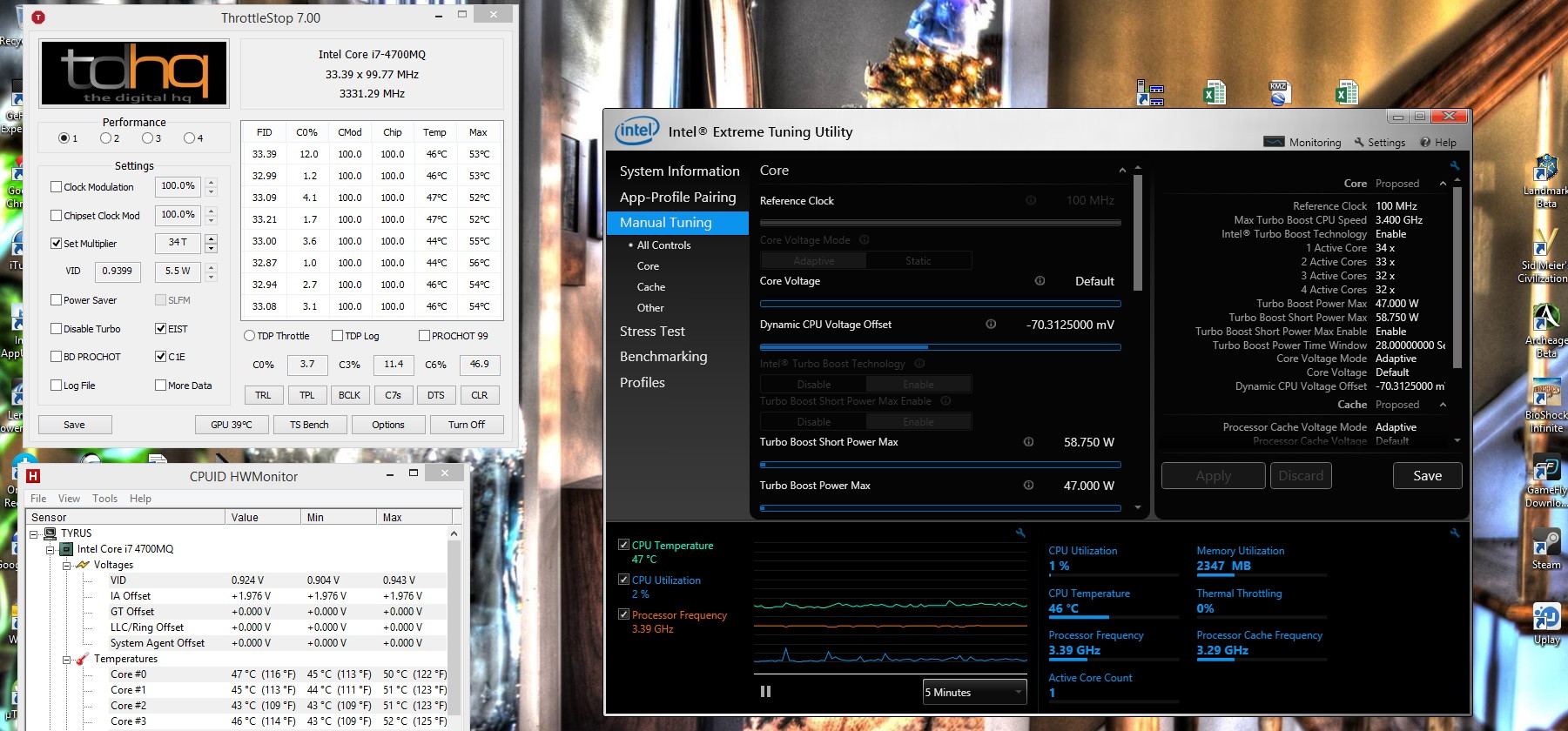

Hey Unclewebb. Appreciate all the work you do on Throttlestop. Also props to Allstone for the info. I have a Y510P with the I7 4700MQ. I'm trying to squeeze out some more performance for when Archeage goes live here in the US. So far I'm experimenting with undervolting a bit on it. ~70mv at the moment. I'm supplying a screenshot to help with my question. There are a lot of settings in both Intel's XTU and Throttlestop. What are your recommended Turbo ratio limits for all of the cores. I see from your screenshot you have 1 active core set to 36. What about 2, 3, and 4. Also, what do you guys recommend as far as the GPU's are concerned. It would be nice to put together a list of mods. Undervolt X amount, then Set turbo to W,X,Y and Z. I'm putting it all together from reading about 5 different boards. Maybe you guys with some more know-how could share some recommendations about how the throttling works and what we can do to get temps under control. I haven't used Prime95 in a few years...I'm guessing it's a lot more intensive than the Intel XTU stresser. I'm willing to strip it down and repaste everything. My last laptop was the Gateway P7805U....it looked like a frankenstein by the time I was done with all the mods to the cooling. Anyway, Given the relationship to GPU to CPU throttling, it looks like you can get away with just running Intel XTU for an undervolt and then TS to keep from throttling too far. Like you, I don't know the optimal settings though. Where should I park my turbo multipliers, and where and where am I going to hit a thermal wall once I start testing the GPU's in conjunction with my CPU settings? I've got the 750M x2 SLI setup. The mech 1gb drive until I find an SSD I want. I have no slot for the M.2 ....they decidd not to solder one on my board :(
Ok, theres a lot you can do. But first of all, please note that XTU and ThrottleStop does similar thing and running them together you might lead to unexpected results. Most notably, if you set something in XTU and then run TS, then TS might override some XTU settings. And vice versa. Also note that -70mV is good.. unless you set multipliers too low => or processor lowers voltage in some state and voltage gets to low => which leads to system crash usually because of lack of voltage. Modded BIOS might help with this - it can change for Windows to boot directly in Turbo-Performance state instead of non-turbo state which would allow lower voltages to be set and windows not to crash during boot.
