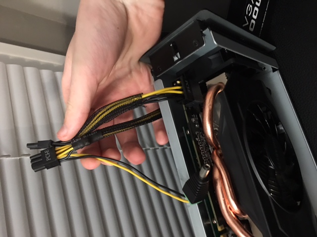

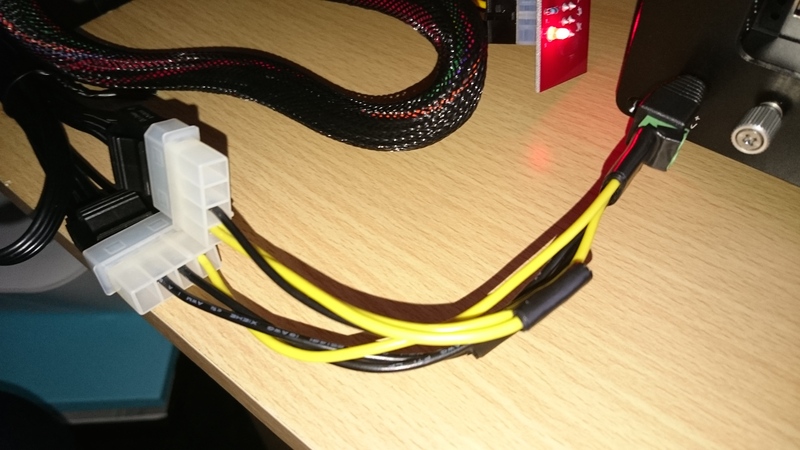

I got the 6+2 to fit but the problem is its on the same wire that has my power for the Akitio and the cable isn't long enough for both to be plugged in...its just one or the other. Is there some kind of extension I can order for the DC so it will reach the back of the Akitio?
6 minutes ago, Dschijn said:
I don't get your setup ^^
Yes there are extensions.
Here is what the cable looks like. Would it be safe to use those 2 wide 4 pin to 8 pin to power the GPU until I can get the extension to power the akitio with the 6+2 like you reccomended?
You make my heart bleed. Why did you rape the PCIe wires and used them for the barrel plug? :/
The plug currently plugged into the GPU might not work anymore.
You should have made the flat 4-Pin Molex to power the barrel plug and just use the 8-Pin PCIe plugs like they are intended for.

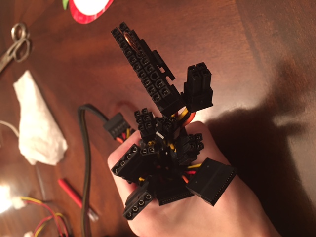

Could you make a picture with the whole PSU and all its cables left? Also the adapters.
Yeah I told you I'm new to this, I wasn't sure what wire to cut, I did't do the cutting, I brought it to an electrician dude and he told me those would be easy to cut and I told him to go for it. Should I just order another PSU and tell him to cut the correct wires? Or is this still salvageable...?
Well that is up to you… Fact is, there is sth. wrong in your setup. Hard to tell what.
You would need a 8-Pin PCIe plug for the GPU with all pins at use and the barrel plug. The easiest way would have been what we alwas preach: Get a extension or splitter cable to use for cutting. Cutting wires directly on the PSU is not good. Also the position where the cuts are, are hard to fix it again…

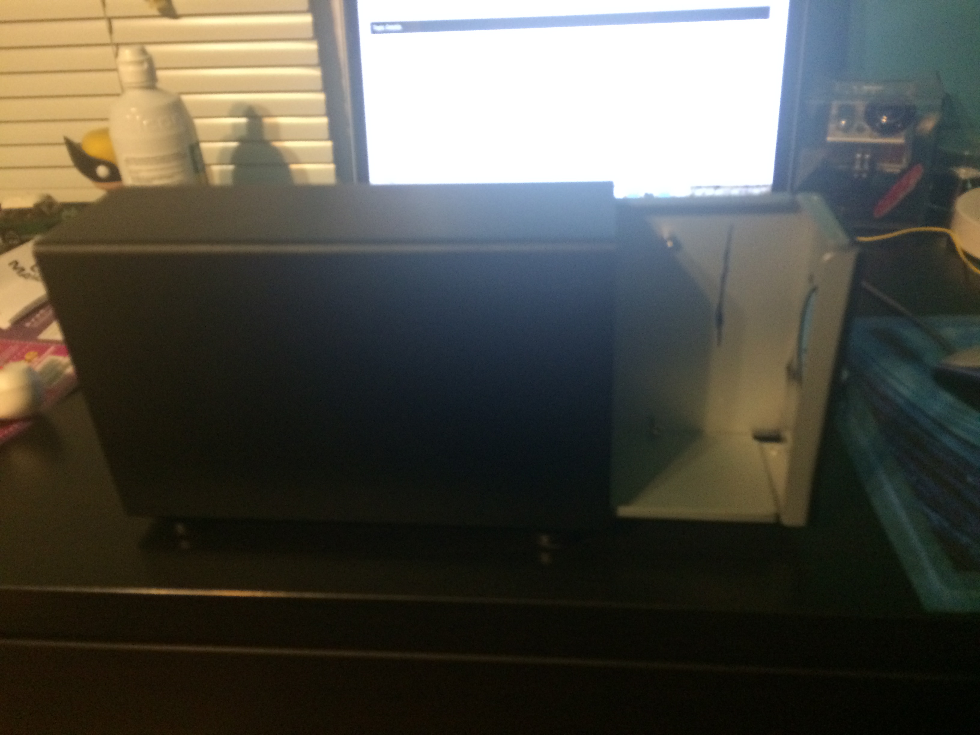

Hello everyone, I am in the event of extending my Akitio Chassis but I need your help. Does anyone have the shell of their chassis that they dont need or will never use. Some people like to take the boards out and just make their own case. But I would like to extend my case about 5-7 inches because I will be putting in the gtx 970 msi card in. I am willing to send paypal $ for your troubles. Let me know what you have.
Thanks

On 1/1/2016 at 11:19 AM, Enano said:
@Kr4nG Do you need inner or outer? I have the outer available if u want.
sure ill take the outer. wanna pm me or email me for more info. thanks

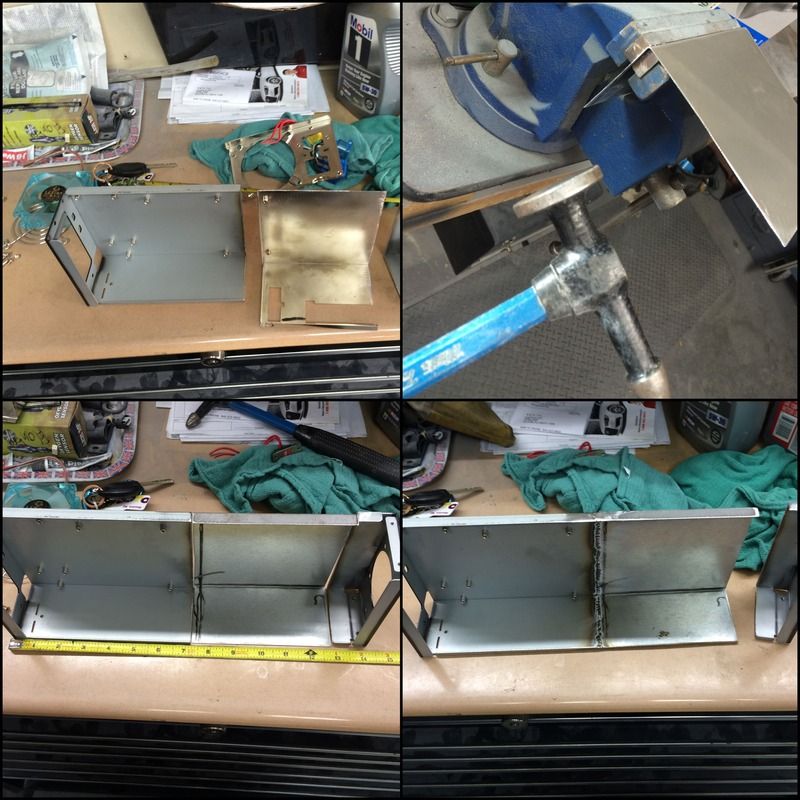

I have completed the extension of the inner shell. Im just waiting on paint to dry. I didnt feel like making it too pretty by doing body work but this is just cut, weld, grind, and hammer.
The first image is an old psu that i wanted to use. But the metal was to thin so i used it as a template first. Than i cut out another piece from an old dell case. The Inner shell is now 14 inches long and was extended by 5.5 inches. And yes that is my custom motorcycle and I built it too. I just need an extra outer shell.

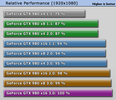

Speaking in terms of performance here.... TB2 we are able to get about what 80ish% of total power from Video card?  In TB3 we will get the whole performance of the card, is that a good assumption?  I wonder if ikitio or other companies will provide an "upgrade board" from TB2 to TB3.  Currently i have an XPS 13 with TB3 and a Macbook air and was hoping that CES would have an announcement for TB3 this first quarter but all signs are pointing to mid year.  Well guess its not over yet so who knows.... lol
Oh wow, looks like i under estimated the numbers a bit.  90ish % is plenty of power for a solution that will work on both the MacBook, and the XPS 13(with TB3 > TB2 adapter).  Should be good enough for the next year until more solid solution for TB 3 is put out at which point i should be able to use same adapter(assuming the adapter is bi directional as well) to upgrade and still use it on the MacBook.

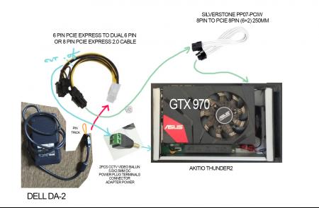

Hi
I just wanted to check with the more experienced guys on here that what I am doing will work.  I was intending on buying the pre made cable but it is no longer available so from reading on these forums, the setup on the attached image is what I plan to do.
Dell da-2(pin trick remote to ground) > PCIE 6 to dual 8 cable > 8 pin extension to reach the card > cut the other 6 pins attaching the yellows and blacks to positive and negative terminals of the barrel plug
Any guidance would be much appreciated.
Thanks
@CM In general you are right, just be aware that the ASUS card from the picture is too wide, you will not be able to close the AKiTiO.
The barrel plug is fine, if you can solder get one without the screw terminals.
