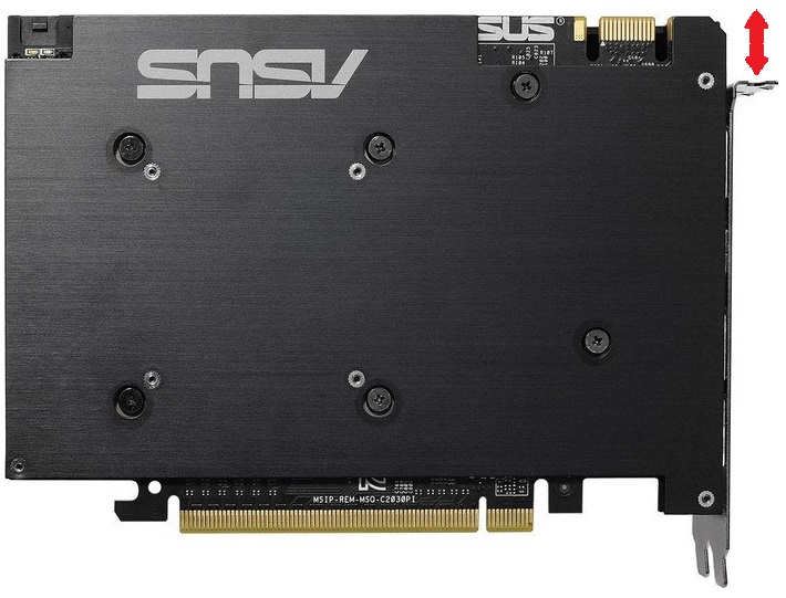

JoshS0515 Posted July 2, 2015 Share Posted July 2, 2015 Has anyone used the Asus GeForce GTX 970 DirectCU Mini in the Akitio Thunder? Amazon.com: ASUS Graphics Cards GTX970-DCMOC-4GD5: Computers & Accessories Quote Link to comment Share on other sites More sharing options...

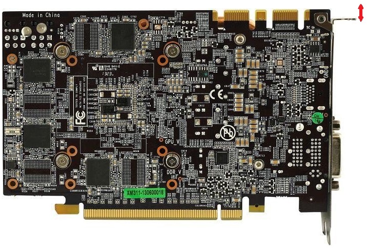

Dschijn Posted July 2, 2015 Share Posted July 2, 2015 Has anyone used the Asus GeForce GTX 970 DirectCU Mini in the Akitio Thunder? Amazon.com: ASUS Graphics Cards GTX970-DCMOC-4GD5: Computers & Accessories No, because it is too wide! Take a look. 1st card is the ASUS and the 2nd is the Galaxy/KFA2 card: Quote Link to comment Share on other sites More sharing options...
JoshS0515 Posted July 2, 2015 Share Posted July 2, 2015 No, because it is too wide! Take a look. 1st card is the ASUS and the 2nd is the Galaxy/KFA2 card: [ATTACH=CONFIG]15376[/ATTACH][ATTACH=CONFIG]15377[/ATTACH]Oh man! So the GTX 960 Mini is indeed the best graphics card to naturally fit into this casing without modifications?Also is there a reason why the hardware guide links the 2GB GTX for this casing instead of the 4GB? http://www.amazon.com/EVGA-Superclocked-Dual-Link-Graphics-04G-P4-3962-KR/dp/B00VX1MJQ8/ref=sr_1_3?ie=UTF8&qid=1435847829&sr=8-3&keywords=gtx+960+4gb Quote Link to comment Share on other sites More sharing options...
Dschijn Posted July 2, 2015 Share Posted July 2, 2015 Oh man! So the GTX 960 Mini is indeed the best graphics card to naturally fit into this casing without modifications?Best cards to fit are:- EVGA GTX 960 (the one fan version)- Galaxy / KFA2 GTX 970 Gamer OCalso short Zotac cards can fit without the fan shroud. Quote Link to comment Share on other sites More sharing options...
Tech Inferno Fan Posted July 2, 2015 Author Share Posted July 2, 2015 Has anyone used the Asus GeForce GTX 970 DirectCU Mini in the Akitio Thunder? Amazon.com: ASUS Graphics Cards GTX970-DCMOC-4GD5: Computers & Accessories It can fit the AKiTiO chassis without bending it, but the card itself is too tall to allow the AKiTiO outer cover to fit. Here you can see how my previous Asus GTX670 mini, of same dimension as the GTX970 mini, fits into the chassis. Best card to get to fit is the dual-fan KFA2/GALAX ITX GTX970. It can fit the chassis AND with low profile PCIe connectors allows the AKiTiO outer cover to fit. See some example implementations using a GALAX GTX970 at: http://forum.techinferno.com/implementation-guides-apple/10087-2014-13-mbp-gtx970%4016gbps-tb2-akitio-thunder2-win8-1-osx10-10-3-%5Bba10s118%5D.html#post134501 http://forum.techinferno.com/implementation-guides-apple/9074-2014-13-mbp-gtx970%4016gbps-tb2-akitio-thunder2-tb-display-win8-1-%5Bbenchallenger.html#post123518 http://forum.techinferno.com/implementation-guides-apple/8882-2014-13-macbook-pro-gtx970%4016gbps-tb2-akitio-thunder2-handle-win8-1-%5Bphantron.html#post121260 Quote Link to comment Share on other sites More sharing options...
