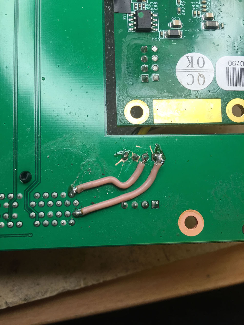

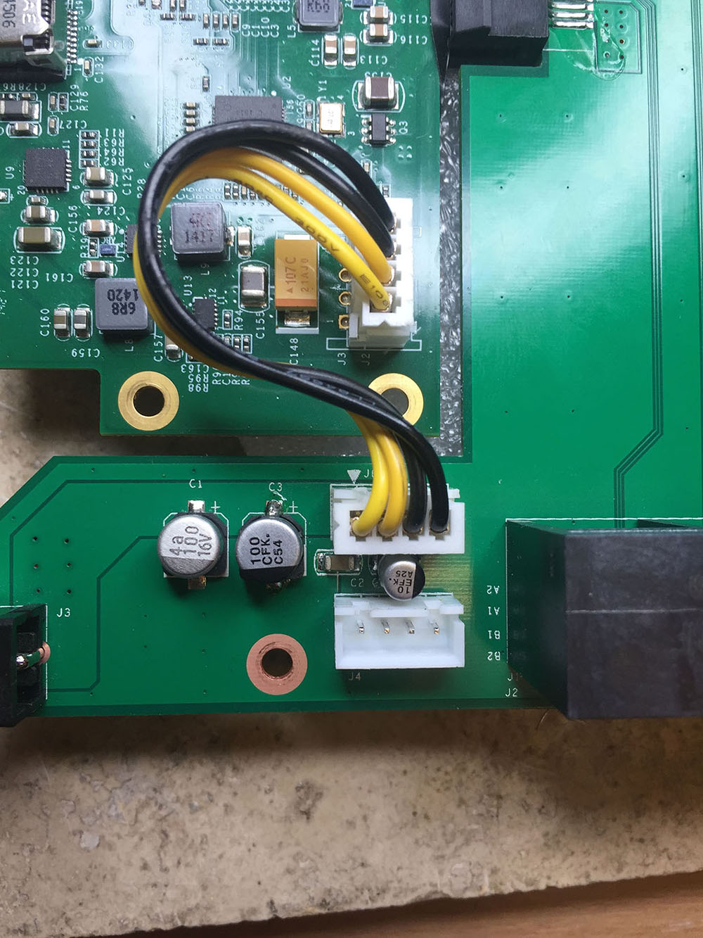

Here is the final mod done. Plugged the akitio PSU and it did not blow up.
Haven't tried to put the graphic card yet.
Here are some pictures, please comment because I had a really hard time removing solder for the 4pin connector. I hope it will be fine.
Did continuity test and looked fine. I have put a lot of glue gun over the scratched back after photos. Wish I had a spare graphic card to try first...
I did exactly like yours and my LED working, GPU fan blowing but can't be detected in DIY eGPU Setup. I then desolder it and use the same raiser with molex everything run fine again.
Mine was detected in mac osx peripherals. Haven't plugged the GPU yet. I need to disassemble my pc first...

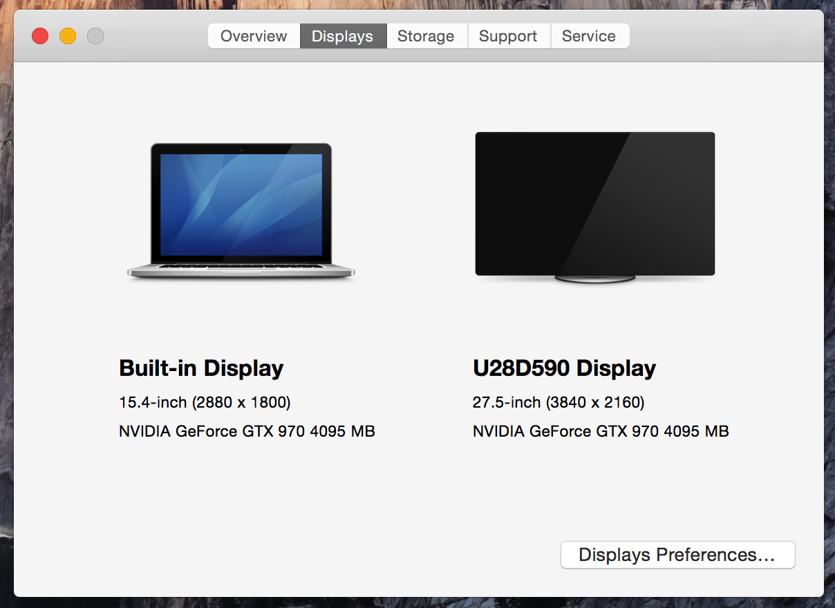

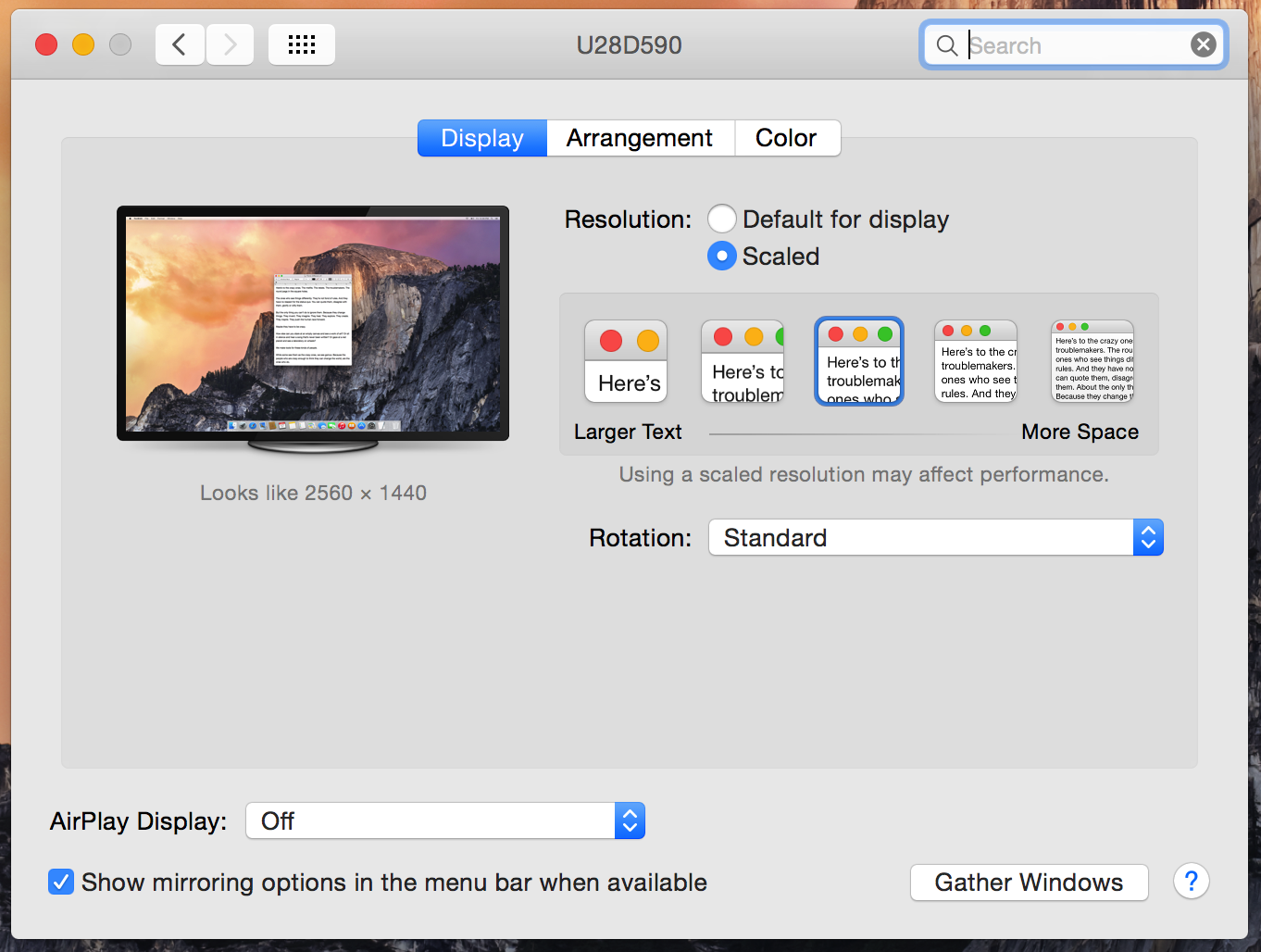

My laptop is 2013 late rMBP with 750m, it can recognize Zotac 970 and output to a monitor every time, and both OS X 10.10.3 and Win 8.1 works great. What I'm trying to do next is to purchase the Dell P2715Q 4k monitor.
Does anyone have tried a 4k monitor :beguiled: with eGPU?
@328115208, thanks. @MVC @goalque, can others test whether the SMC reset fixes the Maxwell/750m issues? It seems, initially, to have worked for me but I need to test more to confirm.
Incidentally, @328115208, I'm running a 4K display on my 970. Works like a charm, athough I'd suggest adjusting the scaling options up one notch because the OS X UI elements are a little too large for my tastes by default on a 4K display. See attached.

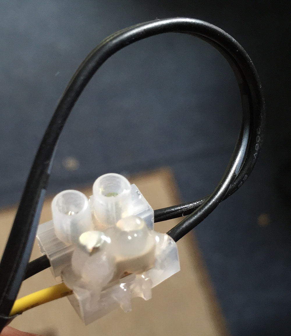

Hey,
So by putting my akitio back together after the mod in the hope of giving Egpu another try I noticed that my Molex to Barrell adaptor actually almost melted from my previous attempt (before the mod)
Funny enough only the "Domino joint" melted on the yellow side only.. Im really confused on why since nothing else did melt; cables and molex plug are fine. Some heavy current draw somehow ? bad idea to use this kind of jointer ?
I need to remake mine so any comments would be very much welcome.
Wow... good you saw that early enough. Maybe better use 2wires for yellow and 2wires for black on that joint with 4 rows each side.
